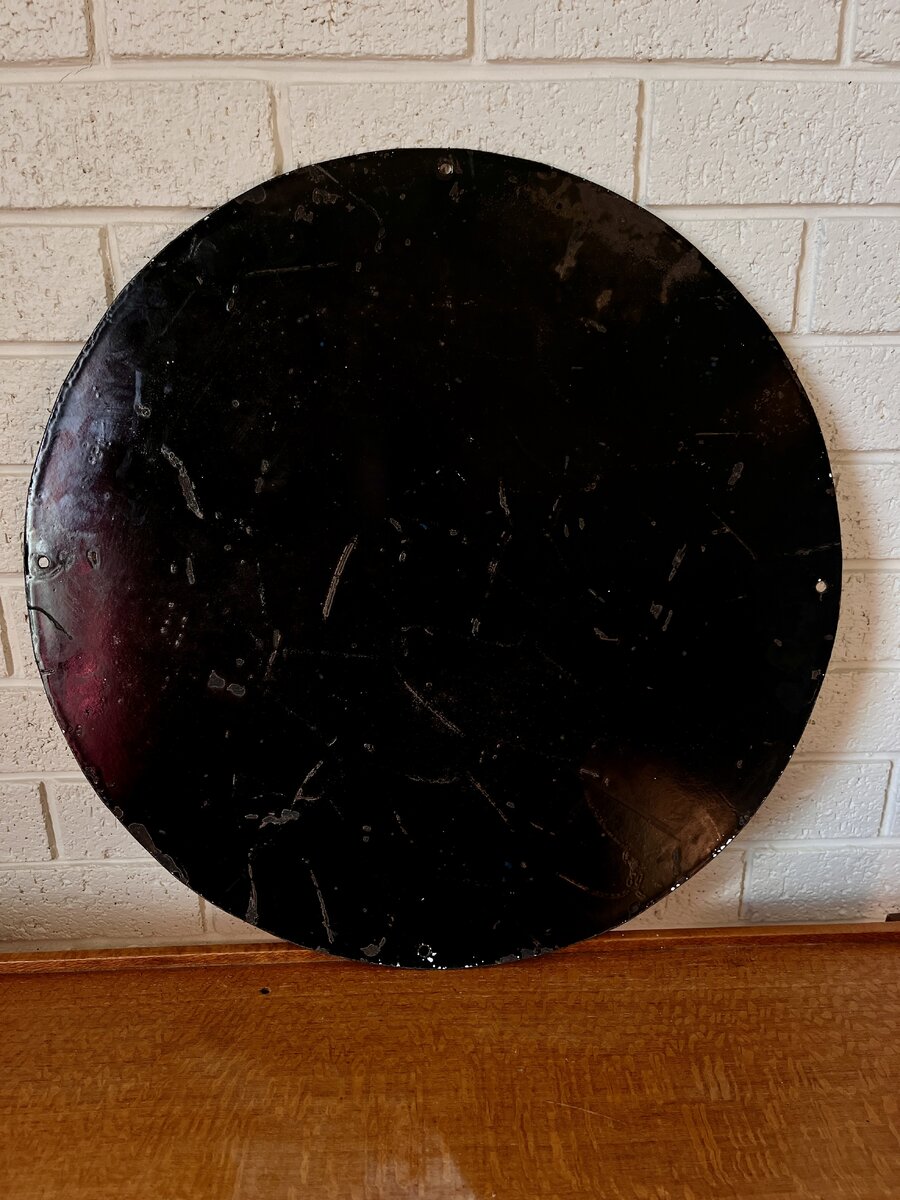

    I have just acquired this Petromax sign.
    It is heavy steel and ceramic; 56cm diameter with 4 fastening holes; and weighing about 2.20 kilograms.
    I don’t know much about this sign so any information would be greatly appreciated.

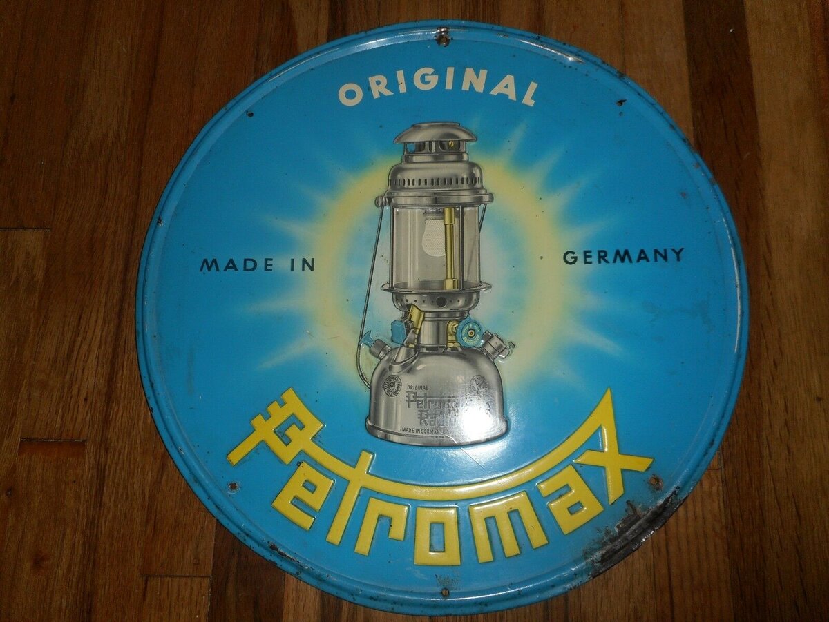

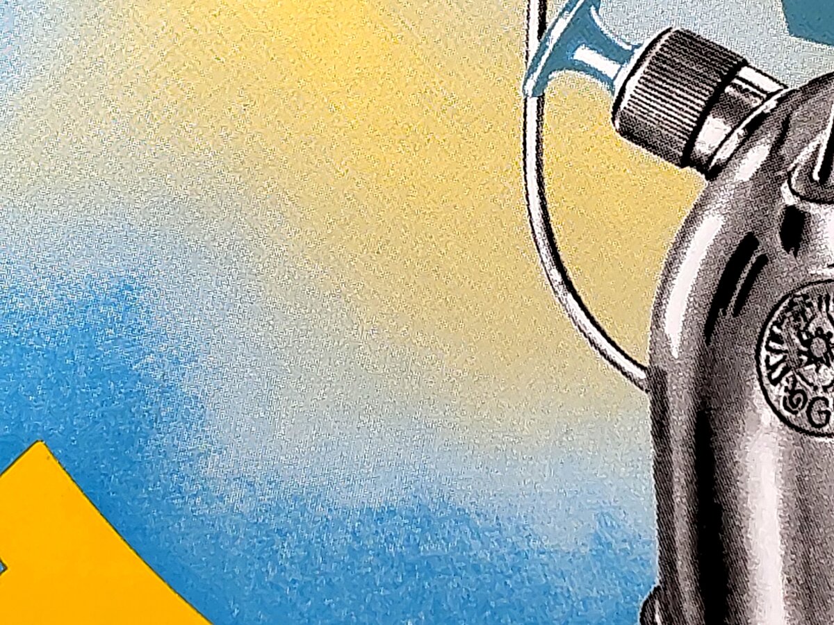

    This sign is a more recent replica! Unfortunately!!
    I downloaded a picture from an auction in the U.S. You can really see the difference there! If you zoom in a bit on the picture I sent, you can clearly see the ‘G’ in the logo on the lamp. The sign that was offered in the US must have been manufactured in Altena after 1953. In 1953, the logo changed from “EG” to just “G.”
    The quality of the sign from the US is completely different, and so is the font! That’s how you can spot fakes pretty quickly.
    Best regards,
    Jörg

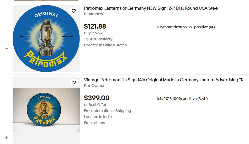

  6. Jörg Wekenmann
    Jul 11, 2021
    240
    Hi Tony,

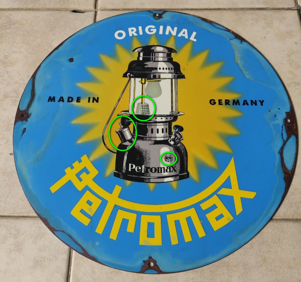

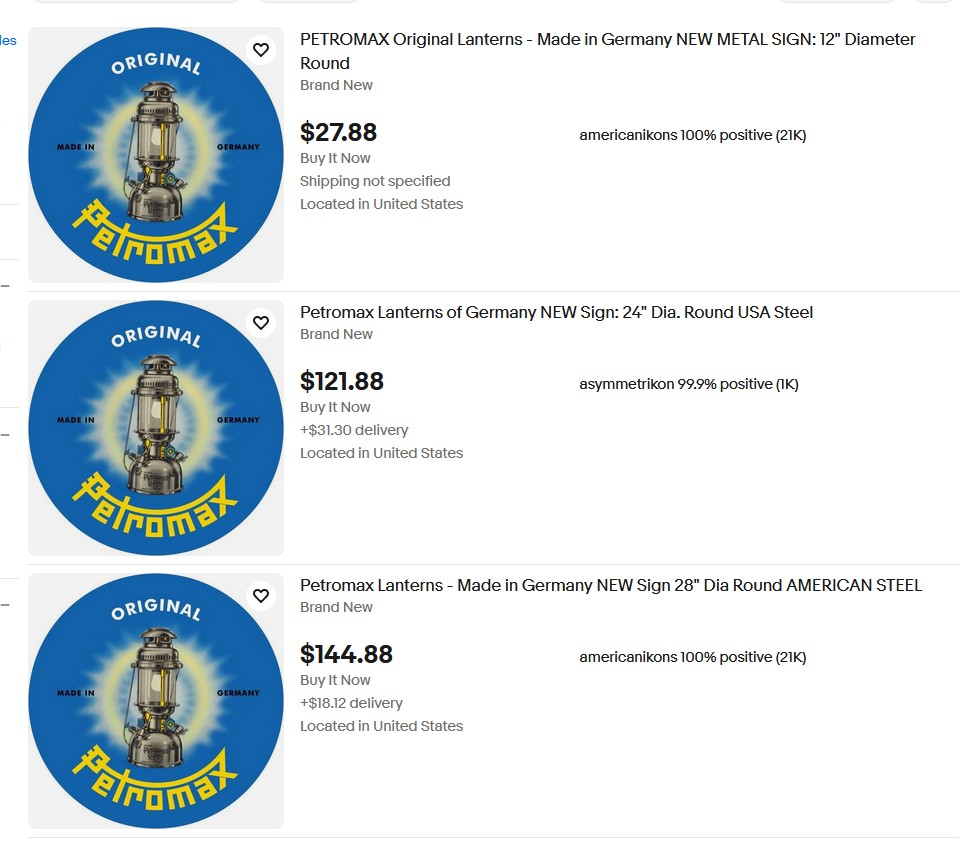

    this morning I was searching for Petromax advertising on Ebay and I found this:
    Kind regards
    Jörg
  7. Jörg Wekenmann
    Jul 11, 2021
    240
    After narrowing down my search a bit, I was able to find even more of these signs.
  8. Tony Press
    11,001
    Jörg
    Interesting that they are ?copies of an older design; and mine above is of a newer design.
    I’ll see if I can find out anything more from the seller.
    I’ll also see if I can work out how the different ceramic paints were layered.
  9. Tony Press
    11,001
    I have been told by the person from whom I received this sign, that he bought it from a Bendigo Swap Meet 6 or 7 years ago.

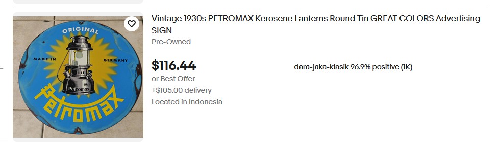

    Take a look at this lantern being sold in Indonesia.
    Someone really went overboard with this one!
    The logo on the lantern only includes the ‘G,’ so it was manufactured after 1953! The lantern itself, however, is a Petromax 824!
    Once again, the sun is stylized, and the lantern isn’t positioned exactly in the center like on the original, but slightly to the left of it.
    The “Made in Germany” text is also a modern computer font.
    Best regards,
    Jörg

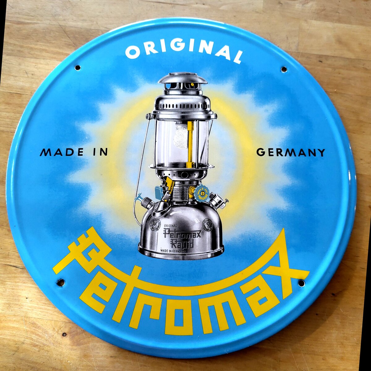

  13. Erik Leger
    Erik Leger Germany Subscriber
    496
    This is one of the reproduction signs Wim mentioned. It is heavy on enamel and was digitally printed on the metal disc.
    But this one was labeled and sold as a repro, not an old original.
    Erik
