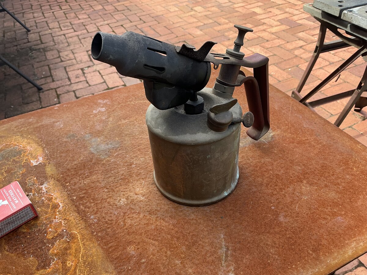

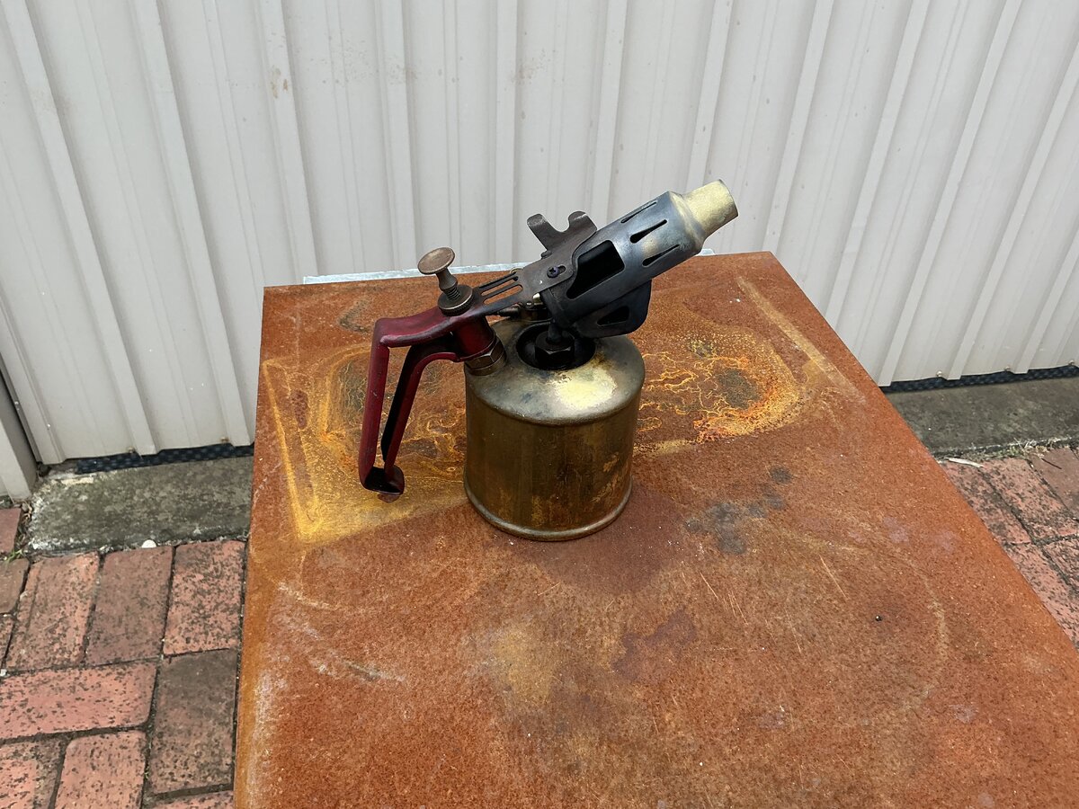

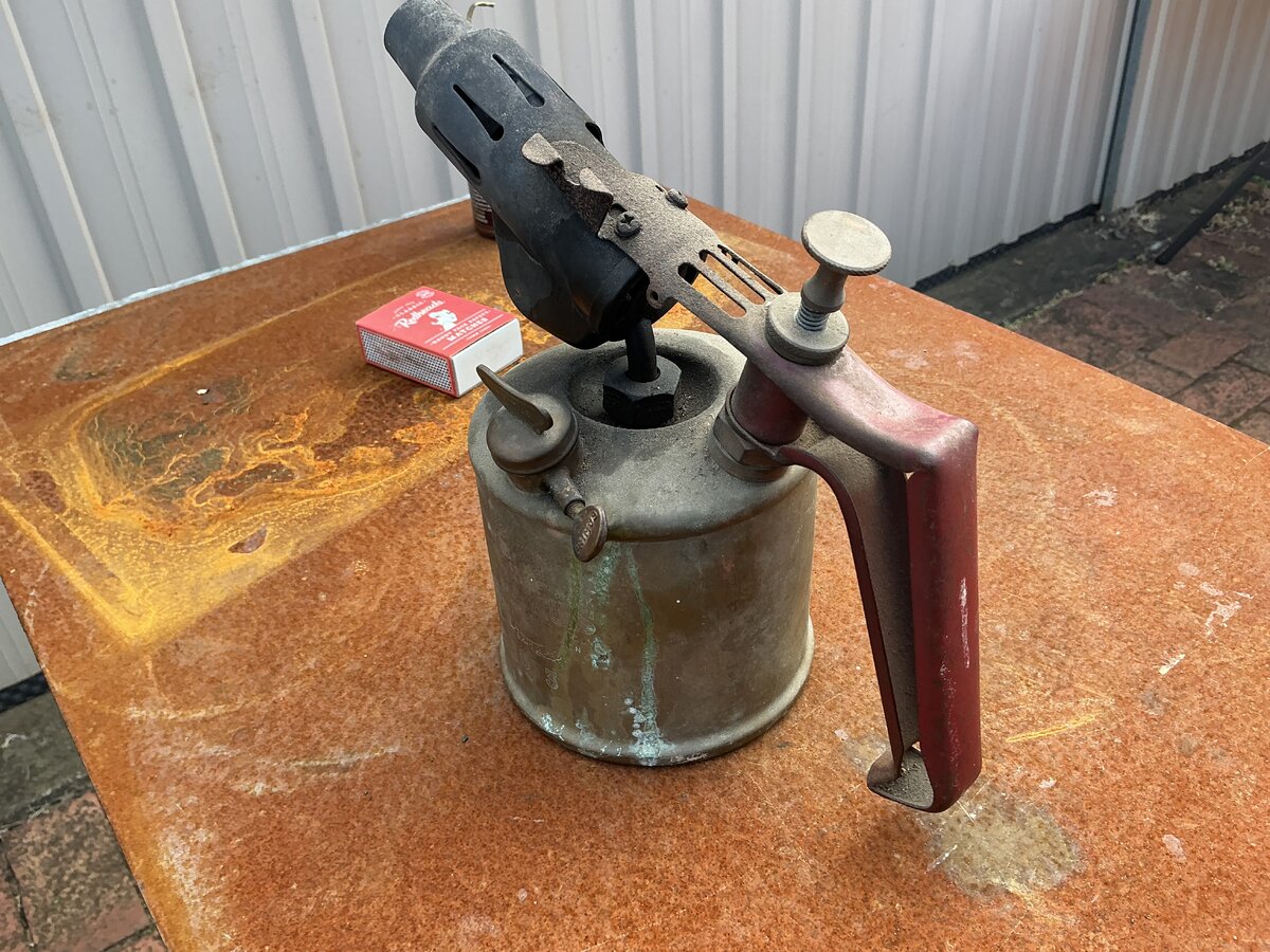

    I received and unexpected gift today. A blowtorch, which I know relatively nothing about
    IT has old gasoline in the tank. The pump works and tank holds pressure. Some gasoline squirted out of the nozzle.
    Can anyone tell me a little more about this blowtorch, and I am curious as to the metal bracket on the burner tube/guard.

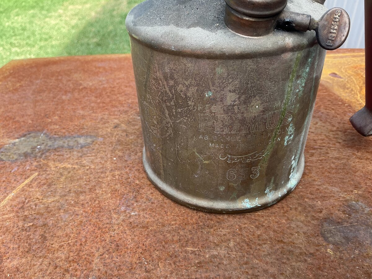

    This is a kerosene blow torch so I am surprised if someone has been using petrol in it. Very dangerous.
    The Primus 633 was around for a very long time. At least from the 1930s to the 1970s. It is a fairly common blow torch from Primus but the 632 with a smaller tank is the most common. Primus in general doesn't turn up that often in Australia though. This is one of the later versions, probably from the era after Optimus bought out Primus' kerosene products. If it is still from the Primus era it will have a date marking somewhere on the tank. Either a circle with letters and maybe a number or a six digit number stamped into the fille spout collar or the pump fitting collar. No date will mean it is most likely after 1962. It's probably not from the 1970s as I believe they had gone over to a sticker on the tank instead of the stamping by then.
    The bracket on top of the burner is to hold a soldering iron like the plumbers used way back when. The bulge in the shroud under the burner is the pre-heat cup. Otherwise it works just like most other pressure appliances. Pre-heat thoroughly and then start pumping.
