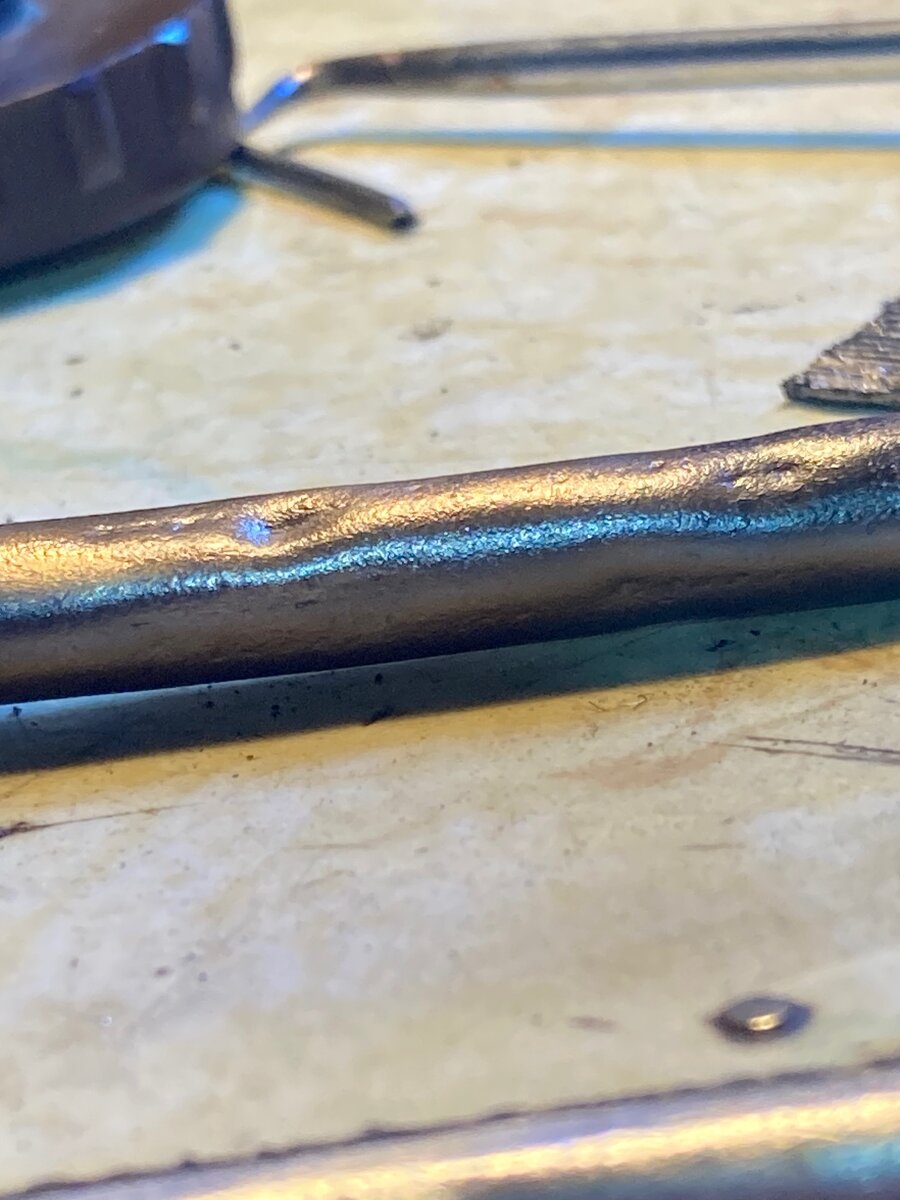

    My major problem is the original generator. It is obvious that some less than competent person tried to hold or tighten the generator using a needle nose or some such tool. This caused several issues. a very noticeable pinch point, a flat area about 3/4 of an inch, and a pretty noticeable bend. The bend i took care of almost perfect. The cleaning needle came out fine. However neither spring will budge. I would not be overly concerned but when I shot card cleaner and penetrating fluid in it major carbon came out. So I would like to do a proper cleaning of the springs.
    I have tied many things. Penetrating fluid, choke cleaner, dental picks and baling wire bent into a tiny hook.
    I am hoping that someone has an idea that maybe worked for them
