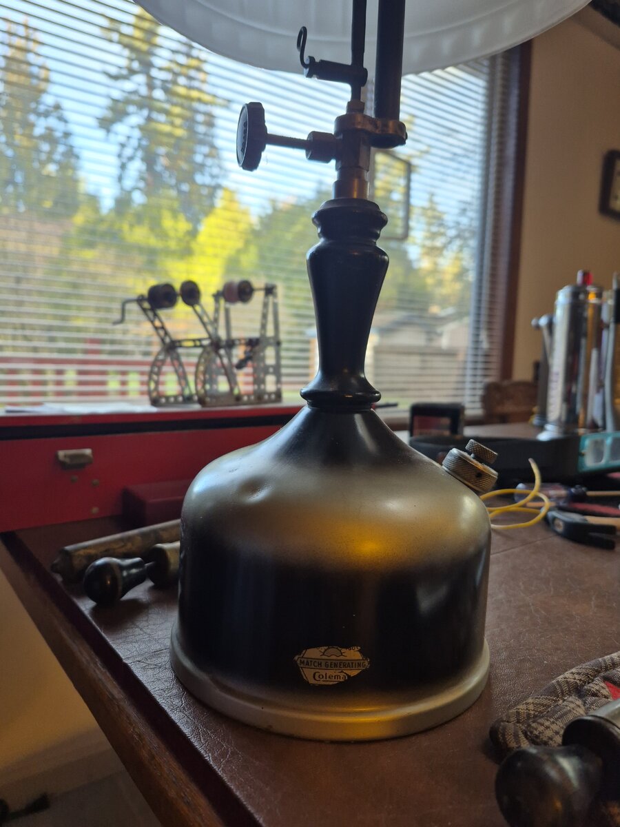

    What type/size packing is used for the tip cleaner and fuel valve on the older coleman table lamps? (sorry not sure of model)
    Thanks, 1000004444.jpg New to forum,

    Tip cleaner? I don’t see one integrated in the valve fuel assembly but the one in the generator you just have to buy a new R55 generator and for the valve packing ask Rob over OCP he might have what you need. Good luck

    David those r55 generators are hard to beat but if you have a leak through the cleaning lever try to tighten the nut and it should stop leaking. Other alternatives for that burner is q77 and q99
