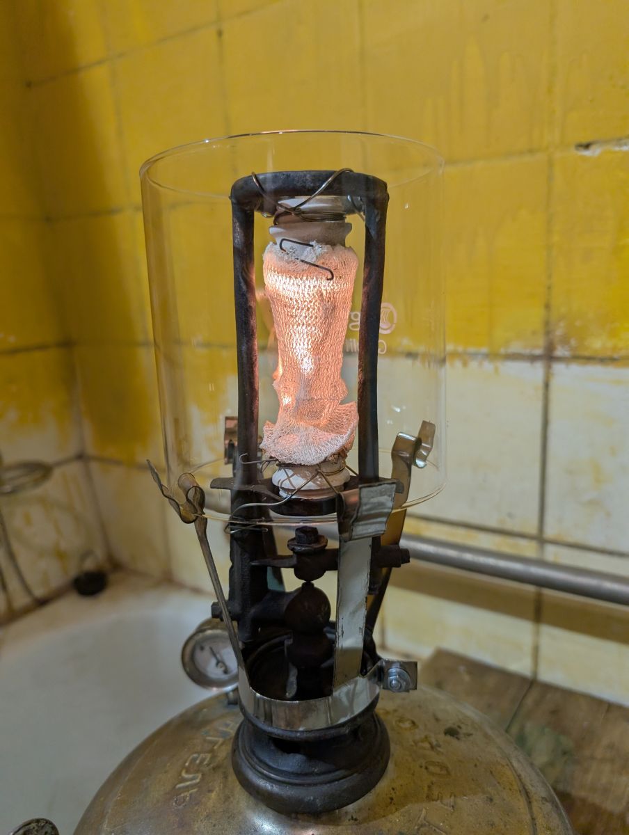

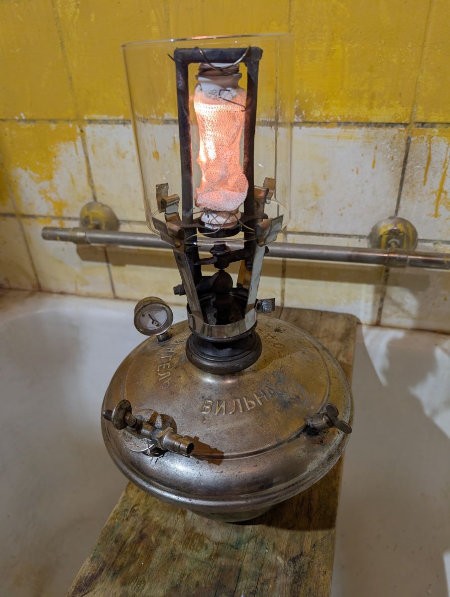

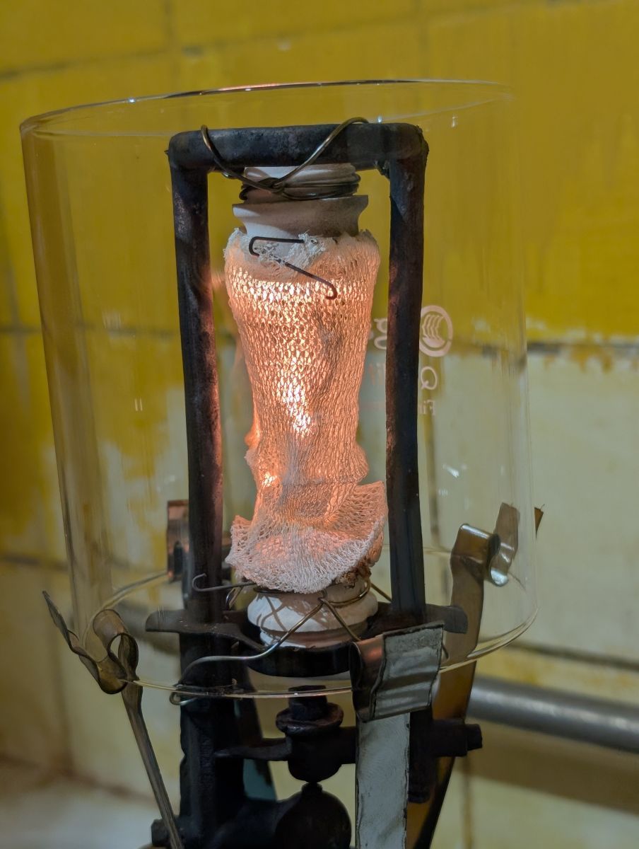

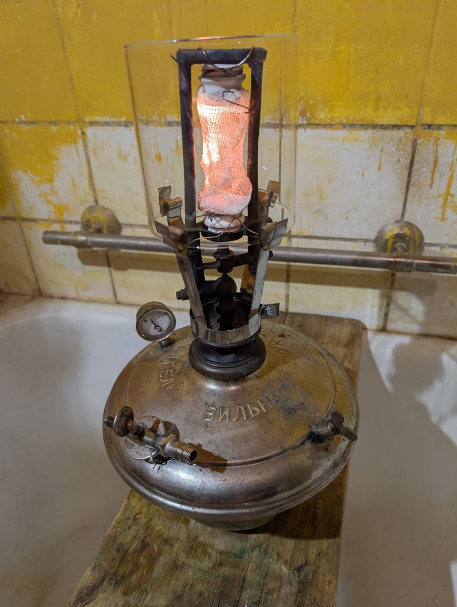

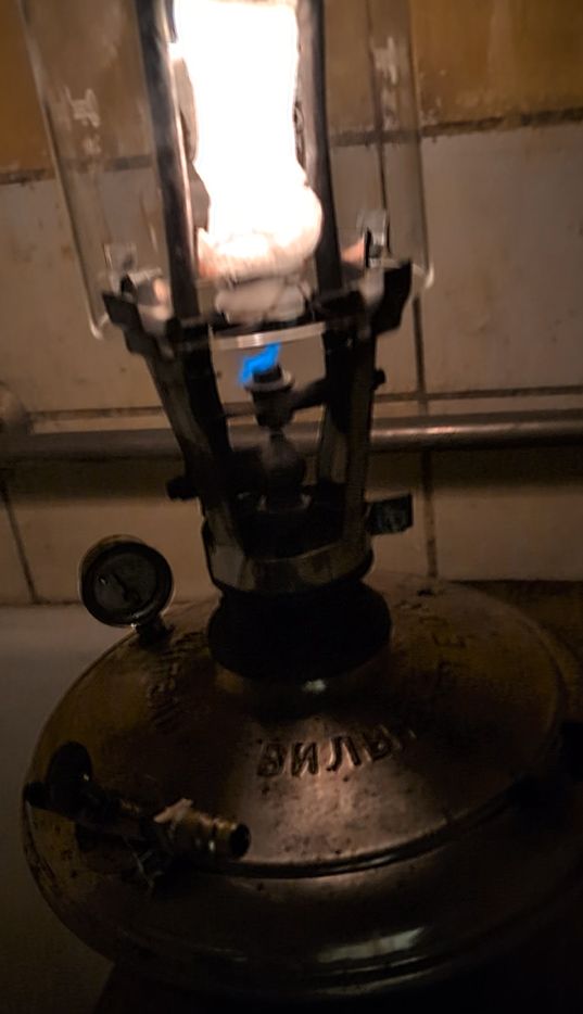

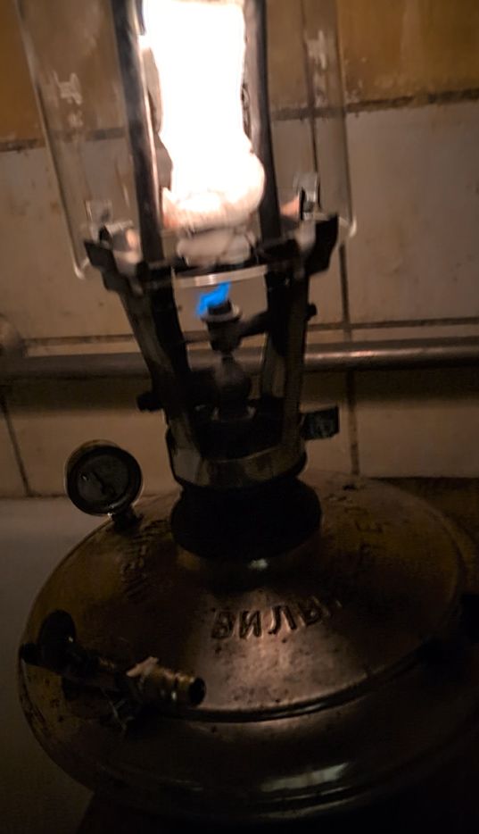

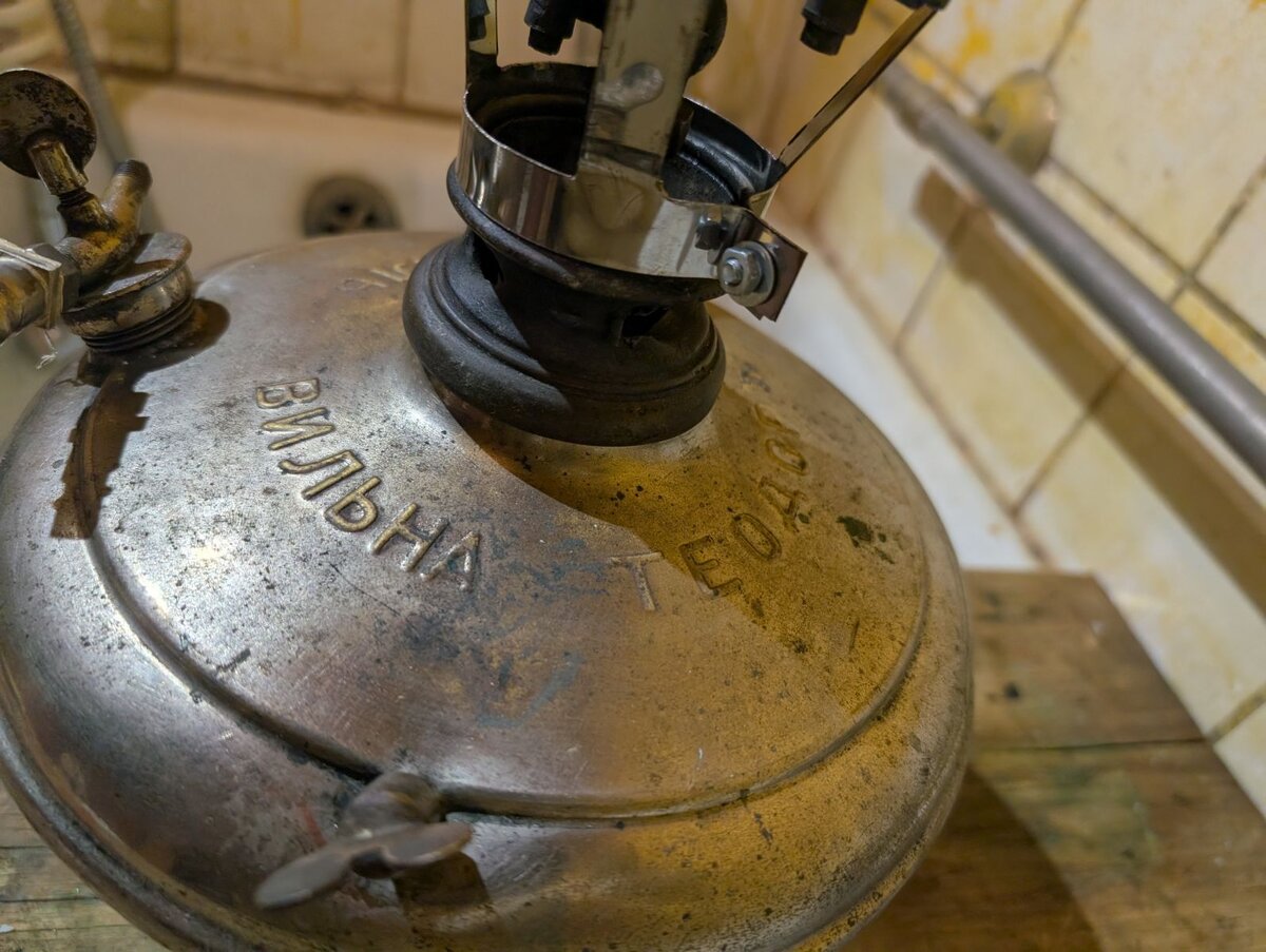

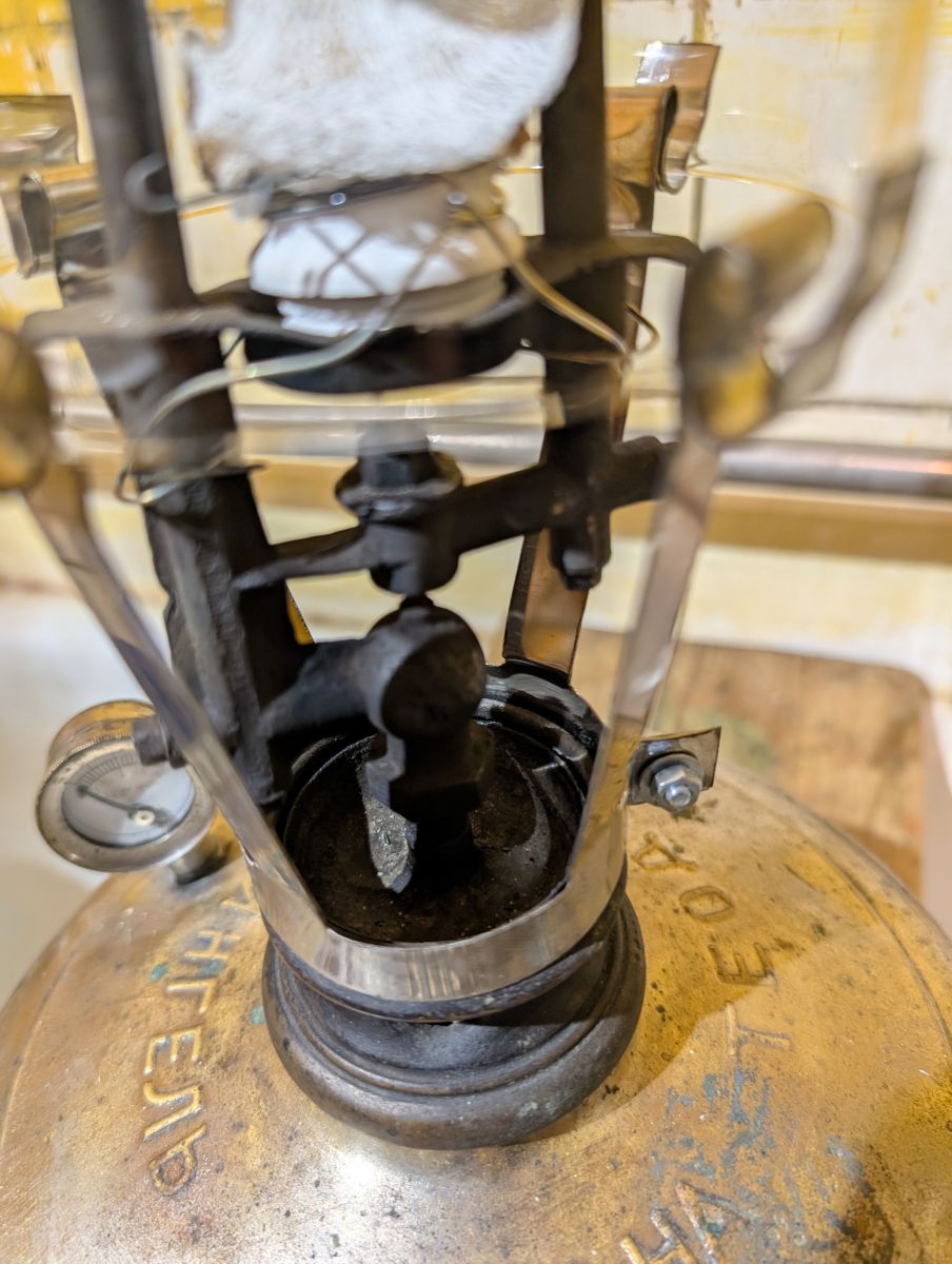

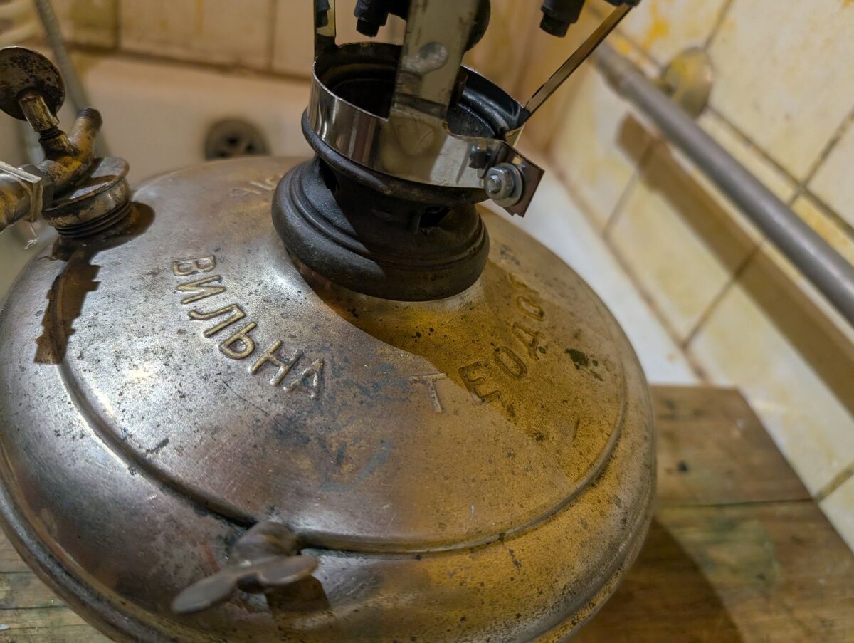

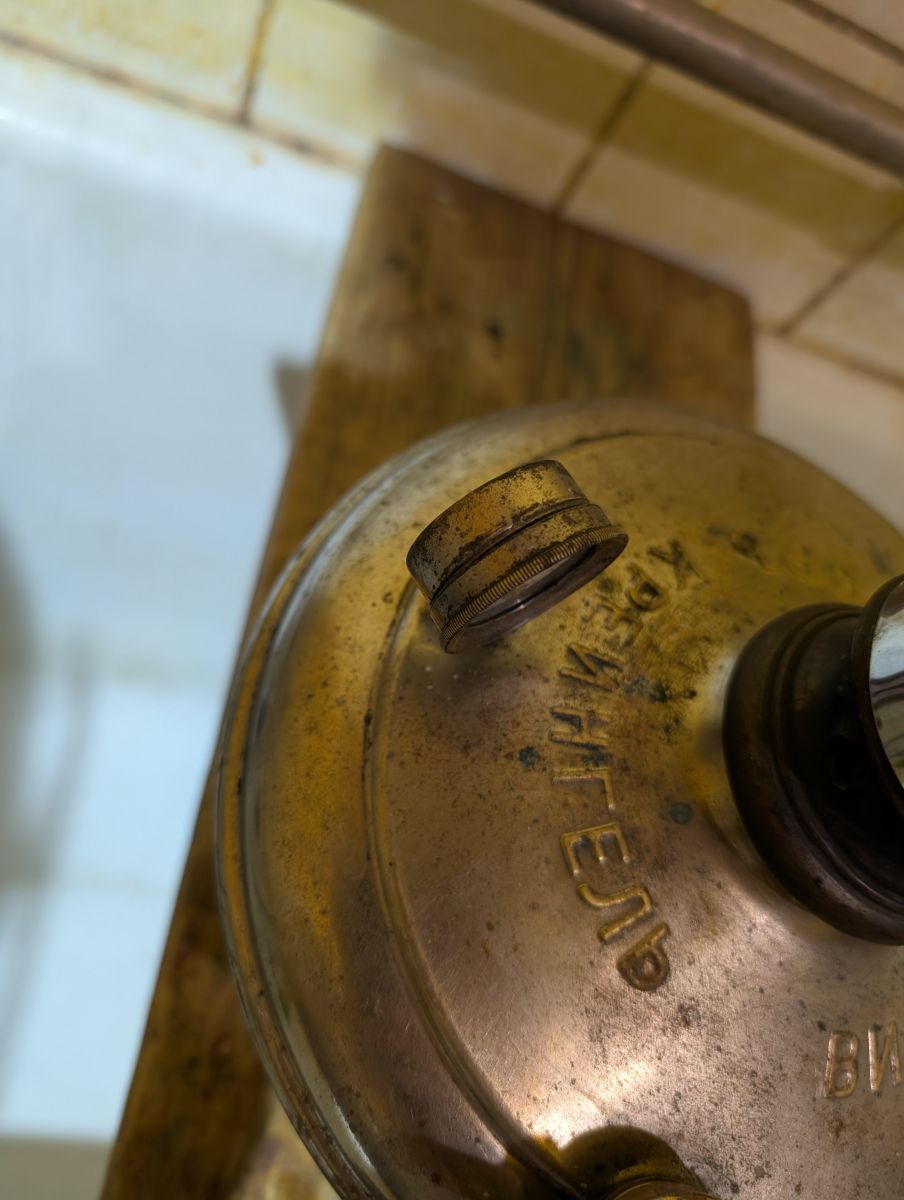

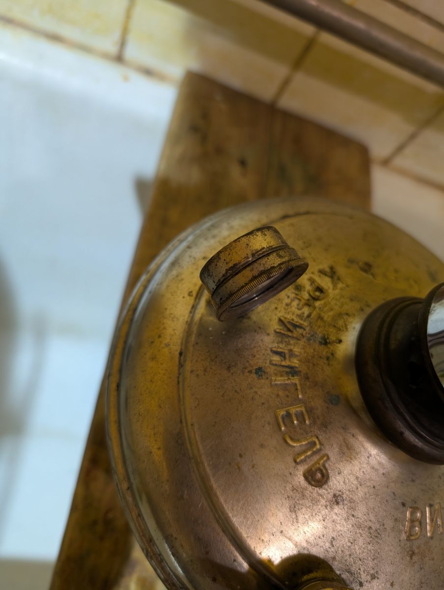

    Here is another Theodore Kreingel "Meteor" from Russia from the early 20th century.

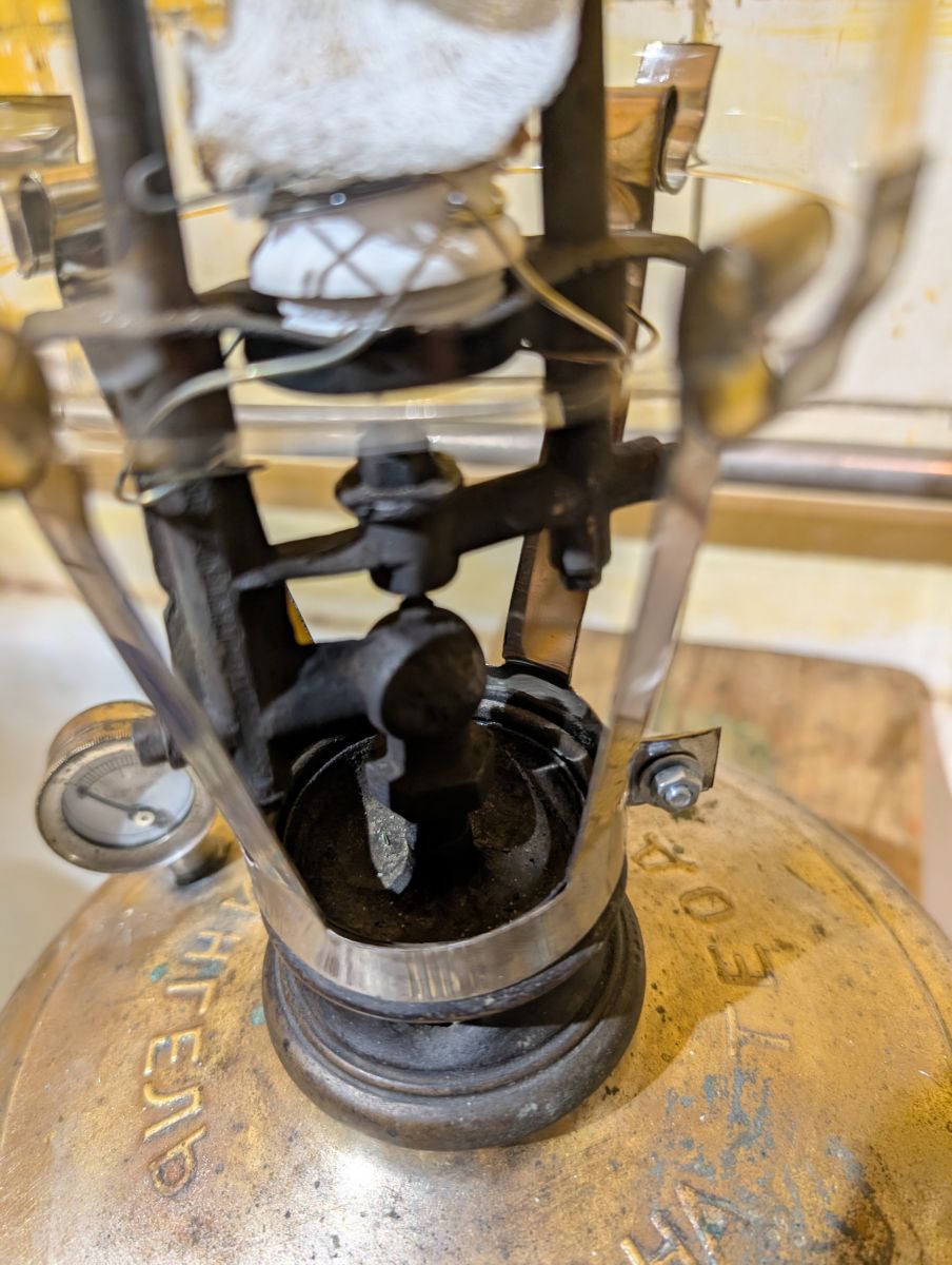

    It has a jet with about a 0.35 mm hole, so it does not work with kerosene, but runs on ethanol.
    I made a holder for a standard Anchor glass.
    I made a mixing system and mantle holder using two ceramic mixers from Anchor. The Northstar mantle fits in it.
    I made an adapter for the quick-release coupler of a modern compressor.

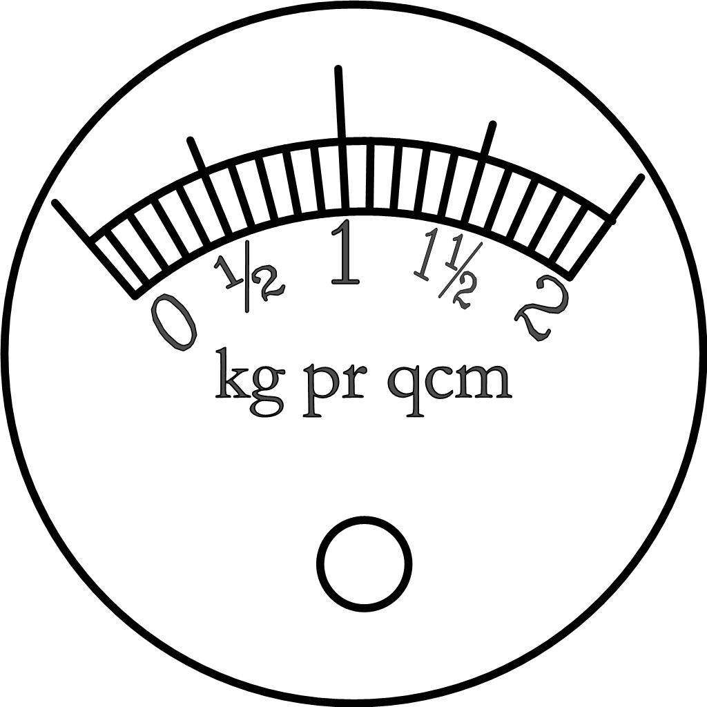

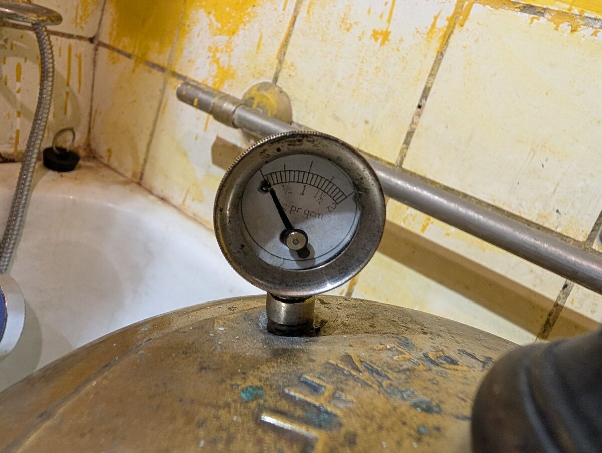

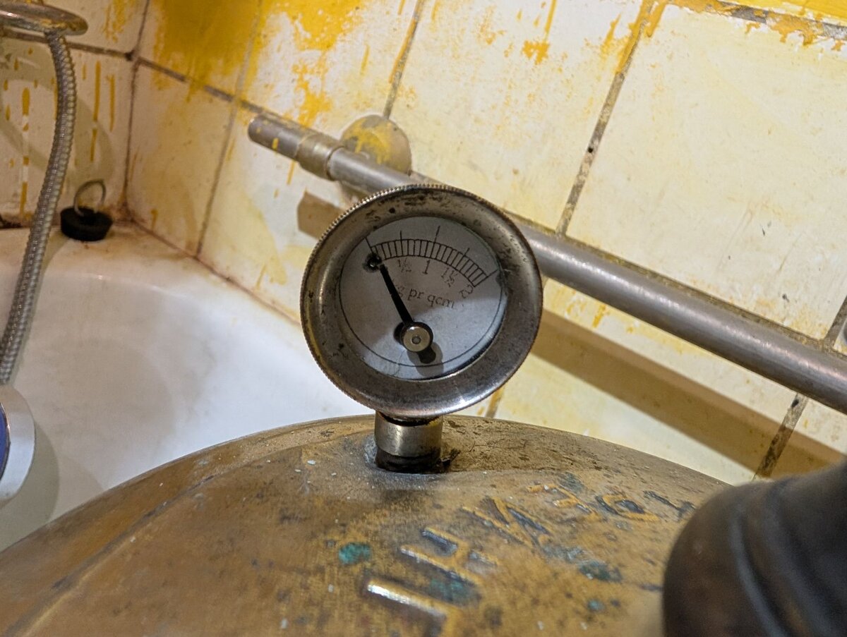

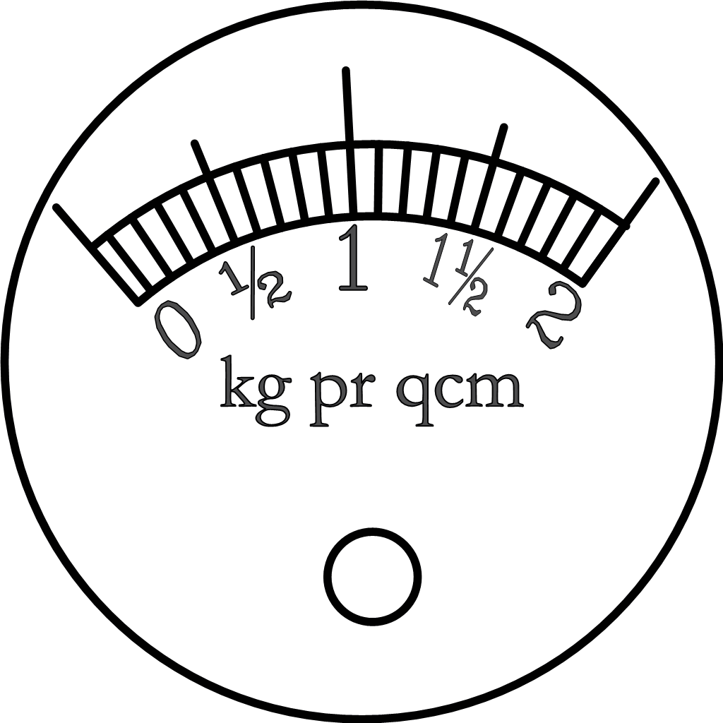

    I also made a pressure gauge scale, because the original is missing. I could not attach an SVG directly, so I attached a GIF.
    Now the lantern works relatively stably.
    Admittedly, it looks sloppy and doesn't burn quite properly. Nevertheless, as far as I know, this is the most successful operation of a Kreingel lamp in recent history.

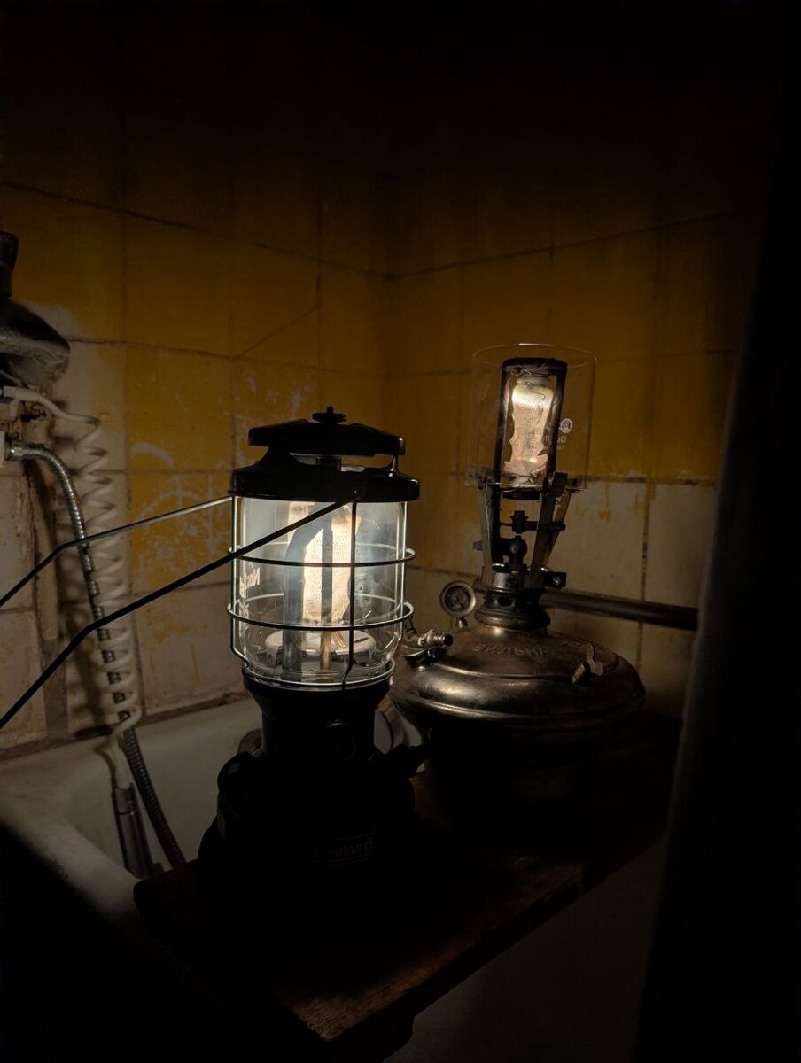

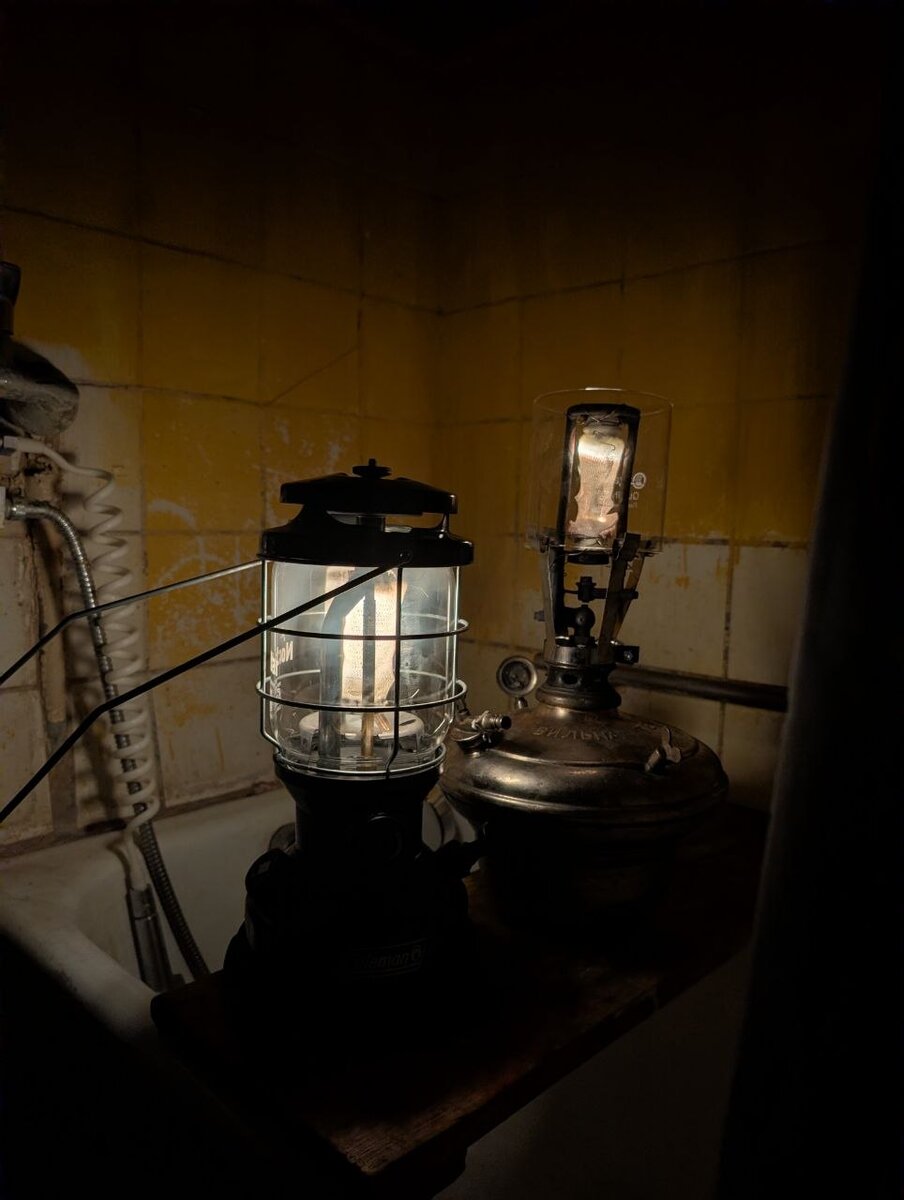

    By the way, here is my "Meteor" near the fully opened "Coleman Northstar", to compare brightness.

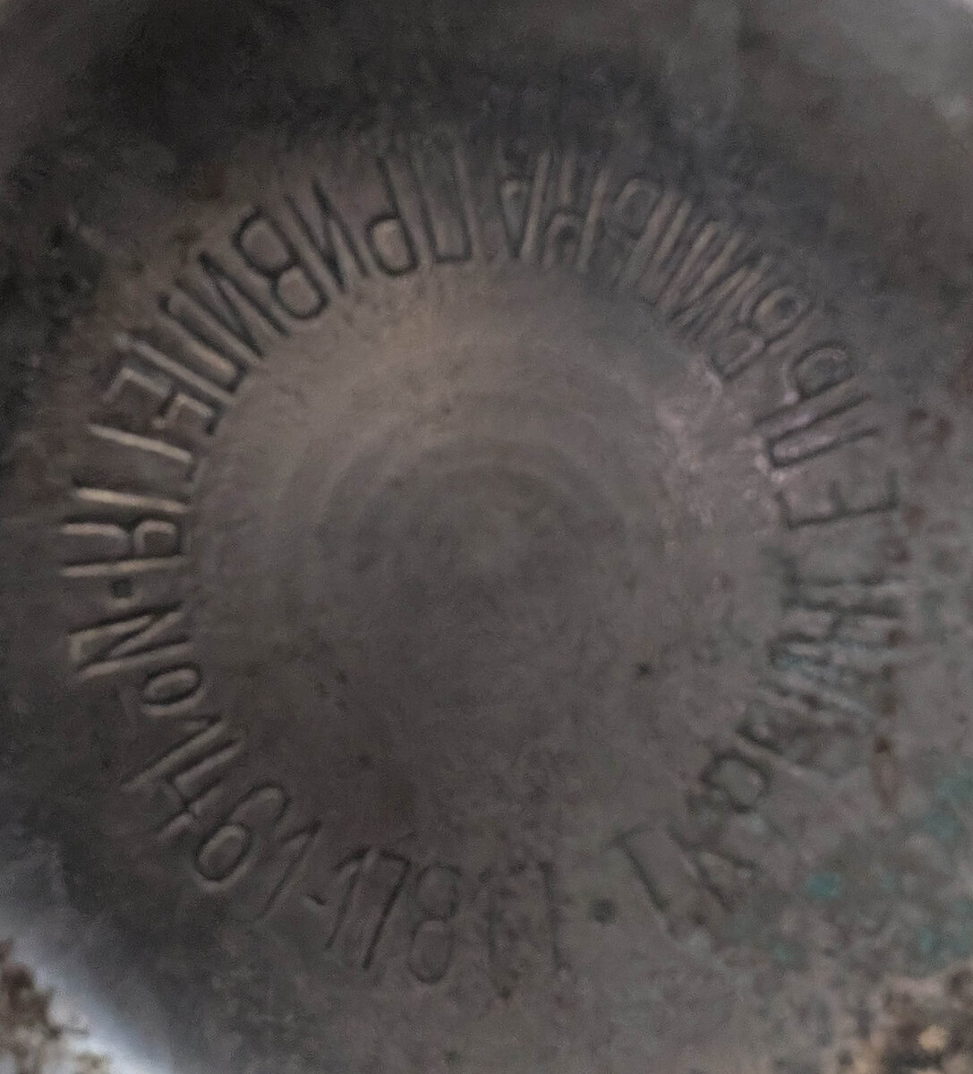

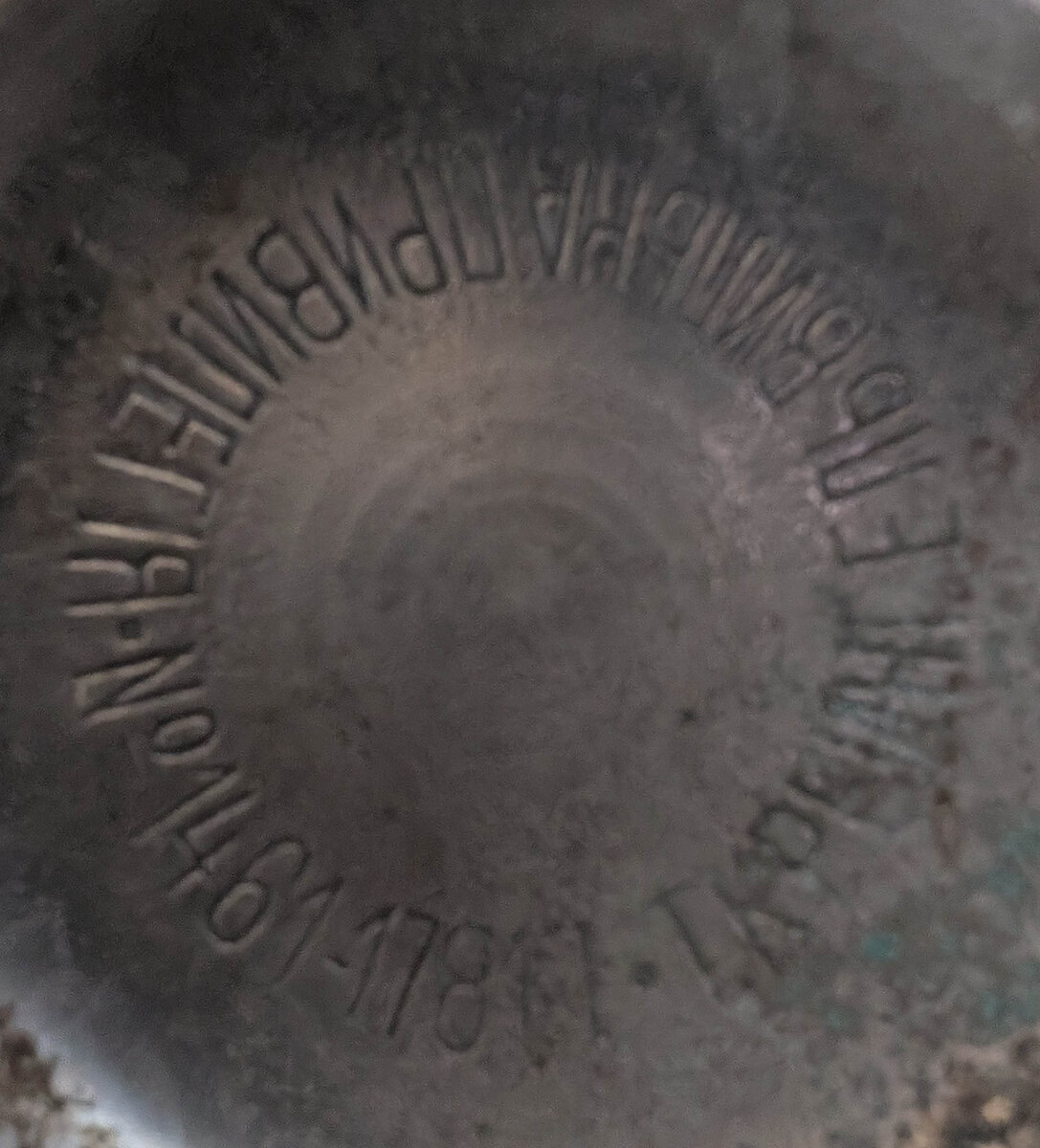

    By the way, there is the mark "Привилегiя 1461-17817" ("Privilege 1461-17817") on the lantern bottom.
