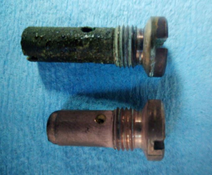

    @MG et al, thank you, a very useful thread with good content. I've just pulled a small NRV out of a 1960's Petromax 829, having never seen one until now. I would have been none the wiser had I have not read the thread.
    The "offending" item:
    Non-Standard NRV next to Standard Petromax NRV (Standard NRV Top):
    Regards, Alex

    The damned things are multiplying albeit five decades ago, i will have to get some more Petromax NRV's if i buy anymore Petromax's.

    It might be a plan to have one in stock! To be far it is the first one I have seen in 15 Petromax's.

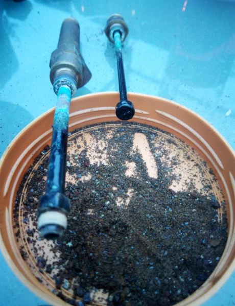

    @MG I think our respective 829's are extremely similar in terms of internal condition. Varnish and carbon from the tank:

    I have not flushed the tank yet or removed the rapid heater so i am hoping they are not too bad but yes they do look very similar, mine is certainly the worst lantern for carbon build up that i have come across, so has seen a lot of use, hopefully they will both run nicely once fettled.
  8. george
    Boy, the previous owner(s) must have run some high crap kerosene through your lanterns. I guess I've been real lucky. I've never had a carbon buildup like that. They should run really good once that carbon is all removed.

    Are you writting that there is carbon build up inside the tank ?

    There was a carbon like substance between the foot valve and filter/valve body.

    @WimVe carbon from may be the wrong word for the residue that has come out of the tank. As you can see from the photo's the Rapid Heater and Vaporizer lower part are "varnished". The black dust in the yellow lid, not sure what it is comprised of, but it looks like carbon and has come from the tank.

    @MG hopefully not. I filled it with 10 bolts, left dry, and gave it a good shake which produced the dust. Another go this afternoon produced less of it, so I am getting there. I'll fill it with Kerosene (with the bolts) and go for a wet run later this week.
    I also managed to resurrect a old standard NRV this afternoon to replace the "short" one, so progress is being made. I am looking forwards to getting this one on the "road", externally she is extremely straight.
    Hopefully yours will go well too.

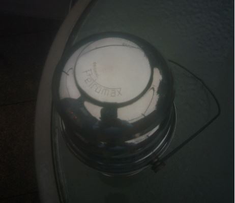

    Here are some snaps of progress so far on mine (bit dark tonight, not the best shots):

    My burner hood is very discoloured by heat but comes off ok with Autosol so i'll give it a polish once i know it runs ok.

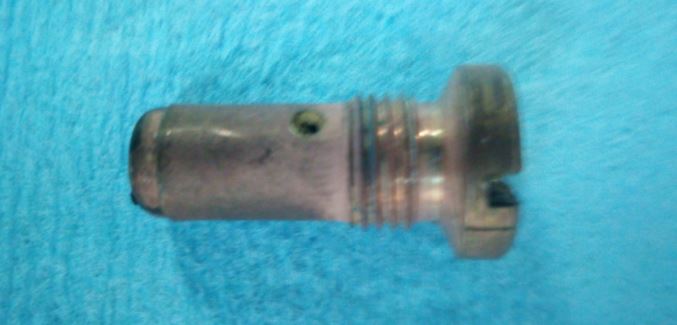

    @MG - The tale of the "short NRV" continues. A new (second hand) 829 arrived for me today (not that I need any more lanterns!). I'd presumed 1960's. On unwrapping my first thought was to check the base of the tank for the date (0625), swiftly followed by visit to the shed to get a large screw driver to remove the NRV "just in case"/idle curiosity. I thought the odds of getting anything other than a standard NRV low at this point. How I smiled and chuckled as another short NRV was pulled out! A chat with Basecamp will be required...... The period Jun/Jul 1962 seems to have a run of them!

    I spoke to Basecamp about mine and he'd not heard of one before but luckily i gave him the wrong measurement at the time as we thought a standard NRV wouldn't fit, if it hadn't i'd have been in trouble.

    @MG Re spares, one advantage of a having a few Petromax to play with! Although this time I'll bite the bullet and order a new NRV assembly.
  22. george
    I'll be damned! Apparently this style NRV was "standard" at the time the lantern was made... still have my doubts. Just can't get my head around this.:-k I have to be honest, I'm from the, "if it ain't broke, don't fix it" school. If the NRV operates okay then I leave it alone. :-s I've probably replaced or fixed three or four NRVs in Petromax lanterns and never came across one of these.
    This may be way off the beaten path but is it just possible that the pump barrel was in to the tank too far when they soldered it and therefore, the normal NRV hit the botton of the lantern in such a manner you could not tighten it down, and therefore they went to a shorter NRV to clear the botton?:-k
    This is only a pi.. poor guess, I guess..lol

    @george a useful exercise checking the age of your Petromax's, I think it helps narrow it down. I suspect (although might be wrong) that the short NRV's are a 1962 item. Not sure of the reason why tho.

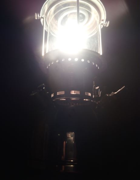

    Well that is one of my 1962 beasties fettled. First run tonight, pleased with the result, nick named "triggers broom" (New NRV and rapid pre-heater assembly fitted) Pressure Test.JPG First Run 1962 829 500HK.JPG )

    @george yep, NRV problem solved. Fitted a refurbished standard size NRV, no problems fitting it either.
