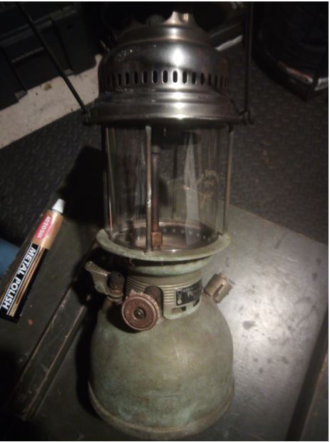

    @MG here is the before shot of my second 1962 829. Although the outer looks bad, it is straight, all the right bits have the "made in Germany" stamps etc. The internals are a lot cleaner than my last 62 829, which is a good start Having stripped it down tonight, I'm hoping to get cracking on it in the next couple of weeks.
    Have you managed to make any progress on yours? I am looking forwards to seeing photo's of all three, once fettled.

    @Alex Smith
    That should clean up well, mine is in a similar sort of condition (i gave it a citric acid bath to start with to make it easier to polish as it was quite rough) but has one fair sized dent, sadly no further along as yet, i've been quite busy lately plus i've been trying to find two decent Vapalux vapourisers in the spares dept for a Bialaddin bowl fire and a Vapalux 300X lantern which i can't get to run quite right, i've got around seven new ones but i am loath to use them.

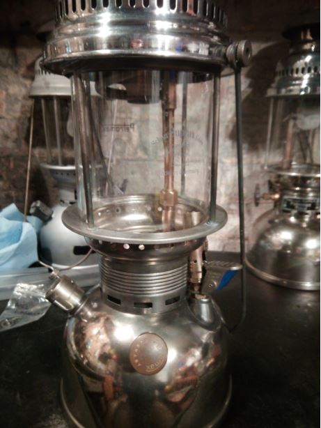

    At last, now the Fetting "time bandit" has departed, I've had chance to sort out my Jun 1962, 829/500cp Short NRV lantern. I've not fired it yet, one minor fault to iron out, but it is looking in much better shape. I refitted the original "short NRV" that it came with.
    Pre-Fettle:
    Post fettle:
    Post Fettle No_1.JPG Post Fettle No_3.JPG Re assembly.JPG Post Fettle No_2.JPG
  9. MYN
    The hood in the last picture does not belong to a 1962 model, @Alex Smith .
    I think it belonged to a much earlier model, probably from the 30s(with the two screws securing to the inner part).
  10. Alex Smith
    Jun 18, 2019
    974
    Central, UK
    @MYN it would lovely if it was a 30s hood. It is a trick of the light, that makes it look like it has two screws at the top, unfortunately.

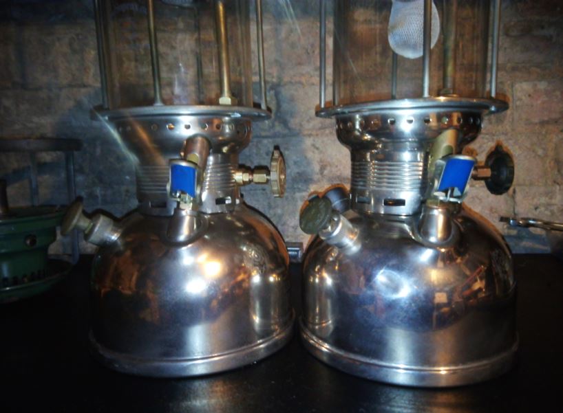

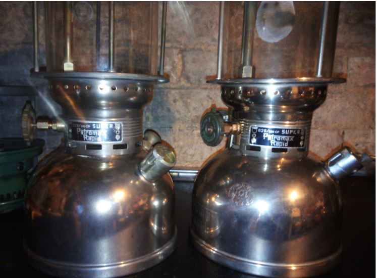

    @george if I have understood you correctly the blue backed rapid pre-heater wasn't patented until 1964? If that is the case, here is where it gets interesting. I have two of these early 1960's 829's (date stamped 0625 and 0722), and @MG has one (date stamped 0723). All three of them have the blue plastic backed rapid pre-heater flip switch. All three of them also have the short NRV. Here are photos of 0625 and 0722 together (@MG's appears earlier in the post):

    This has always been a mystery to me... I have a NOS Aida 1250, never been used and dated 1961; however, it has the metal flipper patented sometime in 1964! The box had never been opened. The seller is a very good friend and he was the first to open the box for me just to determine if all parts were there. Nothing missing, nothing out of place - except the metal flipper. When we realized the lantern was made in 1961, we both just scratched out heads... I could see where someone might have replaced the flipper if it was "not" NOS, they do break, but a brand new lantern, never been out of the box! Hard to get my head around that one!
  20. Mackburner
    Kinda reinforces my suspicions about the veracity of that date code interpretation. Always did seem too complex for me.
    The patent is DE1228575 Applied for 22 October 1964 and granted 17 November 1966. It is unlikely but perhaps just possible that the new patented rocker valve was in production before the application. It may also be possible that the tanks were made and dated two years before the lamps were finally assembled and left the factory. Both seem unlikely to me which brings us back to that date code. ::Neil::

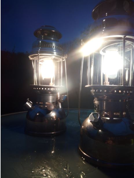

    I finally got around to finishing the fettle on my second 1962 Px 829 so I could light her up. Here is the "money shot" of both of them (it was a bit dark by the time I'd finished). Both run nicely:

  24. WimVe
    3,544
    off coarse they run nice, they are Petromax lanterns !

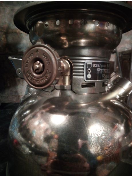

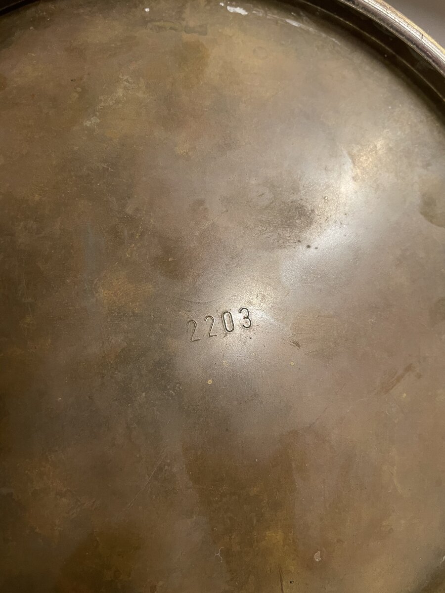

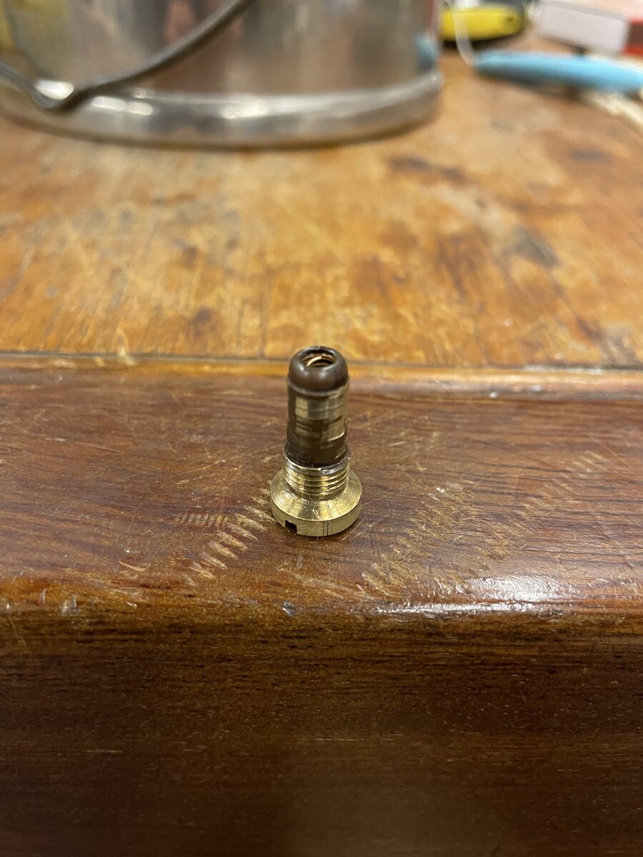

    I know this is an old thread, but I wanted to say a quick thank you as this pesky NRV has been annoying me for about half an hour.
    Found on an 829 Rapid, stamped 2203 on the bottom. Original glass with an ‘E’ in the logo.
    Cheers,
    Adrian

    @Buckaroo
    2203 means 22nd week 1970 Wednesday.The valve shown is a one-way valve. They were build into the Petromax, Pico Star, Day Lite in the early seventies. I would swap it for a normal Petromax valve.
    Regards Reinhard
  29. Reinhard
    Reinhard Germany Subscriber
    Oct 15, 2018
    1,135
    @Alex Smith
    That is the real age of the 3 Petromax 829 :
    0625=6th week 1972 Friday
    0722=7th week 1972 Tuesday
    0723=7th week 1972 Wednesday
    You can see it clearly on the rapid lever and what is even more important on the substructure of the Rapid lever.
    Regards Reinhard
  30. Fireexit1 United Kingdom
    3,538
    @Buckaroo - yes my 1968 vintage example Px also had the non-rebuildable NRV valve. Others have commented on these in the past. And as Reinhardt says - the "proper" one will drop in.
