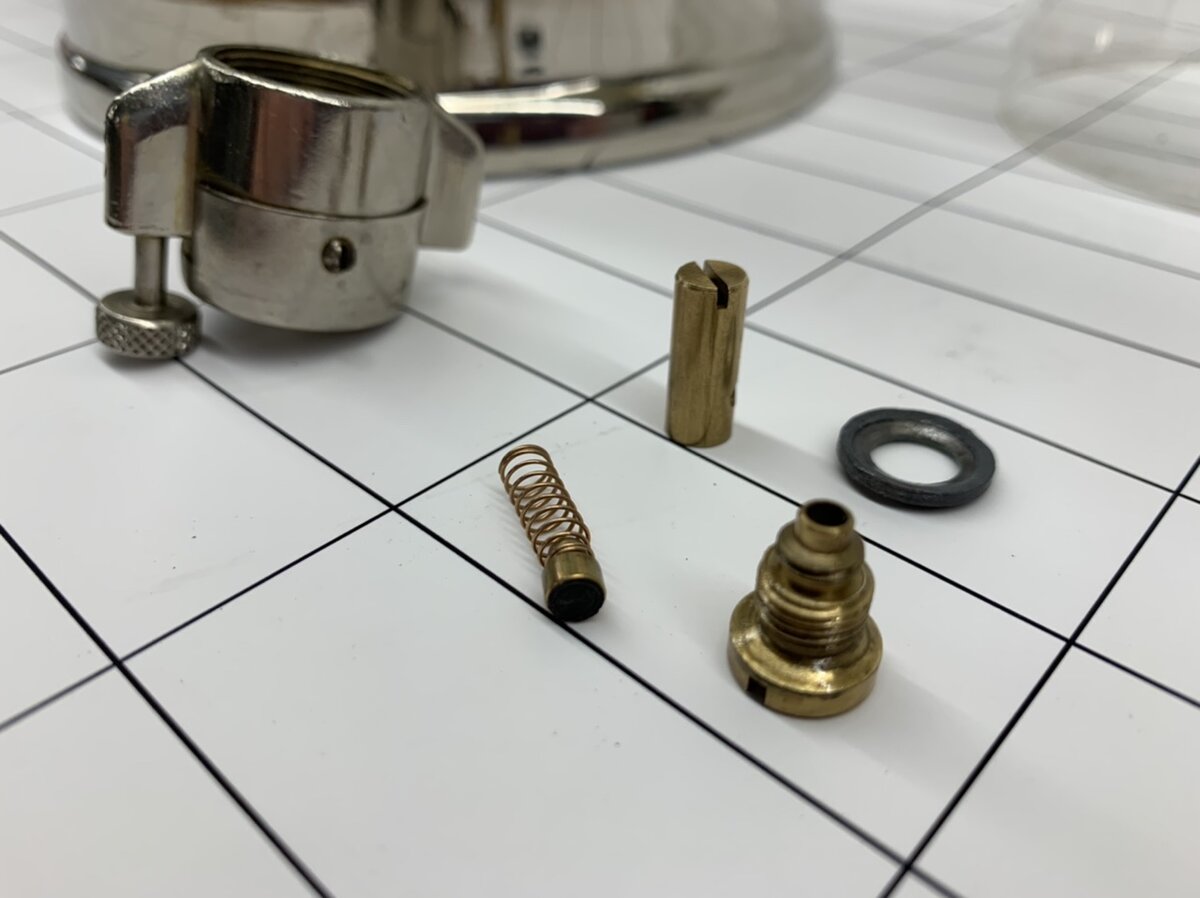

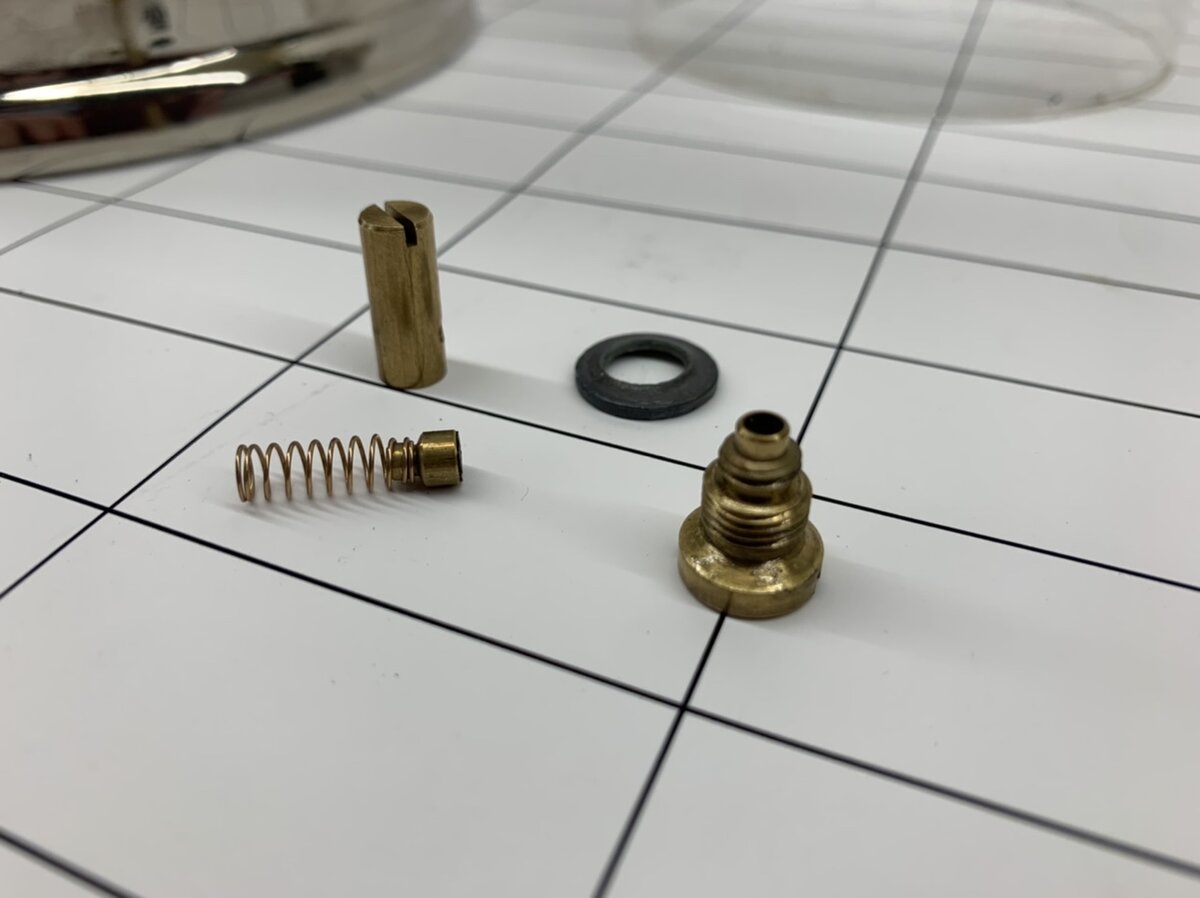

    jumping on this thread to ask a question on the NRV in my 829. i was doing a little fettle today as the pump likes to rise under pressure.
    is it possible to replace the PIP in this? the spring seems fine., and it’s nice and clean. 2BB8CF59-1C32-4511-B5A2-779CB7624421.jpeg

    @Tyler Hall After a thorough cleaning of the metal parts you could simply replace the rubber insert of the valve with a self-punched one made of Viton (or other petrol-resistant material), as the original one has probably hardened, at least on its surface. You could also try to carefully remove the existing insert and replace it upside down.
  6. WimVe
    3,530
    Yes you can change the pip seal. You can even flip the rubber out and replace it "upside down". Unless the rubber is harden solid over time.

    Search the Fettle box in stove parts for NRV 4mm pip and 4.5mm pip. I can't remember which fits the Petromax NRV but I'm pretty sure one of them does. ::Neil::

    I was able to break out the old crusty pip and fashion a silicon button to replace it. It works. Will be looking for Viton as a permanent solution.
