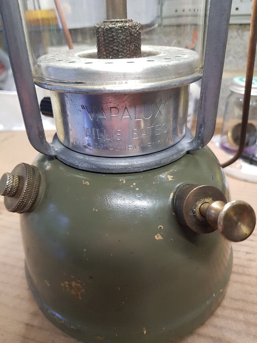

    Well on a cold and boring day with some light snow, I was bored and I didn't have the seal kits to work on this lamp, so I went into the loft and dug out another W&B lamp I bought about 10 years ago at a car boot sale (I'm not really a collector), the man had 2 lamps and a few spares all ex army, he wanted 11 pounds for both lamps and I only had 9 in my pocket, dam i bought one lamp and two new vaporisers .
    Took the lamp into the garage and gues what.
    The lamp has the same aluminium collar with the same inscription, the hood looks slightly darker but I think this one has been used more, and the screws that hold the frame to the fount are brass the new one has steel screws, the seals were not too bad so I fired it up
    Someone mentioned karma earlier, it seems these lamps find me, I now have 4 W&B lamps.
    Just one thing the mantle mounting grooves seem close and the mantles seem to go a strange shape when burned i.e. a bit saucer shaped rather than golf ball shape, am I missing something?

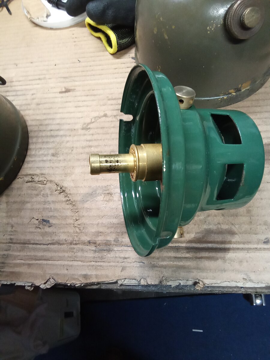

    Here is the one I fired up thi afternoon, the mantle is a new one, it's actually a bit better after burning for about two hours
    This is the spigot on the other lamp, it's the same on both

    As I recall I think all Willis Bates burner spigots are the same?.. Not certain about the E41 though.
    That looks a good shaped mantle to me... Lots of pumps (100) and the dark patches will burn off with use..
    I always find that they take a while to 'burn in' :thumbup:

    Maybe I meddle with things too much, but looking at it made me wish I had access to a lathe to make a spigot 10mm longer, wonder if that would give a better shape mantle.
  19. Fireexit1
    1,029
    Which is pretty much what Tilley did for the x246b/500 version along with a bigger mantle.

    Yes, but with the same 606 vapouriser that was incapable of filling the larger mantle - so they had you use more pressure (130-140 pumpstrokes IIRC) to provide the extra fuel/air mixture. In an X246B tank? - no, I don't think so. [-X
    I'm pretty sure they subsequently brought out a so-called '500' vapouriser with the same external dimensions as the 606 and, presumably, a larger jet (but I'm speculating there). I've no idea how that worked out.
    Don't bother - I had a longer spigot machined up and I can't say there was much difference in light output. But then I wasn't going to pump up the tank to twice the normal pressure. There were some light grey areas on the mantle which I took to be the precursor of BMD suggesting insufficient vapour/air to fill the mantle... :whistle:

    One question David, did you use a bigger mantle when you tried the longer spigot?
    My concern is the distance between the tieing points on the spigot, you can see in my picture the burned mantle looks like an upsidedown pumpkin, I wondered if increasing the distance and using the same mantle it would assume a more elliptical shape when it burns in.

    The mantle on your lamp looks fine to me. It has formed a natural shape. If it doesn’t exhibit black mantle disease, and emits a good light, you’re all good.

    Finally Postman brought the new seals for my latest lamp, so I fitted them and gave it a try, I tried to arrange the mantle a bit better when I tied it on, and I think it's better.
    One of them has a green knob on the stop cock and the other has a black one is this something which relates to the date of manufacture?

    @rayw The black knobs were introduced on the Vapalux 320 model lamp, so perhaps as early as the late 60's.
    On the model M-1 the green knobs were phased out, well into the 70's. But being army issue, your lamp(s) could have both due to indiscriminate servicing, and the colour of the knob not a reliable indicator of age.
