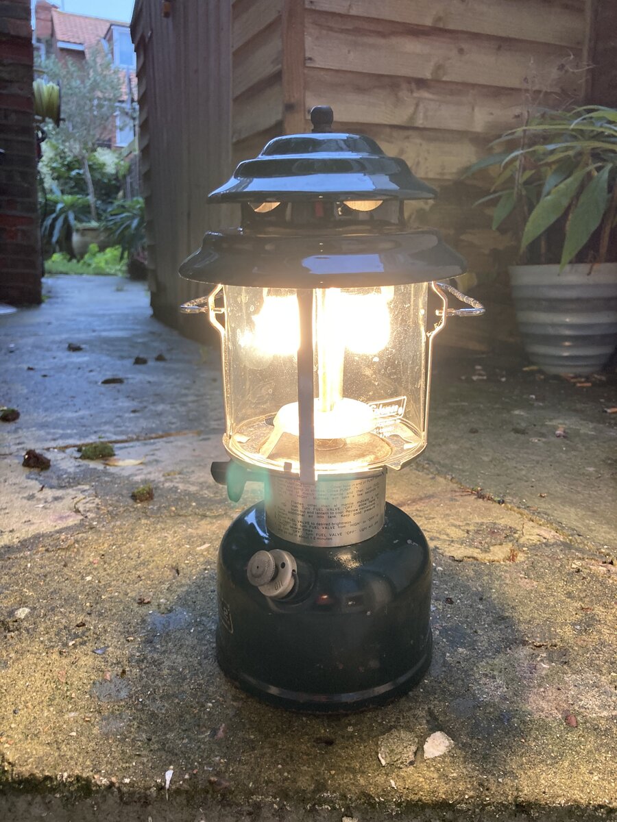

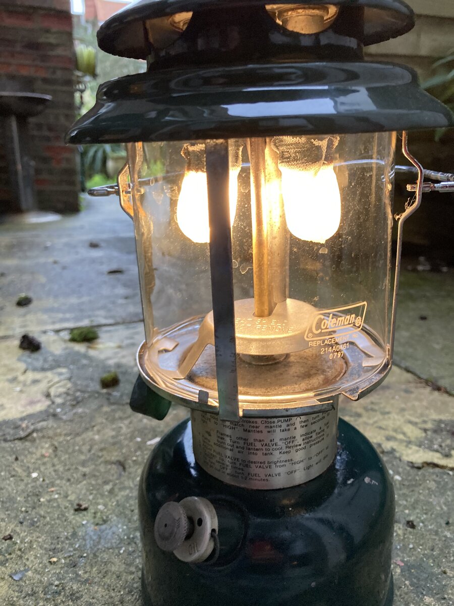

    And in conclusion a *success* story:
    So I broke the cardinal rule of troubleshooting and changed many things at once. Due to mantle costs mainly it must be said.
    1) Soaked burner in citric acid solution overnight. 2) New generator 3) New graphite seal (the old one was broken and more like powder, but not leaking fuel). I had replaced the schrader valve before. Considering I had already bought a new globe for it it "might" have been chaper to buy a new lamp overall - but nowhere near as much fun.
    Of note maybe was that the bottom of the paper in the generator was totally black. I did wonder if the over-compressed graphite and worked its way into the paper. the new generator certainly threw more fuel in the air...
    Two pictures, one at full flow, one on low showing flicker free even luminosity. Runing on Holts brake cleaner today.
    Thanks for all your steers and suggestions. Given global warming we might get mud wasps here one day - so I am prepared for anything now :-)
  9. MYN
    That is an excellent result.
    Did you mention that the new generator threw out a lot more fuel than what you had previously? A little curious here. Was it still spluttering fuel mixed with air?
    The new one certainly would provide a stronger flow to fill up both burners.
    I believe the citric acid soak did remove considerable crap from the burner as well.
    Its not very likely that you could have squeeze any of the graphite into the paper inside. I believe it could be just old carbonized fuel.
  10. Fireexit1 United Kingdom
    3,527
    @MYN the new burner did still splutter - but not as much.
