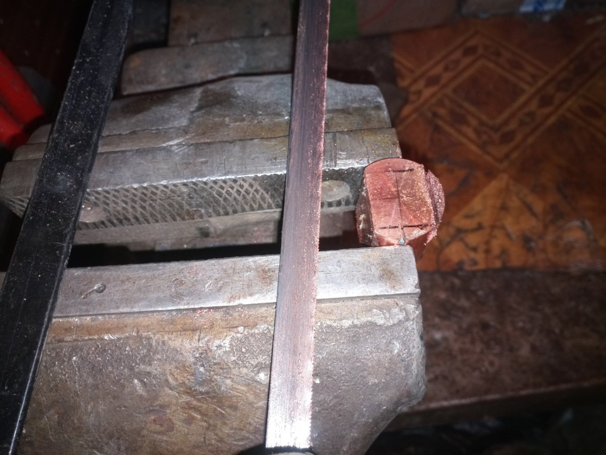

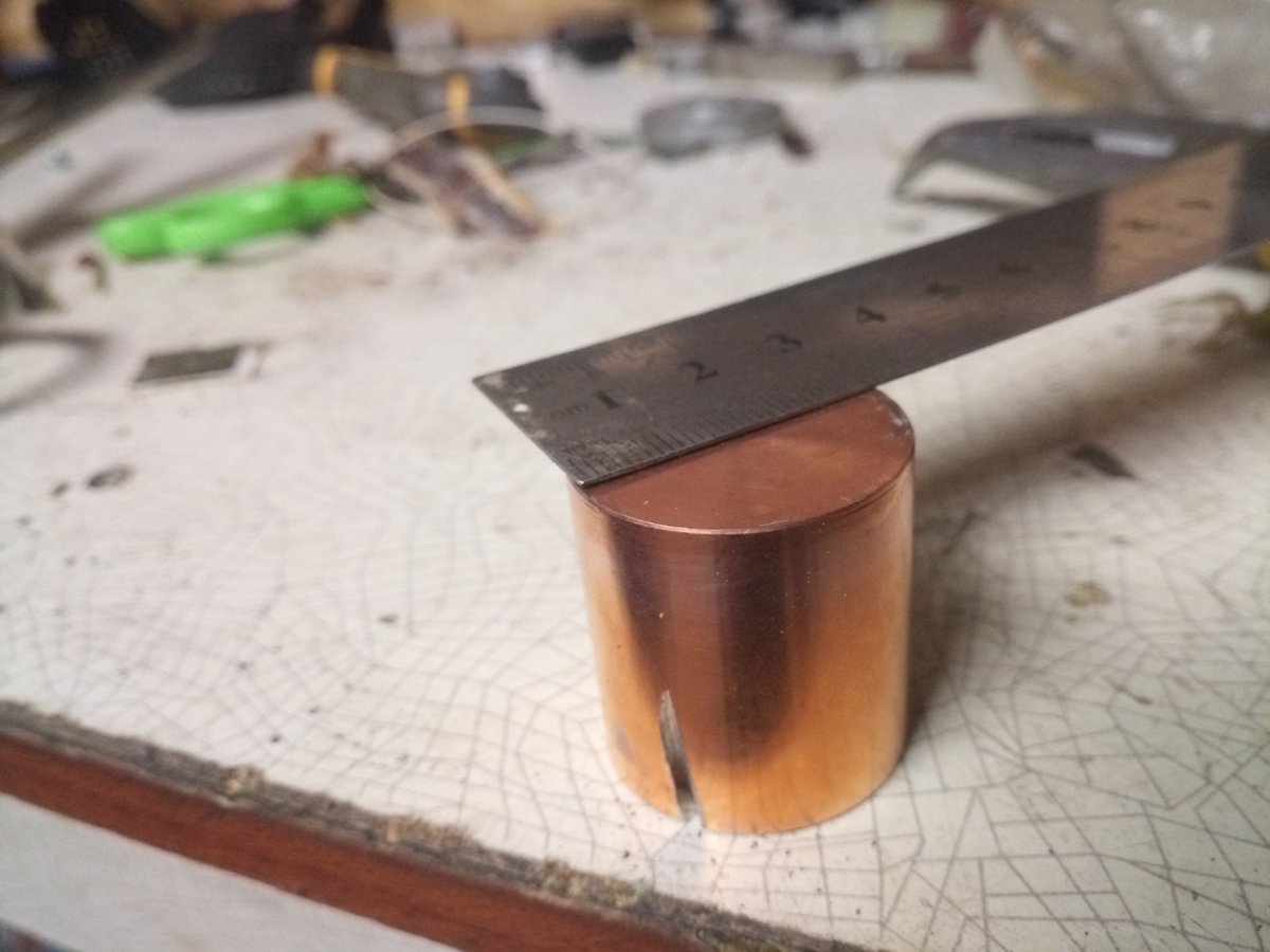

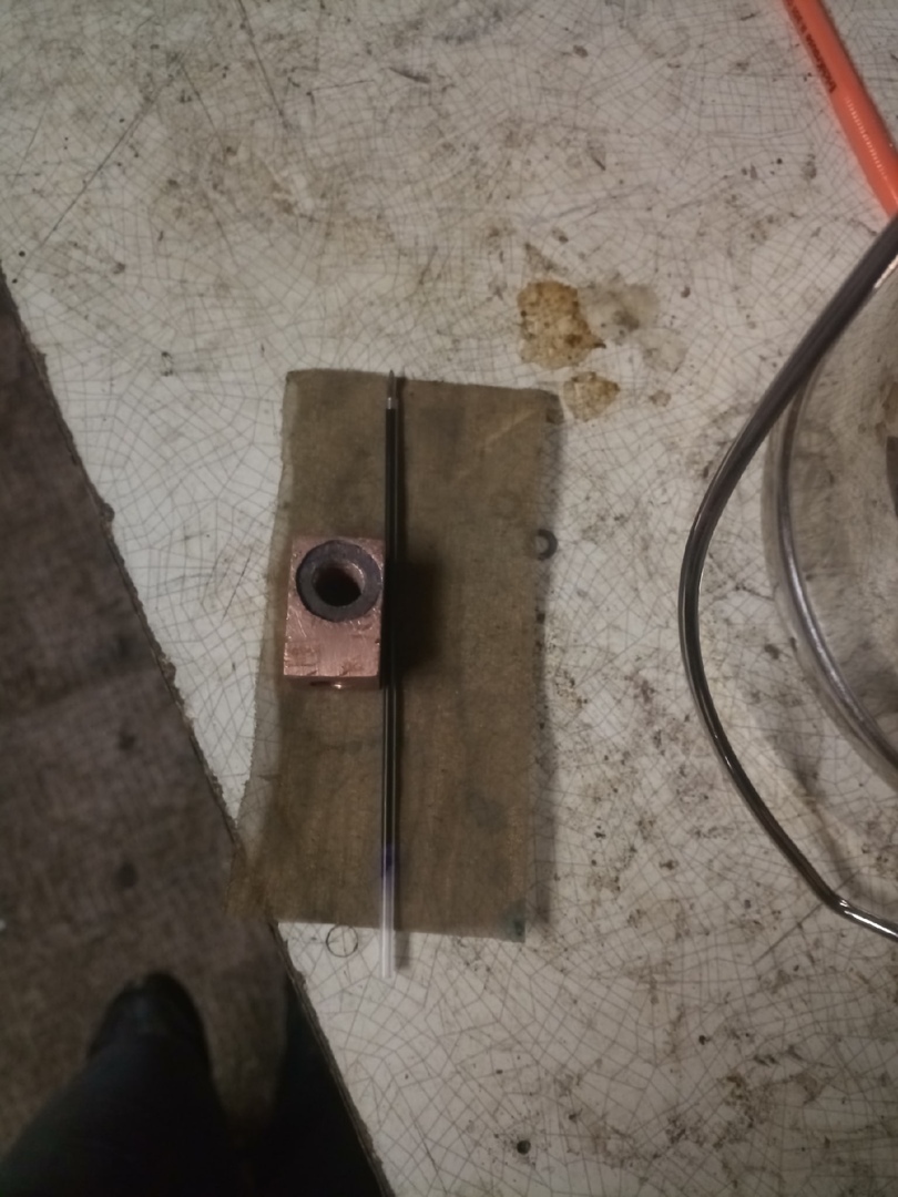

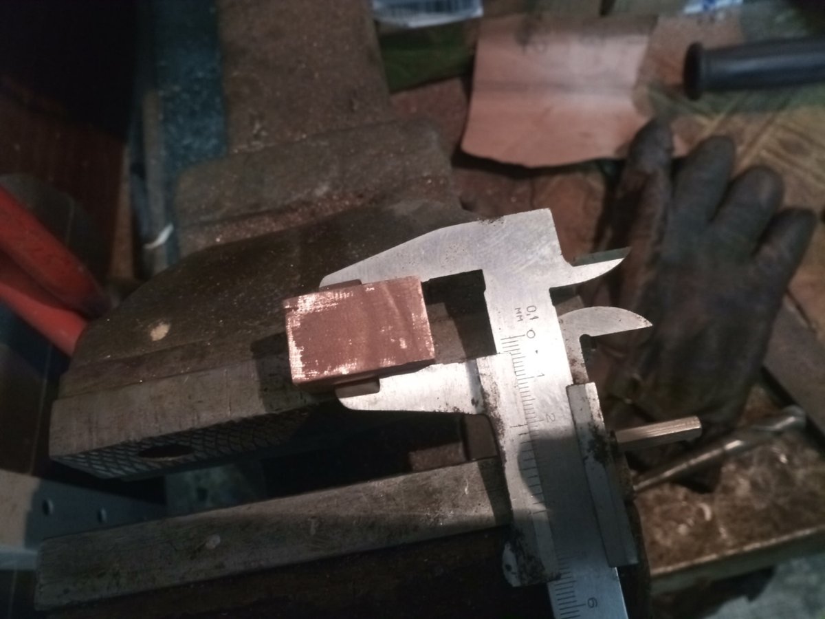

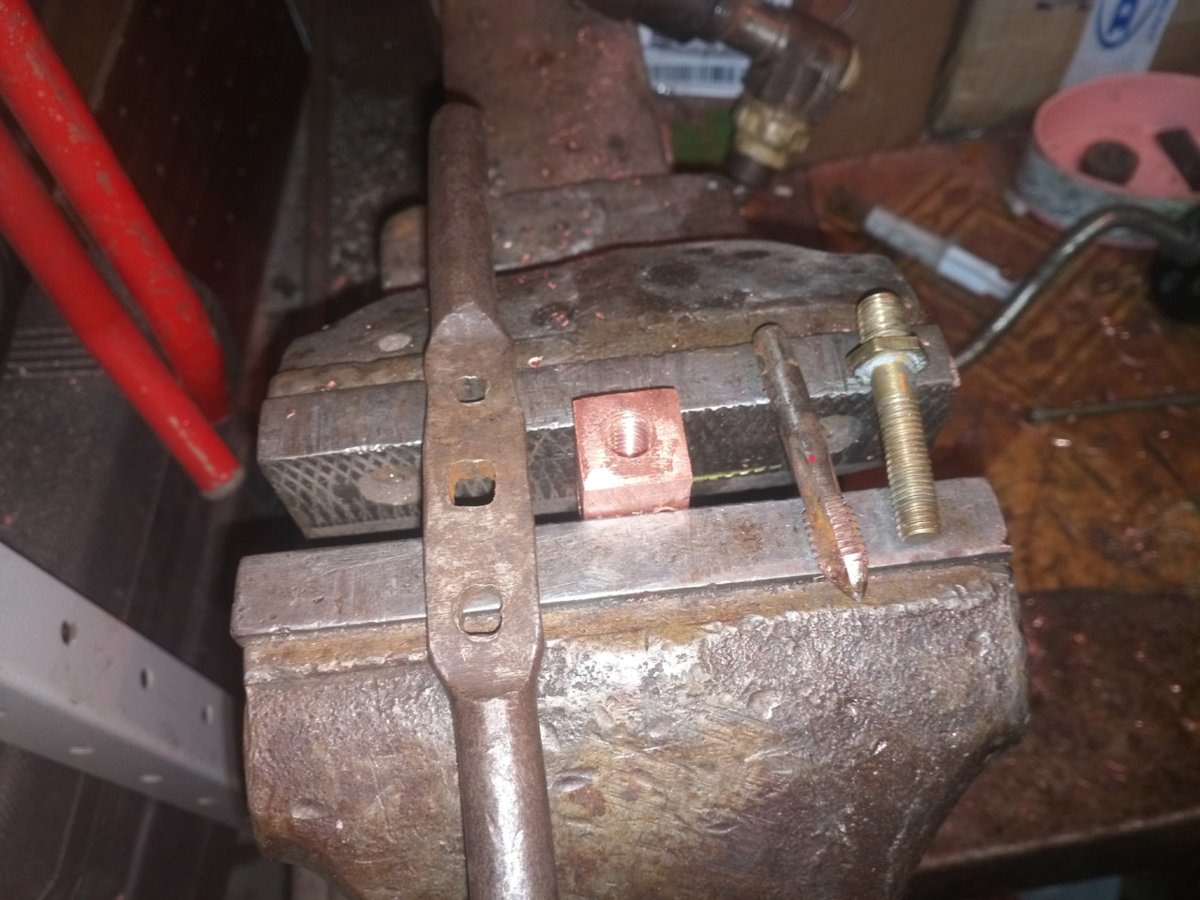

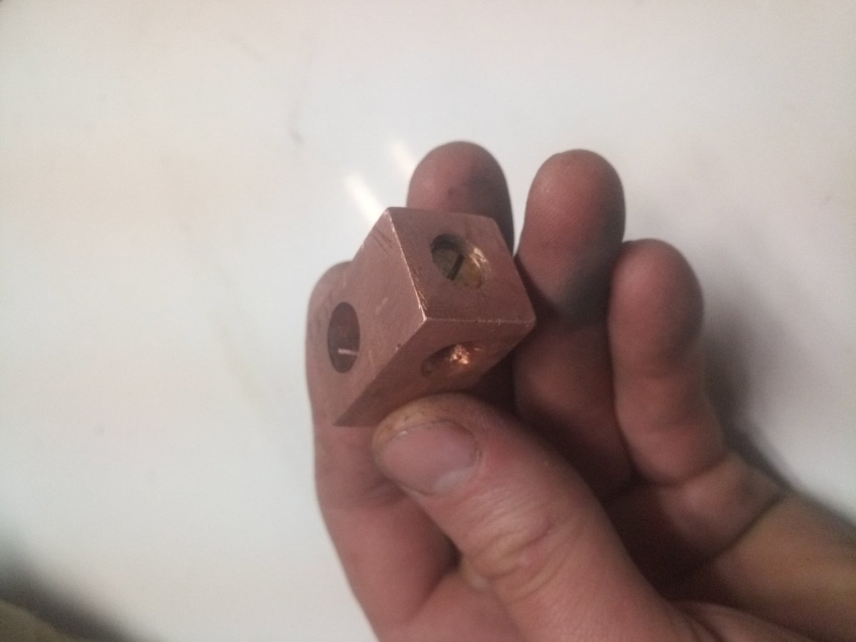

    Hello, I want to share my experience in the independent manufacture of an alcohol adapter for Petromax 500. My friend sent me the sizes of the original adapter. With him, the lamp started, but the glow pulsed. after installing a twisted copper mesh into the generator, this passed, but the lamp still shines worse than on kerosene.
    After reading this topic, it became clear that the hole in the nozzle needs to be increased, it remains to know how much)

    I think you did well to get that lamp burning and I am impressed with your fabricating skills. If your lamp is spreading light in an even, non-pulsing way, even if it produces less light, I think you have accomplished all there is to achieve. Given the lesser caloric value of alcohol than paraffin, the output of light might be affected the way you describe. A richer mixture could - in theory - be accomplished by using a smaller mantle.

    Sometimes, its good to have a little trial and error exercise. I'd first try to use a jet with an orifice that's one standard size larger for alcohol. For example, if its for a 350cp kerosene lantern, the usual size of the orifice would be approximately 0,20mm, +/- 0,01mm. If its to be tested for alcohol use, I'd put in a 500cp jet (~0,24mm?) and needle instead.
    And if its for a 500cp unit, I'd enlarge the orifice of a spare jet up to say 0,30mm or thereabouts for an initial trial. (0,30mm is considered very large; too large for kerosene or petrol lanterns in most cases and about as large as some jets on stoves and some blowlamps).
  14. Nils Stephenson
    3,414
    For a 500cp lamp to run on alcohol the jet needs to be 0.38mm. For 300cp it is 0.3mm.

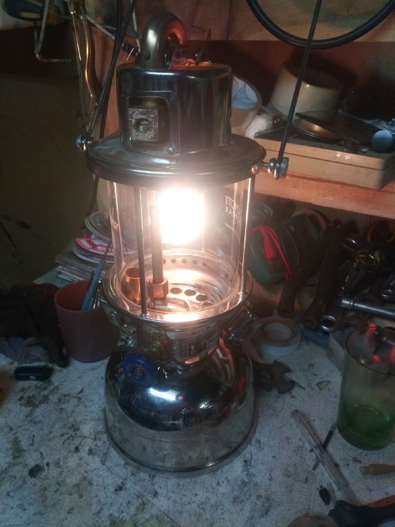

  25. Antonis Tsolomitis Greece
    Sep 16, 2019
    180
    Samos, Greece
    It took me a few months to come back to this project. So this just to report that after fixing a couple of leaking issues the lamp worked again using Petromax kerosene (Alkan):
    This is a 826, CP350 with Sicke tank, made in October 1954 by Petromax. I will not use any other fuel than the above anyways.... Thanks to all people that helped me find information.
  26. Tony Press
    11,105
    Excellent!
  27. bp4willi
    1,156
    Antonis,
    Nicw looking lanteen.
    Congrats
  28. AussiePete
    It looks great, Well done.
  29. george
    I like it, but then I pretty much like all the German made Petromax lanterns!:mrgreen:
  30. MYN
    The Petromax Alkan should be a highly refined grade of kerosene, I suppose? Your lantern would love you for using that.
    Its not cheap though.
