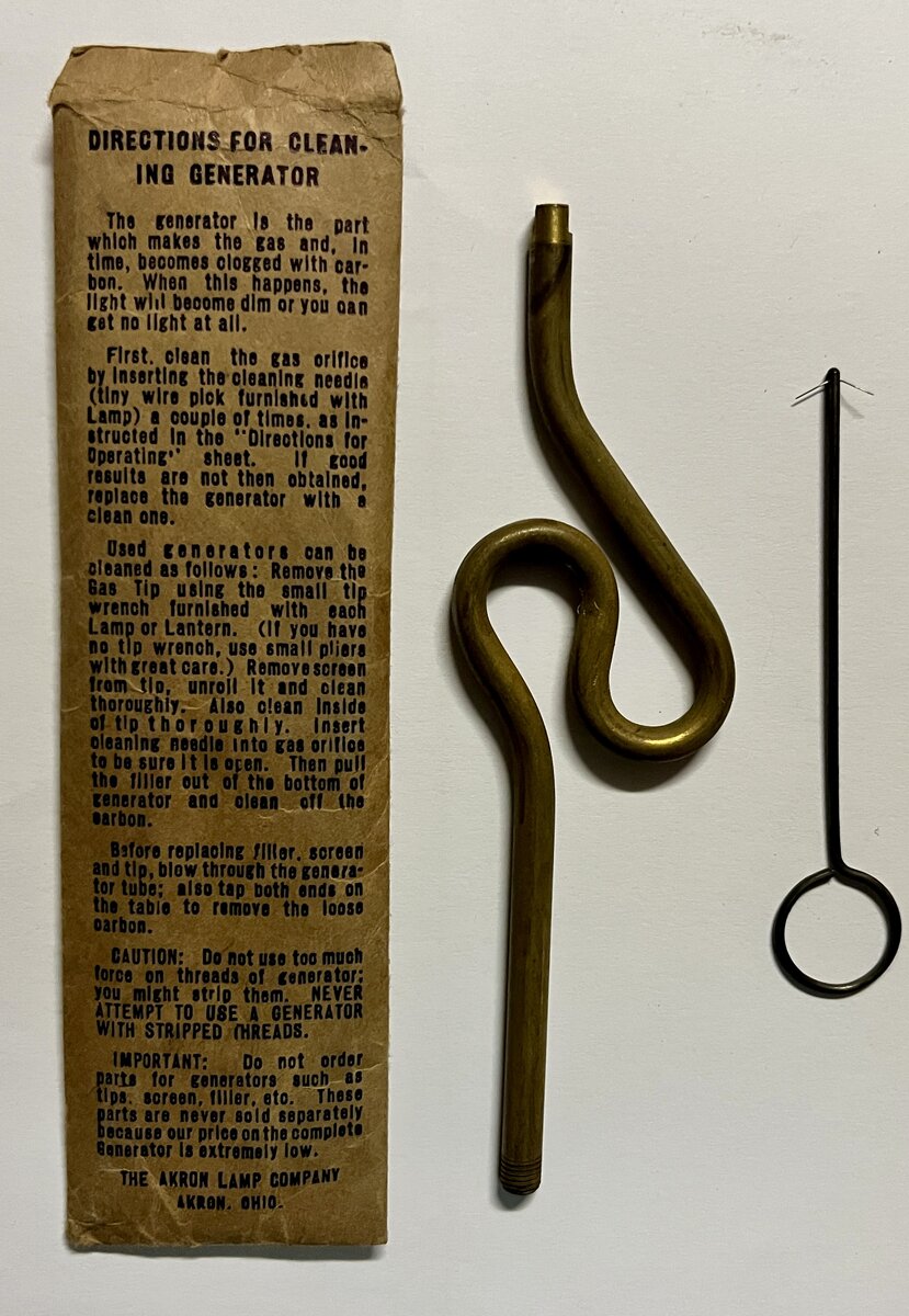

    This is a NOS Akron generator with pricker. The pricker was in the packet with the generator.
    The pricker wire is 0.15mm (5.91 thousandths of an inch).

    @hikerduane has shown the same generator (without pricker) here.
