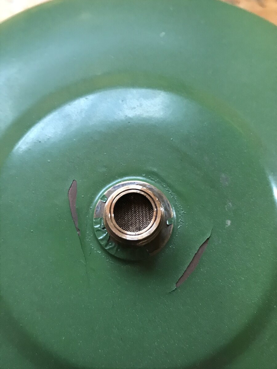

    @Damien
    Did you clean the filter that sits in the tank below the valve manifold?
    Here is a picture of it.
    The filter is an interference fit and can be coached out with a pin or needle.
    If this filter is blocked, or almost blocked, you may get a dribble from the jet but not enough to support a flame.
