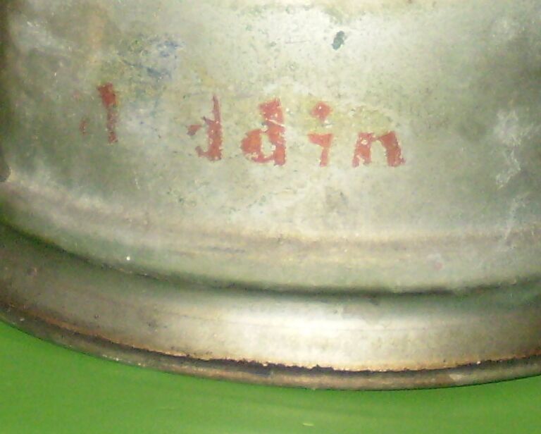

  9. Handi-man Australia
    Mar 9, 2018
    83
    This is my only example . I think from the 1950's ? It has remains of a red decal on it.

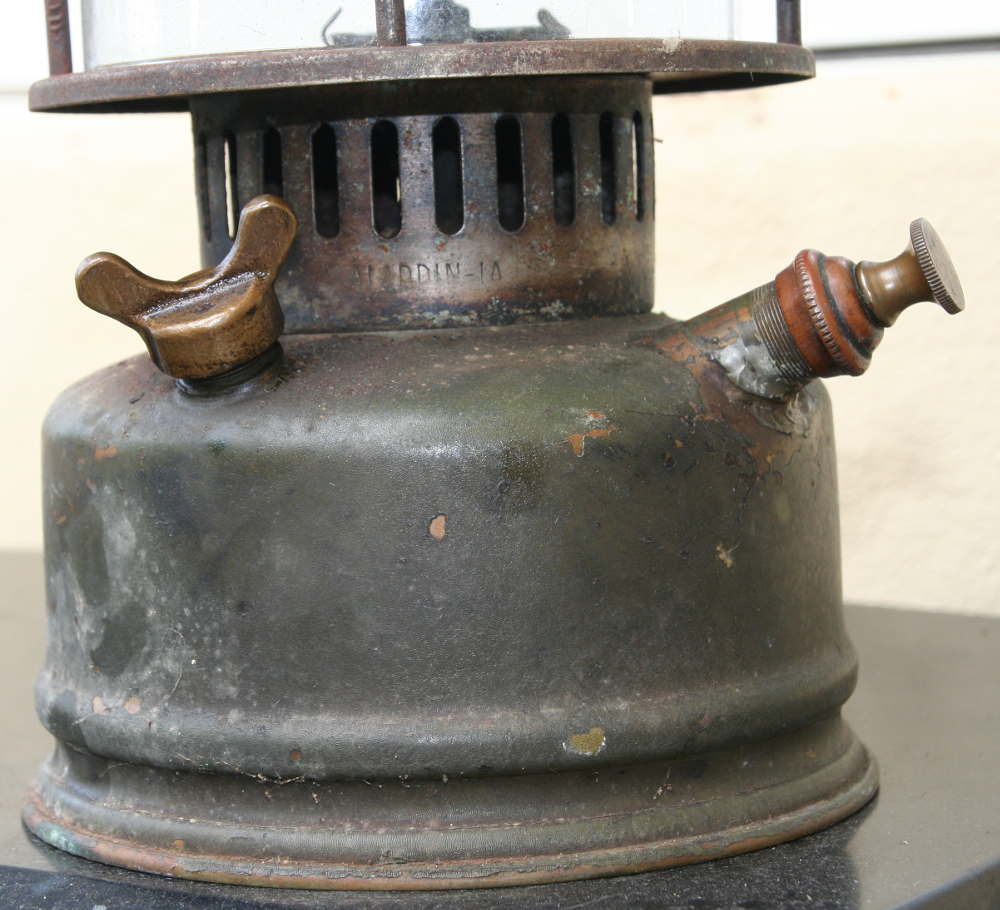

    Queensland, Australia
    Tony,
    Perhaps you are correct. I thought I could see a winged fuel cap and mistaken it for a 12A. I actually own a 1A that has it's own distinct winged fuel cap.
  14. Tony Press
    9,632
    @Matty
    I have one of those Aladdin 1As with the winged cap. I think it’s in my “Classified as Irrepairable” pile.
    Edit: @Matty. It has the same pump cap (that screws to the pump tube).

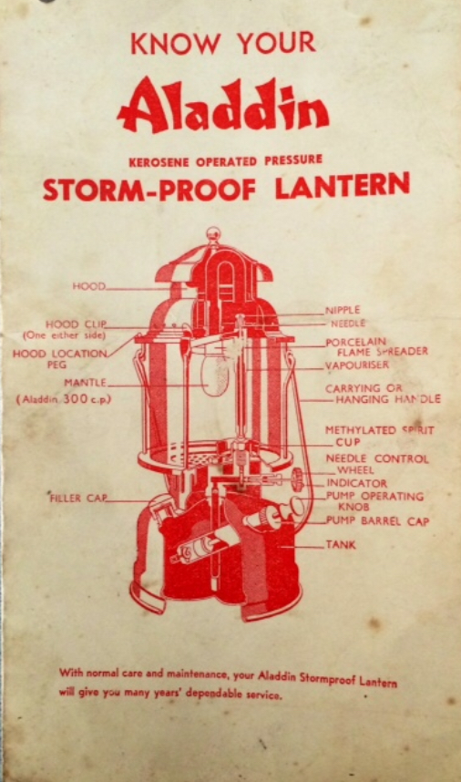

    Tony,
    You remind me that I saw a parts list the other day and within that list, I saw flame spreader listed as a part for Aladdin pressure lanterns. I quickly ignored that list as I was terrified if I had of posted it, the ad, nay sayers, would have said "I told you so" "they have mantle lamp parts mixed in with pressure lamp parts so you can't trust it"
    Tony, you said this above: "Both Austramax and Aladdin called the flame spreader a “burner”."
    I'm pretty sure in the parts list I saw they had 4 "burners" listed and 1 "Flame Spreader"
    I do hope I can find the list again.

  25. Tony Press
    9,632

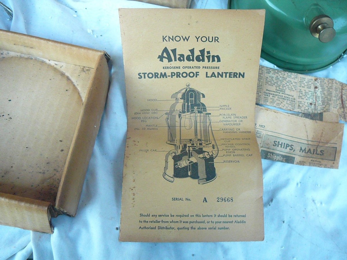

    Aladdin 1A: “Nipple”, “Flame Spreader” and “Vapouriser.

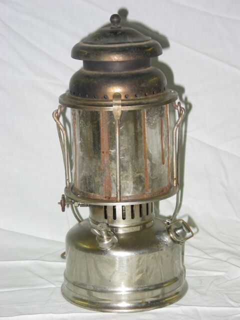

    Yep, I agree. The winged fuel cap is what fooled me. I always did believe the winged fuel cap ones were the first and that photo tends to support the theory.
