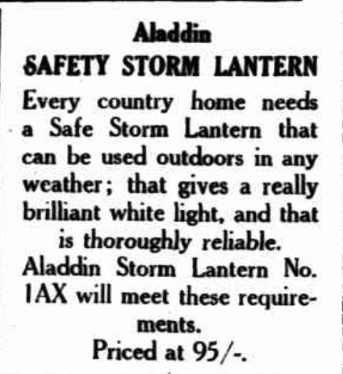

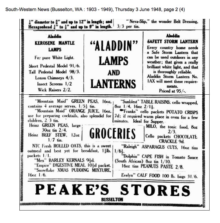

    I have found an ad for the 1AX. It is from 1948. It does not state either kerosene or petrol was to be used.
    I think it should be remembered, it may not have been complete lamps that were surplus. I think it is more likely they had 10's of thousand spare generators with no way to sell them. They would have then simply created a limited edition 1AX and used up the generators they had in surplus, generators intended for the military that were now no longer needed by the military. It may well have taken a couple of years after the war had ended to finalise their surplus generator numbers as by that time I suspect the defence force had stopped ordering replacement genertors
    1948

    Grist for the mill: Snippets of information on Aladdin in Australia as it relates to this discussion.
    1. I found this reference to an Aladdin 1AX from June 1948:

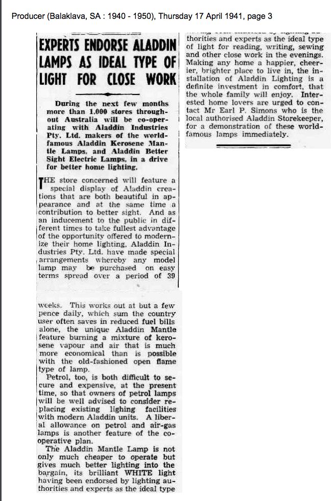

    3. Wartime Aladdin marketing:

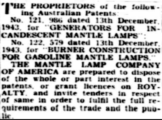

    5) Now here is the kicker. This is an article from 1958 listing patents from 1943 That Aladdin Industries were offering for sale two Australian patents.
    One is for a generator the other a petrol burner.

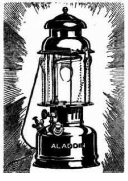

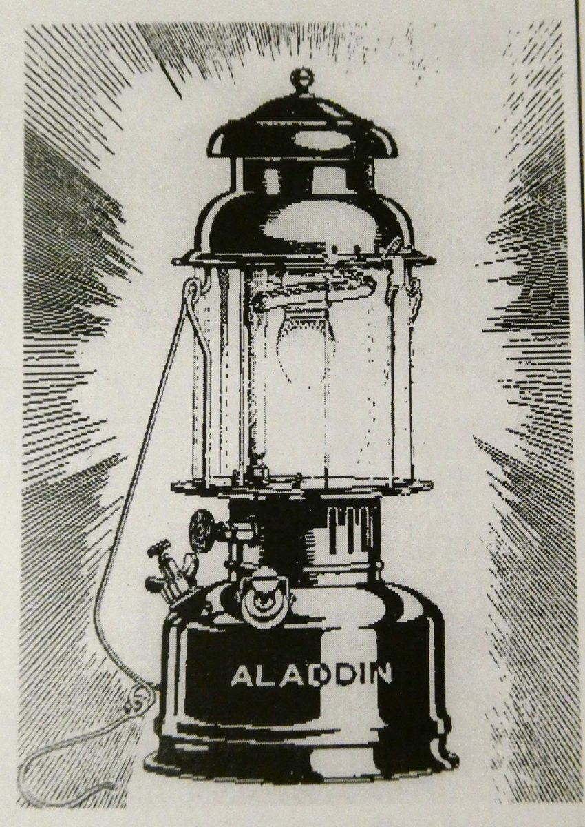

    You asked (somewhere, it could have been over at CCS) about sorting out the Aladdin lanterns in the Reference Gallery.
    I think this illustration (that was used in the 1930s and shortly after WWII) is of a Radius-made Aladdin 12A:
    Remembering it is a commercial artist's rendition of a lantern, it looks similar to @Nils Stephenson's Aladdin 12A here:
    The Aladdin 14A is a different beast with a big, obvious, sliding handle:

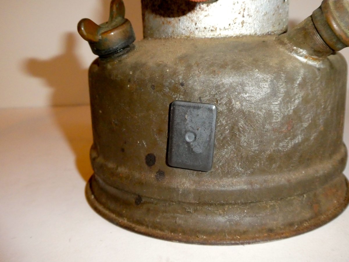

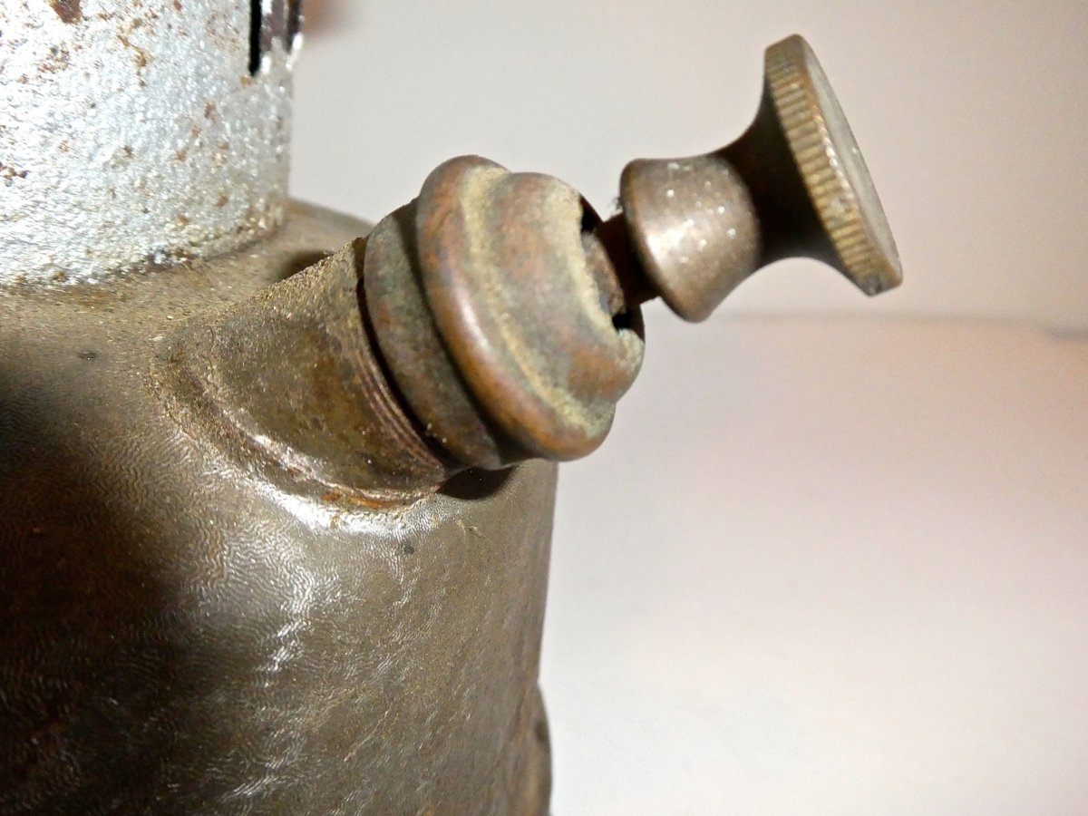

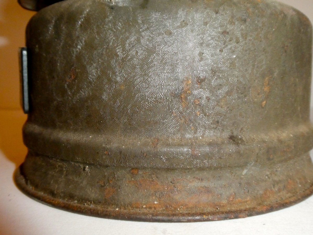

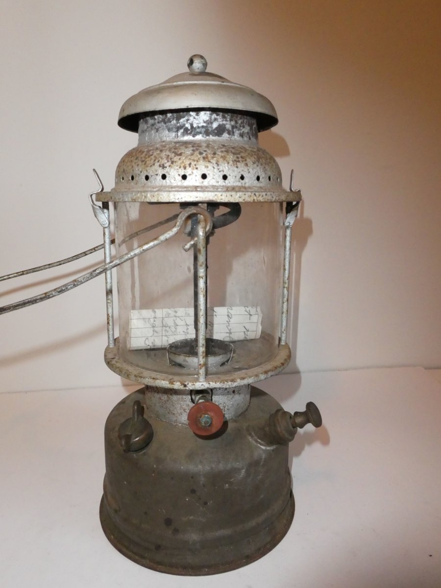

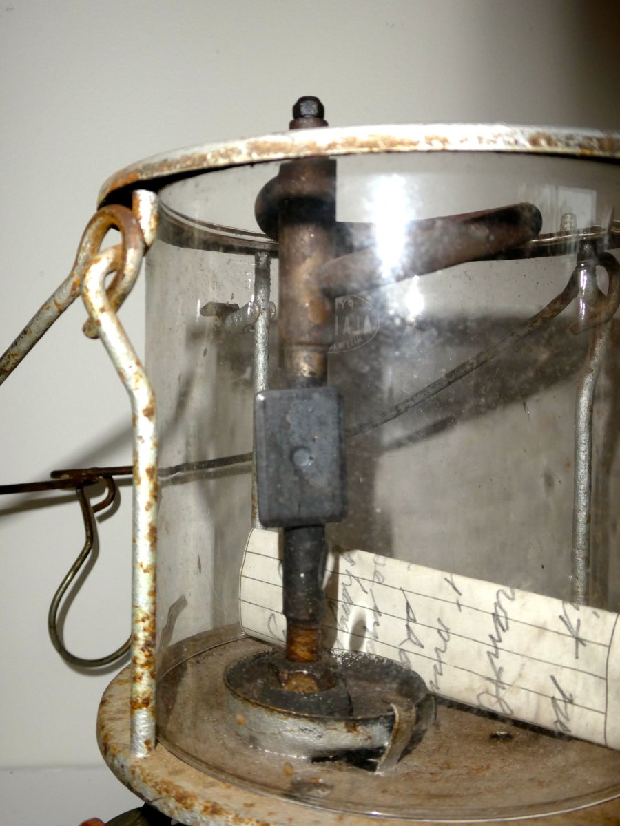

    1. All have the same looking "Preston loop" vapouriser and nipple... except,
    2. Two of the 'oldest' have steel vapourisers (with brass nipples).
    3. I'll stick my neck out and say:
    I think this is the earliest form of the Aladdin 1A, because of the filler cap, the pump locking cap, and the pricker control wheel (the one I'm posting is the one I bought yesterday and it has a steel tank , so I think it was war-issue and the first ones might have had brass tanks).
    Ignore the after-market silver-frost on the upper parts of the lantern:
    Note the green "crinkle" paint.
    Steel tank (the other two I have that look the same have brass tanks).
    Steel vapouriser (two out of three that look like this lantern have steel vapourisers; one has the 'normal' brass vapouriser)
    Note also the clip for the spirit cup.

    I like the thoughts about the 1AX as well. I had also wondered about that and I like Tony's suggestion that it could be ex military stock being sold off.

    @Nils Stephenson
    The Aladdin 1AX boxes were well printed indicating the boxes were made post-WWII.
    Australian companies were also supplying the Pacific nations for decades after the War (Austramax still does). This is speculation (again): Could it be that the “X” was for export?
  26. Nils Stephenson
    3,384
    That's not bad speculation. Tilley used the EX numbering for export only models, so it fits the theme. Could be why we don't see many in Aus.
