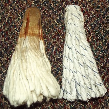

    Miles just sent me this photo of what he's concocted. Here's his process in his own words:
    "The finished production looks like the original but is not as fluffy on the bottom. I used cotton 18 cotton strands from a 22 wick stove set, and that stove can produce over 14,000 BTU/hr of heat, far in excess of any lamp, so the capillary action should be up to the demands of the lamp and yet fit into the cone.
    I used linen thread for tying, and that is a natural fiber. Without a steam compression system and glue that is as close as I can get to the original.

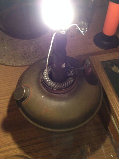

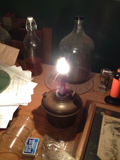

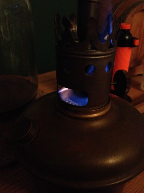

    The new wick from Miles AND the copper screen arrived in the post today. I wasted precious little time putting it all together and letting the wick have a soak in fuel (alcohol).
    I've substituted a piece of fiberglass stove gasket rope as a pre-heater wick with success. The burner is quite vigorous now, and I'm a tad concerned at how hot the tank gets. Comments on that?
    Enjoy the photos:

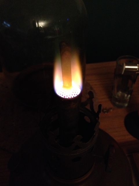

  6. Carlsson
    3,966
    I wouldn't worry too much about the tank.
    they do run pretty hot after a while.
    The whole system works on conducting heat downwards, so it's inevitable that the tank also gets it share.
    It seems like you got it going quite well now.
    The open flame looks a little small and too yellow though.
    Is the jet clean and nice? Sometimes a pricking do wonders on these.
  7. Neighbor Al
    Nov 21, 2011
    1,062
    Russell, PA United States
    The jet "appeared clean" since I could see through it, but I'll use a pricker to look for any stragglers. The flame might have been yellow if the alcohol pre-heat was still burning. It tends to steal air from the mixing tube.

  8. Carlsson
    3,966
    Yes, they are nice.
    I just had an alcohol version running in order to check the tank temperature, and actually it didn't get too hot.
    It was very hot initially, but after a while it went down in temperature.
    Guess most of the heat derived from the preheating.
  9. Neighbor Al
    Nov 21, 2011
    1,062
    Hello Christer,
    I suspect that most of the heat that concerned me was from the preheat cycle. Mine also cooled down to simply being warm after a little while.

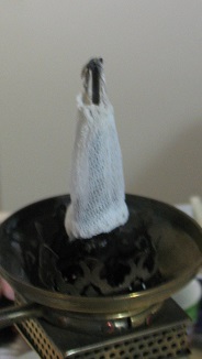

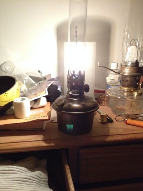

    Progress! I found an appropriate glass chimney for the Titus. (1-7/8" or 48mm OD) I'm visiting a machinist friend during the week, and I'm hoping he can turn down some brass stock for me so that I can make a mantle fork for it. I have two gaslight mantles (not Aladdin) that promise to do well. I'll post the final results in under "Action photos"

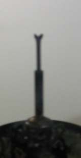

  14. Neighbor Al
    Nov 21, 2011
    1,062
    Yes, that is a 1/8" drill bit providing some heat transfer in lieu of a mantle fork.
  15. tillio
    Mar 24, 2011
    25
    I have a lamp like yours and my solution was to get a 6 inch nail. Furiously hammered the head end flat and then ground a V in it with a file and cut to length. Works like a charm and free. See pictures. As for the mantle. A gent named Thorsten Sherning was kind enough to show how he made mantle. I have the pictures if you want will send them to you.
    Apologies for the blurry photo but you should be able to get the idea.
    Regards
    peter
  16. Neighbor Al
    Nov 21, 2011
    1,062
    Hello Peter,
    Smashing a nail sounds practical and therapeutic, so I think I'll try that before bothering my machinist friend.
