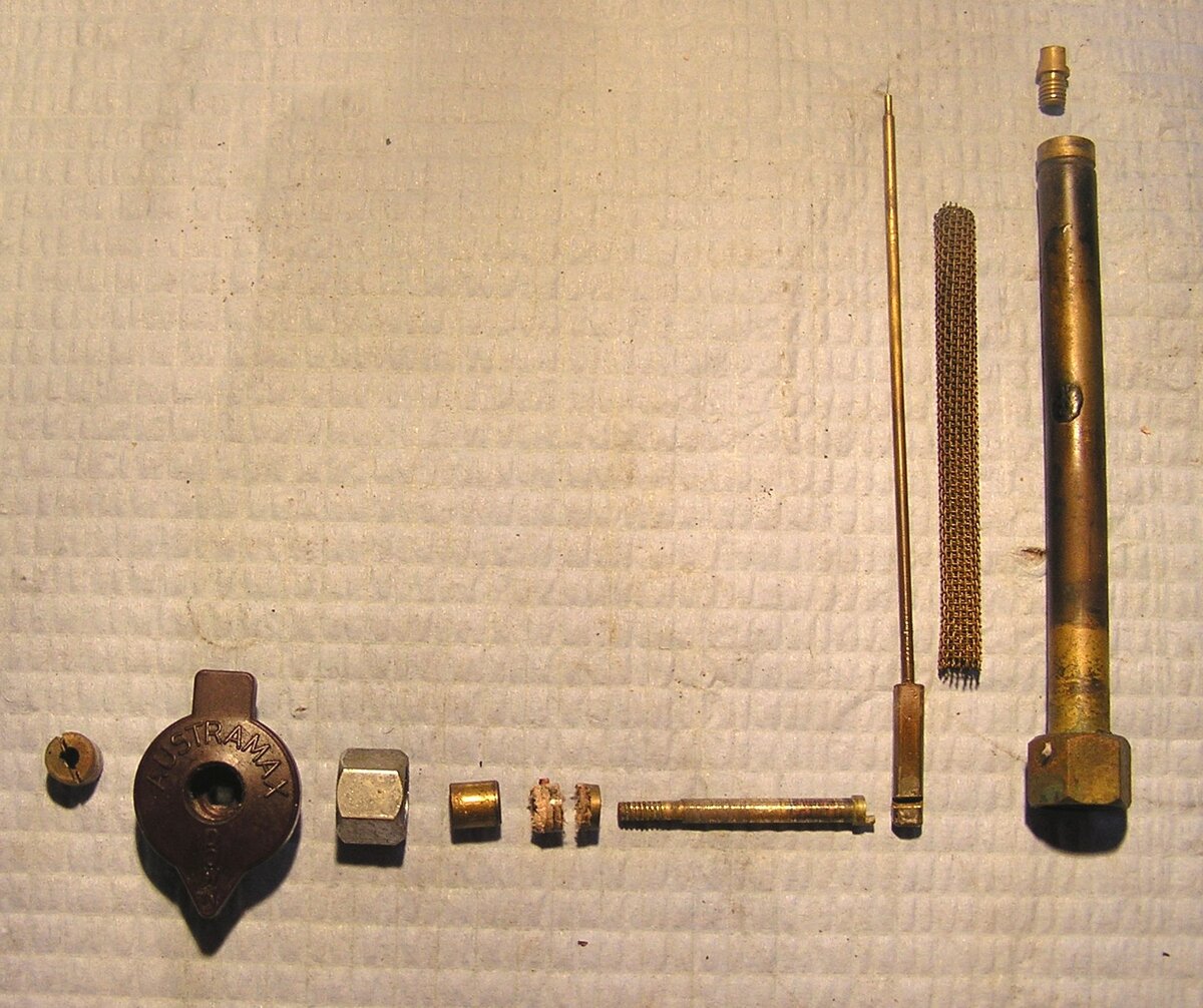

    Received some spare parts recently, including this new Austramax eccentric shaft. It's all one piece, with two O rings. On the left is the old type, with eccentric nub quite worn out, and the removable brass bush. For the old type, the graphite washers, or O rings, go onto the shaft first, followed by the brass bush, then the hexagonal barrel nut. Similar to the Coleman 242 & 249 lanterns. That is, all packing goes in front of the brass bush, and not between the bush and the nut. With new seals it is not necessary to pack the nut. BTW, the brass bush has in internal chamfer at one end; thus it only goes on one way, same as the Coleman.

  8. Tony Press
    Interestingly, I just found an late model Austramax with a new-style eccentric that has only 1 O-ring.
  9. ROBBO55
    4,432
    They probably found one "O" ring leaked, then added the second "O" ring. :-k

    Interesting - ongoing development. I wonder if the machining of the brass bush has changed as well ? It won't need the chamfer at one end any more, for the new eccentric shaft.
