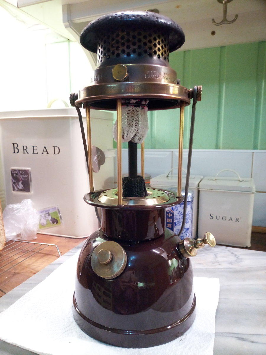

    Preheat and mantle burn in...
    Away she goes!
    Shut down a few minutes later.
    There was a small halo around the mantle so the jet is probably a little enlarged. I've got a few other vaporisers I can try so I'll test those tomorrow, but... there were no stress cracks, no leaks and no loss of pressure.

  3. ROBBO55
    4,439
    Colin, you have done another excellent job restoring this tired old girl. :thumbup:
    And the posting of the process has been a joy to read.
    Thanks
  4. AussiePete
    @ColinG
    Another fantastic job of restoration and the paint job is exquisite, well done. I do like the chestnut colour.
    Another lantern from the past restored into the fine lady she's meant to be. If only this lamp called speak .... what stories it could tell.

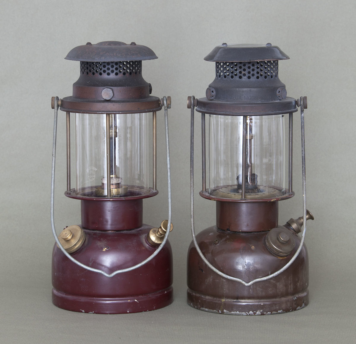

    I think that colour would also be spot on for Vapalux 300?
  8. M.Meijer
    608
    Netherlands
    No; the Vapalux 300 was by and large a military spec lamp that came in various grays at least. In the summer of '44 some new colours for the civilian market were introduced, a cream and brown colour.
    Some can be seen in the gallery.
    According to Ian's book the first very dark, almost brown, maroon was seen on the Vapalux 300 X, that initially had the 300 model tank.
    On this picture of an Italian collector the early, brownish colour, is seen on the right.
    To differentiate, no model 300 had a 'filligré' ventilator as introduced with the 300X as seen here, but had a vertically slotted one.

    You seem to have a close match here Colin.
    I am interested to see this tank outside with daylight, on an overcast day preferably.
