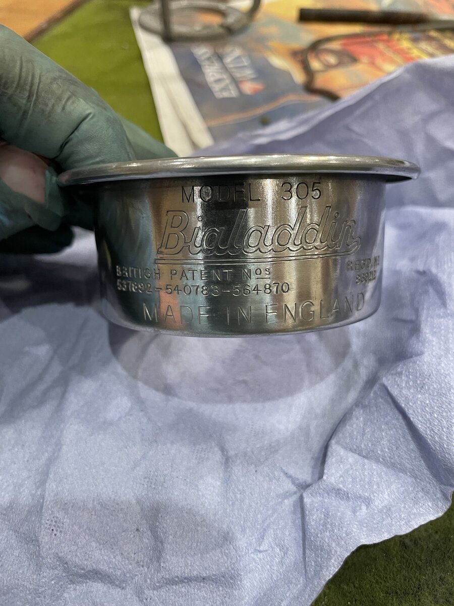

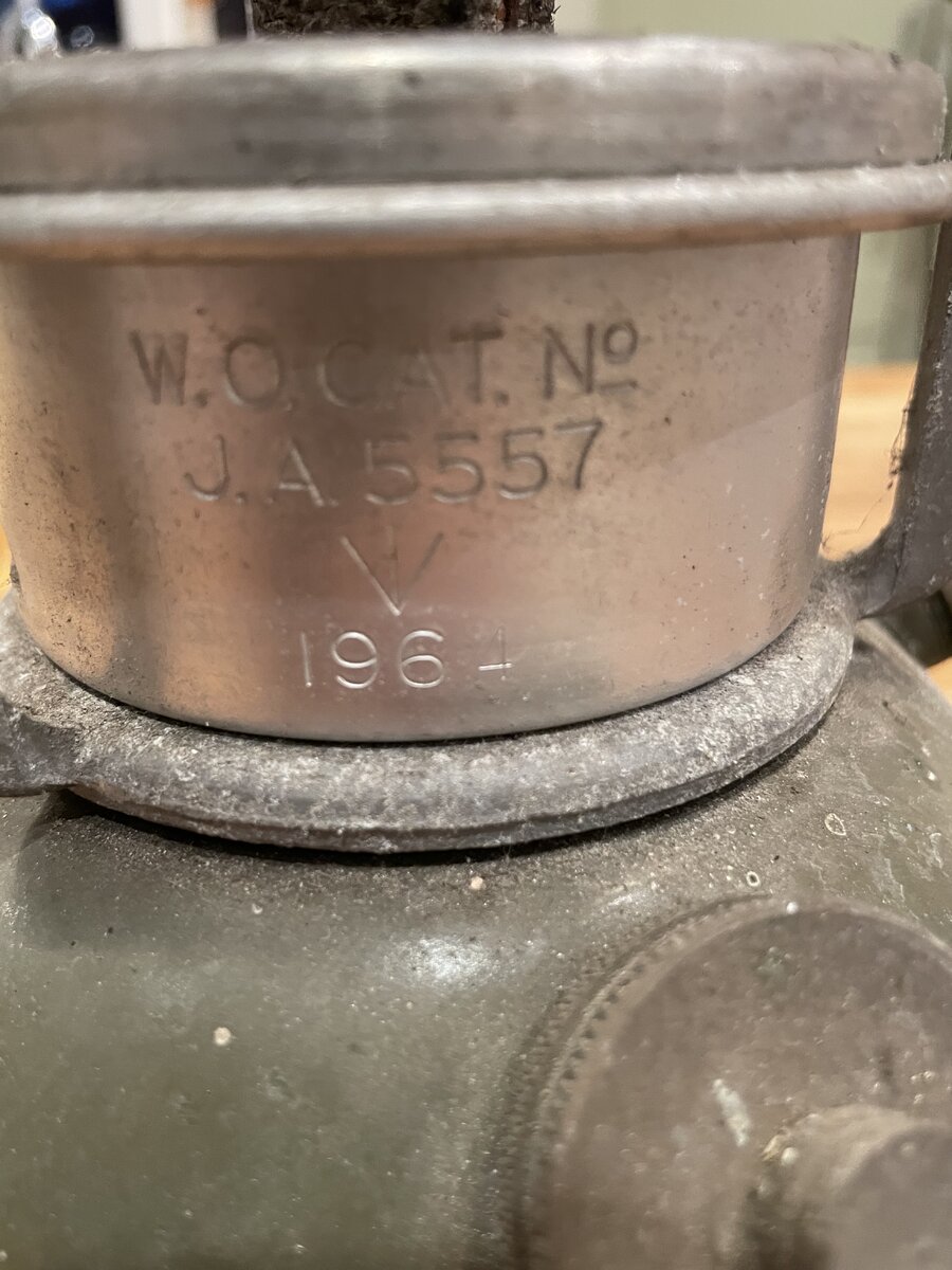

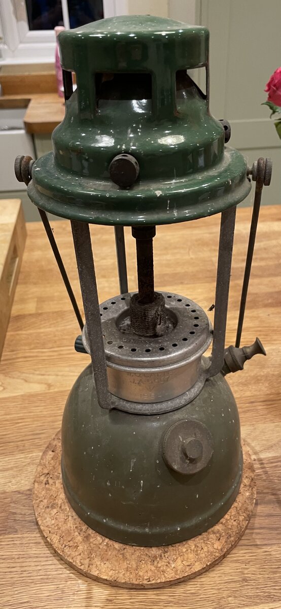

    So I’ve picked up some more lamps , the Tilley’s I’ll post separately
    Can anyone shed any light on this one it’s a Bialaddin 305 from 1964 , I know nothing , zero , absolutely zilch about them having only really looked at Tilley lamps thus far
    I'm assuming like all lamp it’s worth restoring ?
    Are they desirable ?
    Where do I start ?
    All advise gratefully recieved
    thx

    Vapalux and Bialaddin and Imber research products were all made by Willis & Bates in Halifax in Yorkshire, the build quality is good and the designs are simple.
    This link shows the relevant book.
    Books
  3. ROBBO55
    4,317
    @Beanie , a nice find and definitely worth restoring.
    New seals, clean and polish should result in a good lantern.
  4. Gary Waller
    Apr 3, 2018
    618
    That's a nice lamp IMHO do not restore it, give it a good clean and I recon it will come up really well. Glasses are available as are replacements seals.
    Only my opinion, good luck.

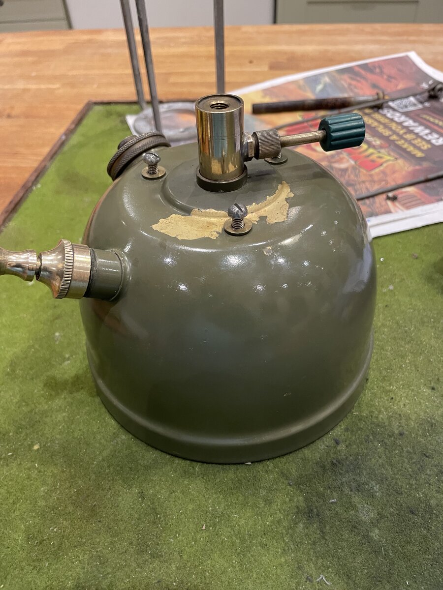

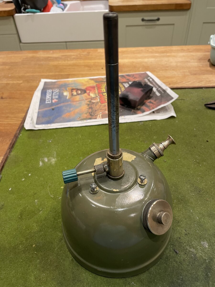

    So a sensitive recommissioning has begun
    The tank has some paint flaking , but is limited to under the frame .
    The tank has cleaned up well , some areas where the paint is thin from use I suspect as it’s around the filler and pump
    control valve cleaned of grime and the vaporiser has cleaned and rust removed needle moves freely and is clean
    Hood is in great condition , I’ve cleaned the burner , but not excessive , IMO it should not be shinny on this lamp , the brass air caps have been cleaned but not polished IMG_5967.jpeg IMG_5966.jpeg
    I don’t know what you call the Aluminium parts other than one is the spirit well , here I’ve removed the Asbestos wick and made one from glass fibre seal
    Glass is due tomorrow and hopefully the full seal kit and V42 mantle so I can assemble over the weekend
    Test burn without a mantle and then hopefully the money shot

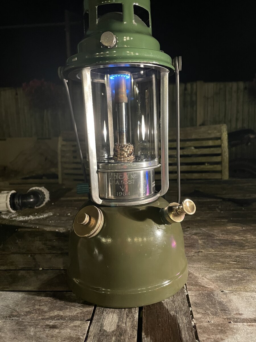

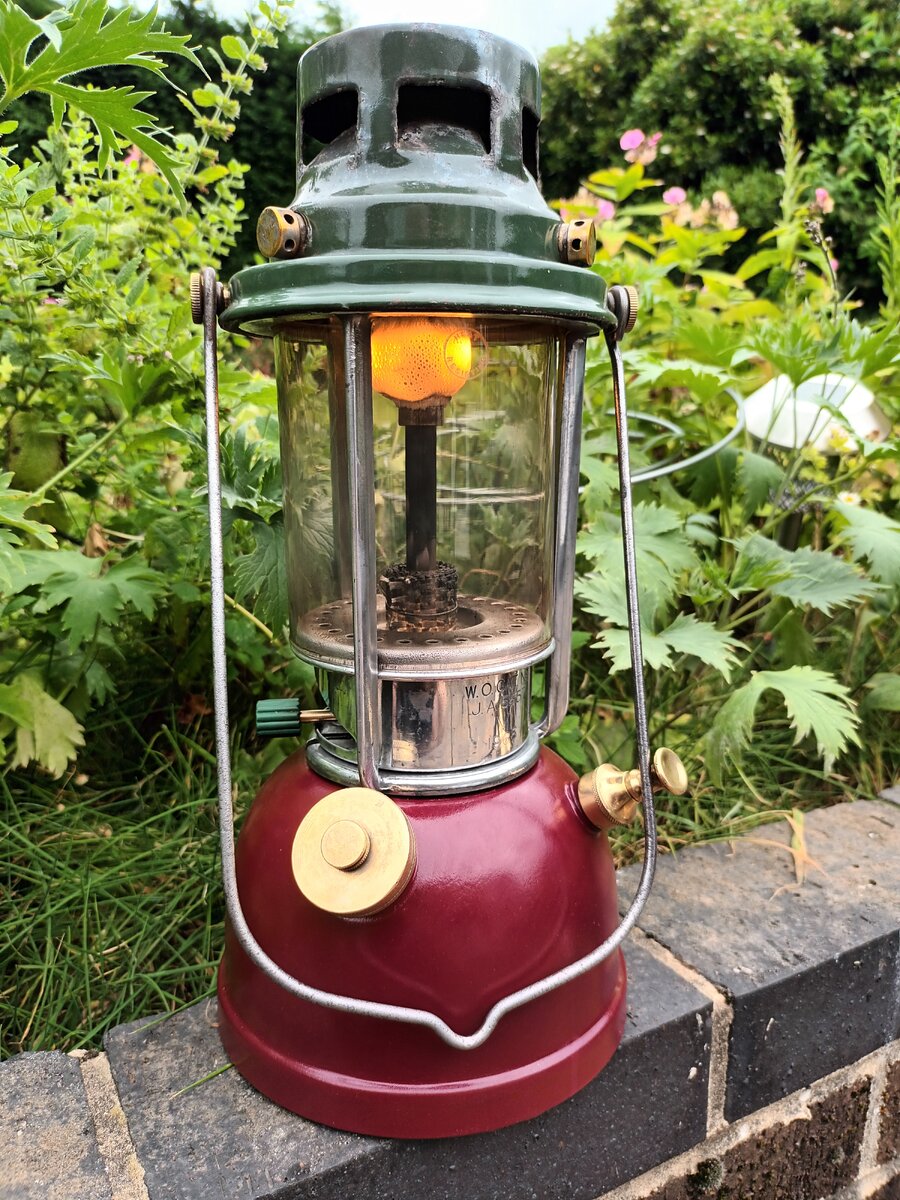

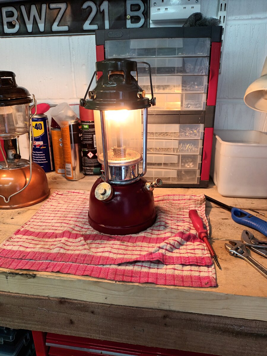

    Reassembled
    Is this how the glass sits , not in the lip of the preheater ?
    Running along side my X246B
    I am getting a bit of “suck back” on the pump , is that likely just to be new seals bedding in ?
  13. Gary Waller
    Apr 3, 2018
    618
    Lamp looks great.
    Those non return valve seals can be troublesome to seal especially when new, sometimes take a bit of bedding in.
  14. Beanie United Kingdom
    Mar 2, 2026
    40
    United Kingdom
    Thanks Gary, will see how it performs over the next few days, I didn't really fancy emptying the tank to remove and strip it, fingers crossed its just the newness wearing off :)
  15. Gary Waller
    Apr 3, 2018
    618
    If you release the pressure screw and give the pump a few swift and firm presses that can help re-seat the washer.
