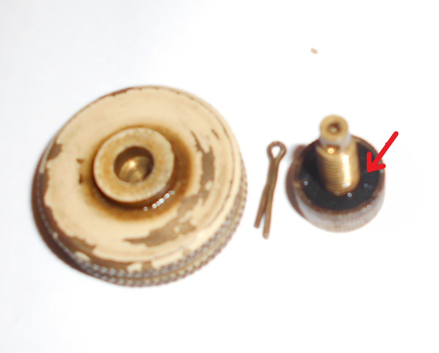

    Hi David,
    i know the blue knob is the wrong one, but you see...;)
    Regards, Frank

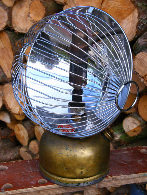

    Another advantage of the Bowlfire is that it takes the £4.99 Lidl Fruit Bowl guard without mod. :content:

    As expected the very bright blue was blue electrical tape.
    I have no idea why it was put over the knob. Underneath was a nice green knob.

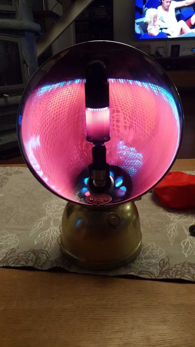

    So, it's months later and I'm finally back from the ship. First job on the list is to get the bowl fire working. It is the middle of Summer but the evenings are cool in Estonia.
    Had a fuel issue at first but got that sorted.
    Lighting these things is.....interesting! Fireballs going everywhere. Think I have the knack now and managed to keep one eyebrow.
