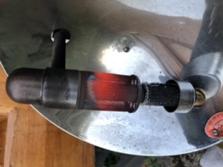

    Good evening - I am new to paraffin lamps but am slowly building a collection of old Tilley’s, Bialaddin and Petromax lamps. I have just bought a restored Mk2/3 bowl fire and it is exhibiting exactly this behaviour. All starts fine and clear blue jets from the underside of the burner which, after a few minutes, become unstable and slowly descend before going out and producing lots of acrid smoke.
    Like other posters here I have tried more, less pressure but the same happens every time. Can anybody help?

    The flame slowly decends

    Hi Nick! Welcome to CPL! :)
    You say that it has been restored...Does that mean just new seals? ...I would start by emptying the paraffin and doing a 'dunk' test to test for air leaks.
    If that is ok then and assuming the burner is free from blockages/spider webs i would look at the vapouriser...gently remove the needle... is it clean or does it have a build up of carbon? ...If it does then you could try cleaning it out by gently tapping it on a piece of wood to get any carbon out..Heating and quenching may help followed by more gentle tapping, but you may need a new vapouriser?
