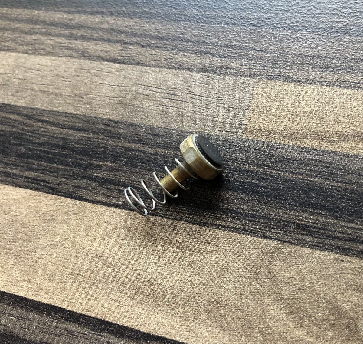

    Yes I did replace that piece of rubber, I do notice it sits below flush on the brass cup that holds it, perhaps that's what's causing it to leak?
    edit: Doh, I realize I got the pip and cup mounted backwards....
  2. podbros
    4,110
    Ok looks like you may have solved it but the seal should sit at least flush or slightly proud ?
  3. ColinG United Kingdom
    4,816
    Aha! That'll probablybe why! Easy to fix as well!
  4. Fireexit1 United Kingdom
    3,538
    You can test it outside of the lamp. Should make a noise only when you compress it. Make sure the spring is the right way up and is not "kaput". Below flush in the cup is not an issue, not sitting flat in it can be.
    Occasionally the pump tube can split, but it is 99% of the time the valve. If you are convinced the valve is OK then remove it hold your finger over the end and pump it underwater to see if any bubbles appear where they should not.
    EDIT - xd in post !
