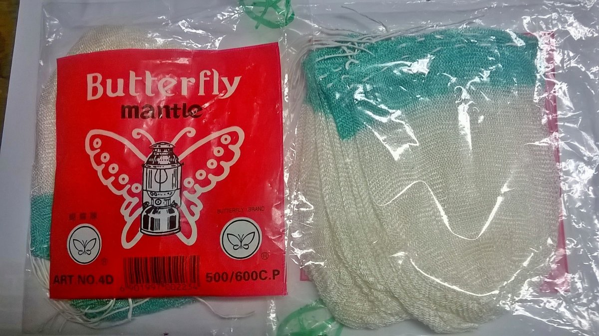

    An envelope with 30 Butterfly 4D 500/600 arrived today from China.
    No indication wether radioactive or not.
    Can't measure it. These U shaped 4D are much larger than the bulb shaped 41.

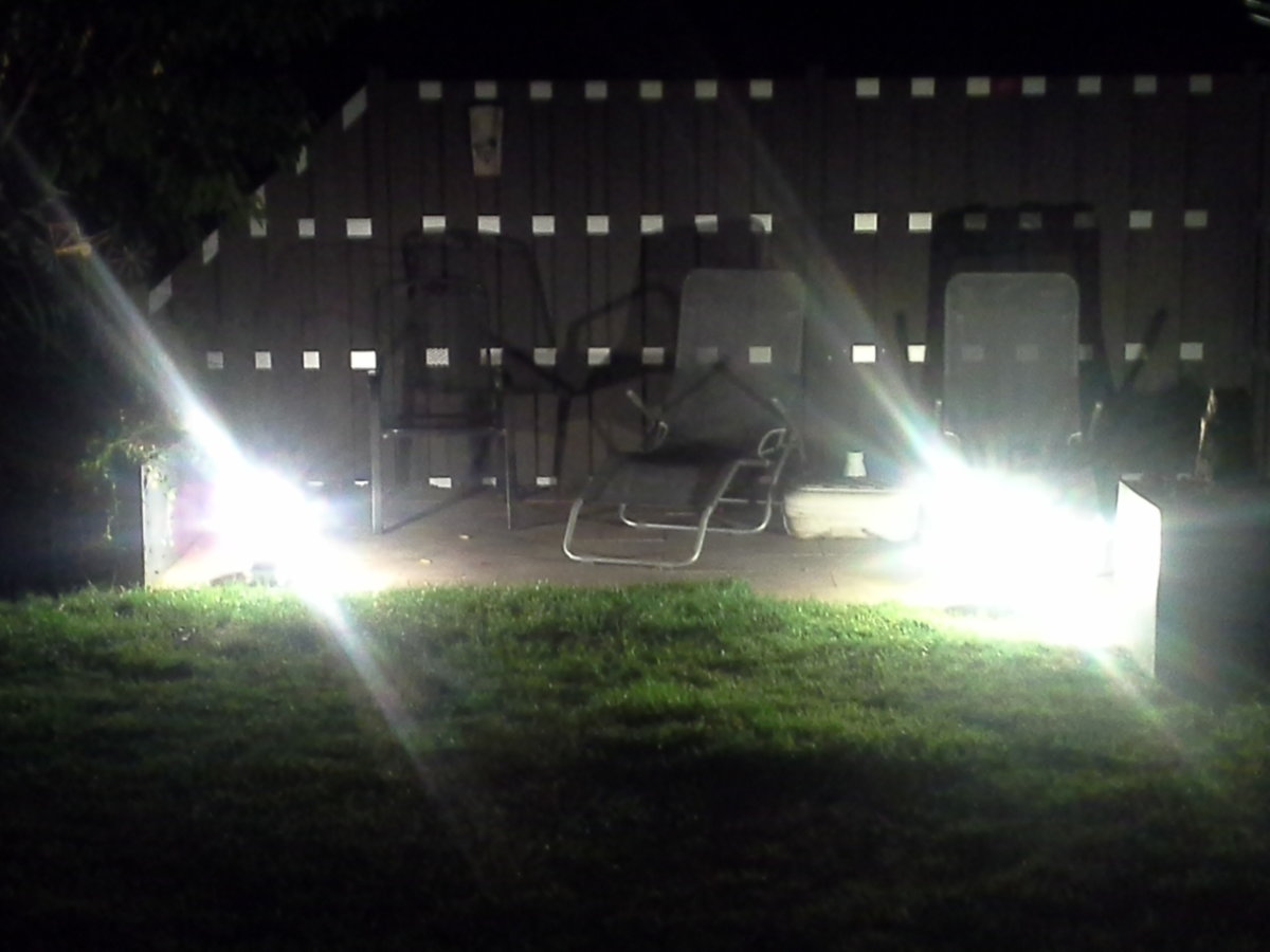

    I can confirm,
    the Butterfly 4D are as bright as the blue Peerless no.3
    Both 500cp mantles.
    See, on left Peerless, on right Butterfly 4D. Both Petromax 500, kero.
    Regards
    Willi
