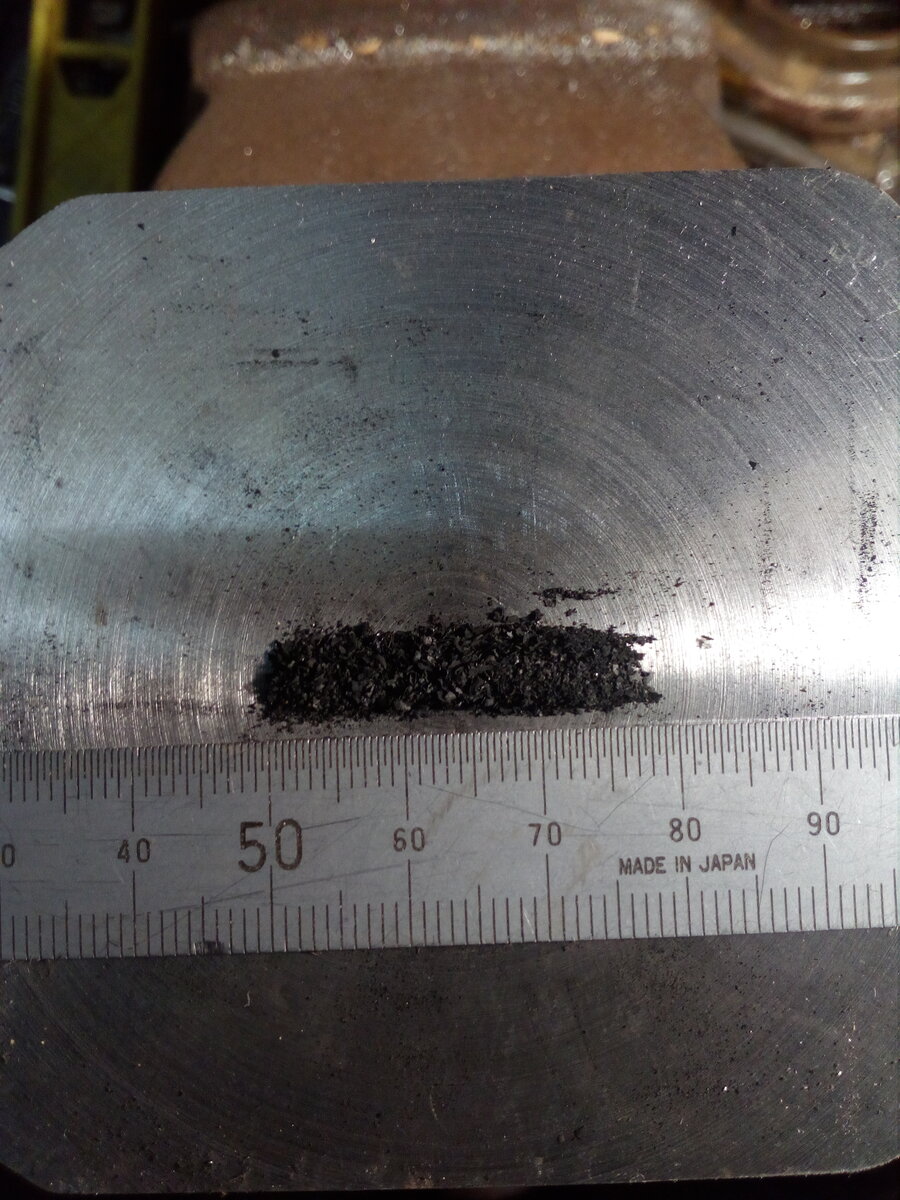

    I have cleared a vaporisers by heating to dull red and dropping in water. (The outer alone ) then tapping the outside with a 1/4 steel rod .
    One more heating to make certain NO moisture remained.
    This is the carbon from 1 vaporiser .
