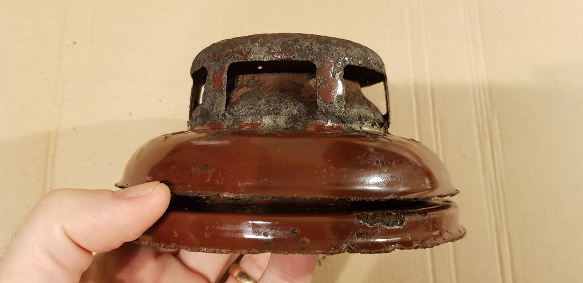

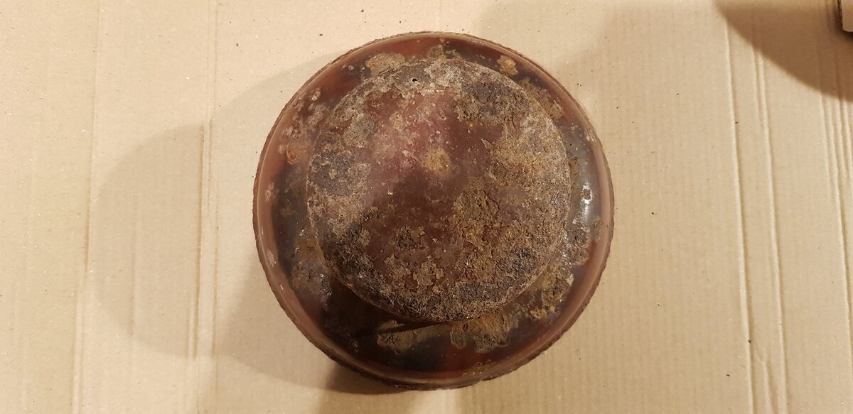

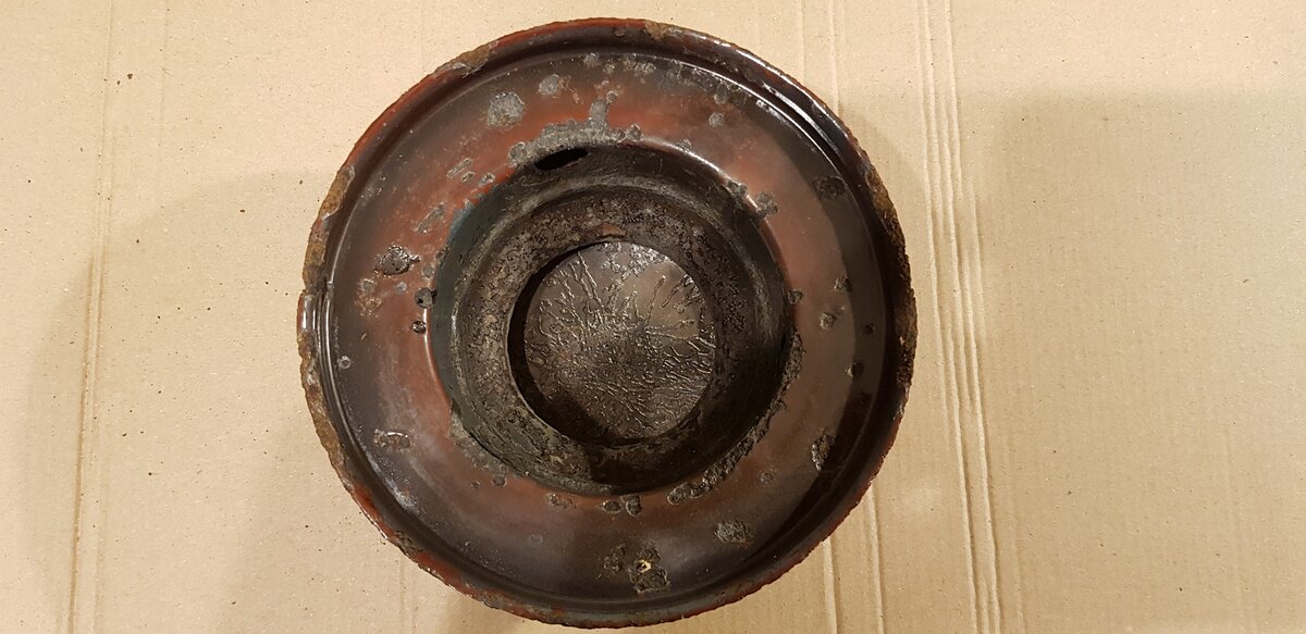

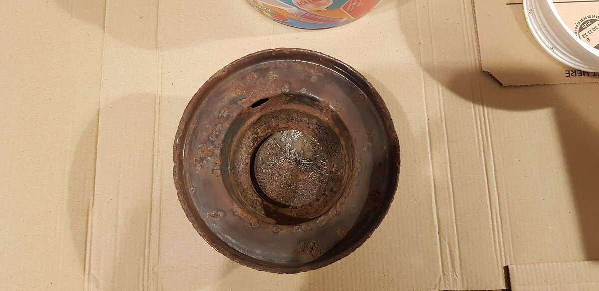

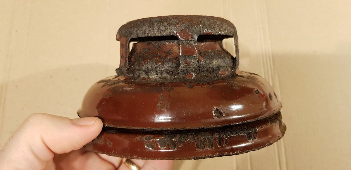

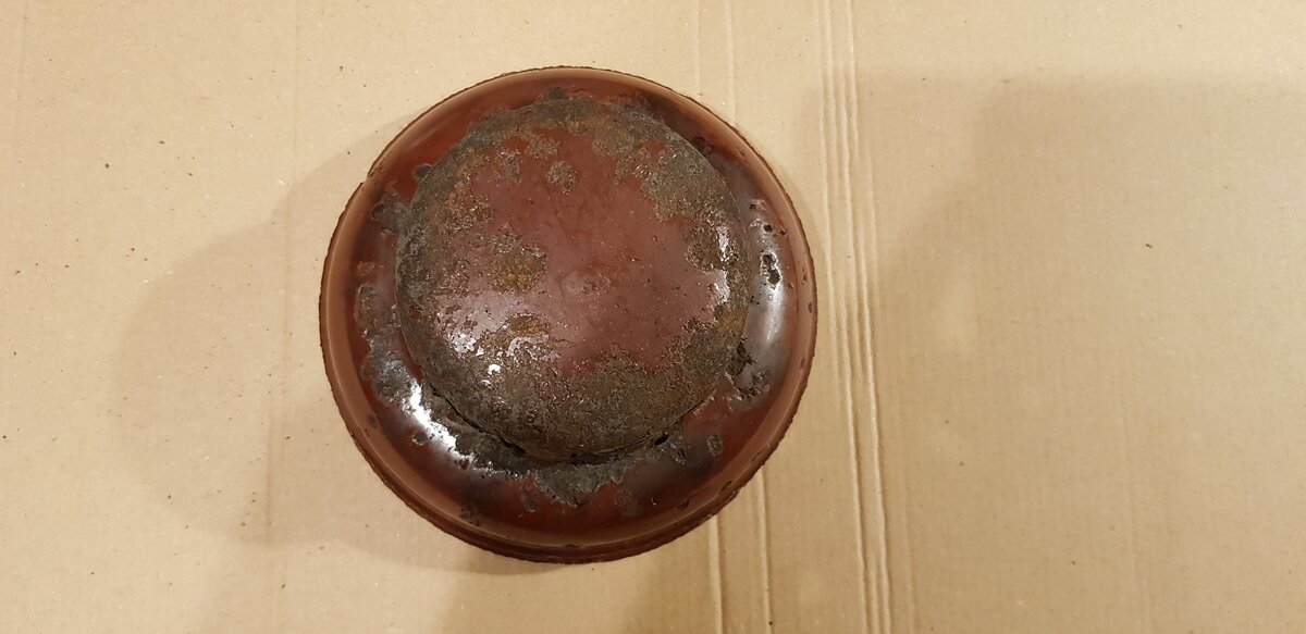

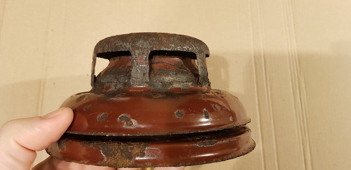

    After getting sidetracked by real life, and other piffling issues, I started work on the hood. It's in such poor condition that this is about damage control more than anything else. I considered vinegar or citric acid, but decided to go with a litre of Evaporust. In the end a litre was only just enough, even when using a small container into which the hood fitted neatly. I will definitely go with a 5L can next time. I put the hood in at 10:30 in the morning, and left it for 12 hours.
    Here are some "before" images.
    20201125_102420-50%.jpg 20201125_102448-50%.jpg 20201125_102441-50%.jpg 20201125_102434-50%.jpg 20201125_102414-50%.jpg

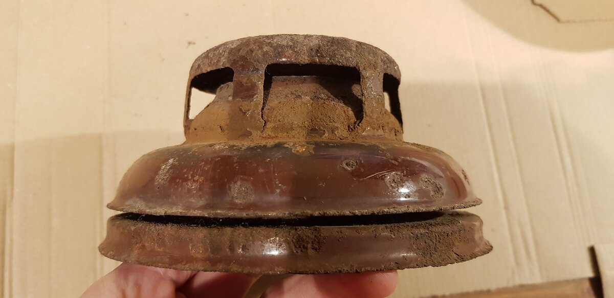

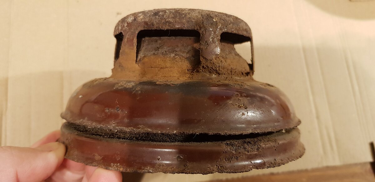

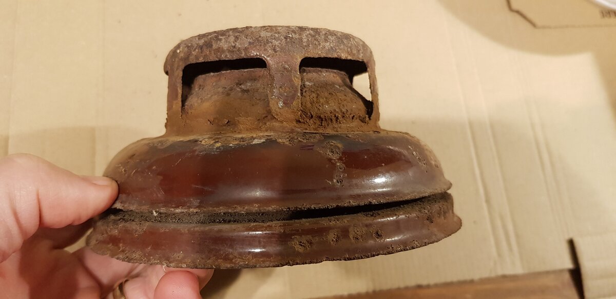

    Here's what it looked like "after" the Evaporust treatment. I'm quite pleased. It has not achieved miracles, but I wasn't expecting any. Overall it looks a lot cleaner. One day, if I see a brown hood in super condition, I may snaffle one for this, but as this lamp has personal significance for me (warts and all) I don't want to make indiscriminate wholesale changes.

    Nice! I'd give that a go on a wire buff to even out the pitting and then a spray of high-temperature clear lacquer, that will help stop the corrosion reappearing after burning.

    It does exist, but it won't do well at the temps the vent reaches in my experience. Yellows and gets a burnt look. It does well on an engine block at the temperatures those hit.

    You could treat the remaining rust with rust converter. Phosphoric acid - it used to be called Jenolite in the UK. This turns it black and sort of rust-resistant. Wash off excess with meths before it dries.

    You did right by using Evaporust rather than any acids. Acids tend to haze up vitreous enamels.
    Is the fount coated with brass/gold paint or is it bare brass? If its painted, and you want to preserve it, don't soak it in citric acid or vinegar. If its bare brass, no problems with citric/vinegar. Just not too long.
    You can soak the steel cage/frame in citric acid. You can dilute it a bit according to your preference. I've soaked rusty steel parts in very concentrated citric acid before. It does no harm even after a couple of days. It'll completely remove the heaviest rusts down to the tiniest crevices(but that's after 48hrs).

    I would call that vent an absolute success, run it as it is. Maybe carefully condition the bare spots with some oil as you would a cast iron pan.
