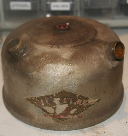

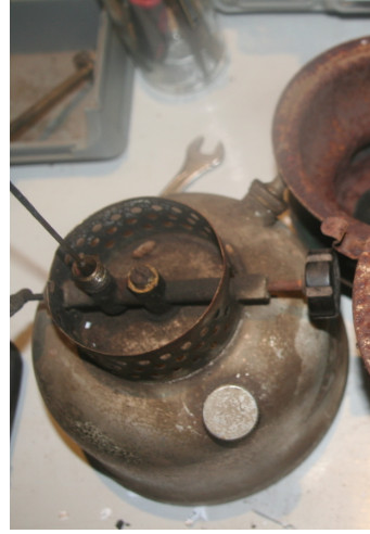

    Here is a tank that arrived today in a very ordinary state. If you blokes can think of a better way to get better results in 30 minutes - give me a hoy.

    Far out!

    As my Chinese mate would say, Ed Zachary.
    I just don't understand how much easier, cheaper and better results can be done. To me, re-usable, non toxic, very cheap vinegar - simply can't be beat. I realise people will still do their things their way, I respect and understand that. Anyone that is beginning their collecting career should look at the results and at least try it.
  13. ColinG United Kingdom
    4,815
    Wow, that's an amazing result!

    The really impressive thing about this lamp is, it was a working lamp for a long time. It has had a lot of use. Despite that use, there isn't a dent in the fount. Everything seems to be there except a cup for the pump.
    Any lamp that is troublesome would never have been used so much. I'm starting to be converted and think these lamps were easy to use and ran well. I have passed on quite a few very nice Veritas's over the years because of their bad rap. It actually annoys me I didn't at least buy one of them and see for myself. I'm not into lanterns so the bad rap excuse was a very easy one to use against myself.
    The cage and the part that the green enamel hood sits on have lost all their nickel and have a lot of rust on them.
    The green enamel is in poor shape and that is one of the reasons I opted out of collecting lanterns. A lot of them have enamel and I can't stand the sight of bad enamel - which most enamel is, bad.

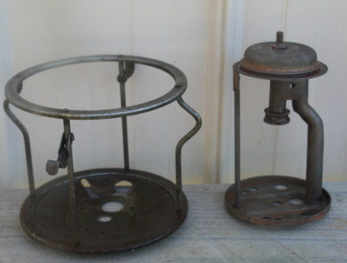

    Pete, you won't be sorry. Don't be afraid to leave non plated parts in overnight or even days. Some heavy rusting can take a couple of soaks over days.
    The vinegar has an outstanding effect on the grime build up that usually consists of layers of dust that have hardened over the many years. The dust slowly but surely builds a pretty tough film.
    This was really oil caked. Old kerosene that had been heated and baked by the lamps use over a long time. The sum effort to get the assembly clean was to drop it into used vinegar and the next morning, spend perhaps 30 seconds rinsing it while using a small wire brush. It really is that simple. You don't need to boil or use vibrating doovers or make any special concoction up.
    As an aside, I wanted to point out the A stamped into the assembly. I'm sure everyone knows that but I'd thought I'd mention it. I think from what I have seen, the A and C lamps were mainly sold in Australia.

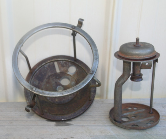

    The cage has come up well. It was very rusty. Looks can be deceiving I need to add here. What looks like rust on the base plate of the cage is some type of material applied at the factory. My guess would be tin. It is also on the bottom part of the cage struts.
    The cage was in vinegar overnight. I rinsed and brushed the cage this morning, which removed the top layers of rust, then dropped it back into the vinegar. I just pulled it out and brushed it under running water and the cage is finished. Having said that, I do think the cages came with a silver paint on them. I can see remnants of that silver paint. I will seek advice from you Veritas nutters.
    Here the cage is next to another burner/cage assembly that was very rusty. Don't be fooled by the ring of rust on the other burner, I just didn't rinse properly and it will wipe off.
    It seems I forgot to take a photo of the cage prior to treatment. Bugger it.
