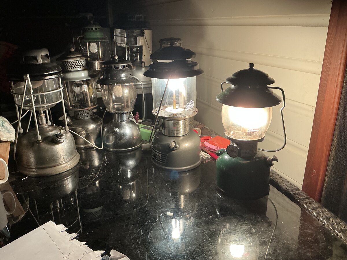

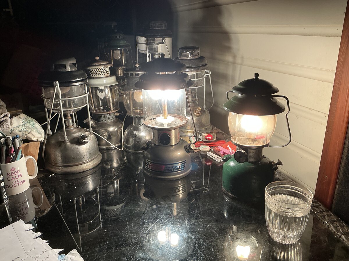

    two pics for comparison….30 minutes apart. The 295 on the left has gasoline now, instead of Shellite. ‘it may be less obvious, but the gasoline has produced a much brighter light. I’m looking at the pics and it is indeed not very noticeable…but it is very much brighter with the gasoline than the Shellite in real life. I apologise for the picture quality…they have not shown what I can see with my eyes.
    edit…. The top pic shows the bright ULP burning.

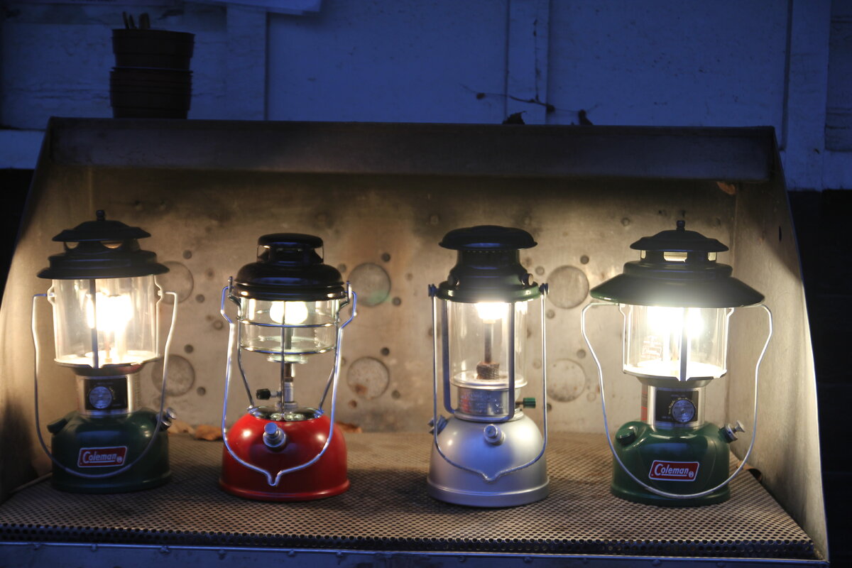

    Below are my Coleman 22J and 228J, with my Tilley X246B and VapaluxM1, both running well as you can see:-
    Tim

    There should be no reason for Shellite to be less bright than ULP in any given lamp. Shellite/Naphtha is gasoline without additives. You may have managed to clear some crud somewhere in your working. Your lamps are burning well.

    The first Couple of runs with the rebuilt 295 were not great…yellowish glow from both mantles despite regular tip cleaning and ample pressure. Then it just got bright on the next two runs…once with Shellite, and then ULP. So it is likely as you suggest Tony, probably gunk cleaning out of the new pickup or valve tip…something like that.
