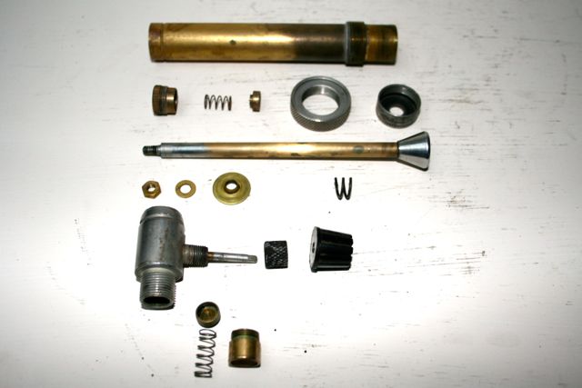

  26. Tony Press
    MG
    If it is leaking through the centre hole where the pump rod enters the pump, then you either have a faulty NRV (see again the advice above) or a crack in the pump tube (as Phil has said).
    Read the advice agin above and make sure that all parts of your NRV are clean and free from grit.
    Your pump should look something like this (with the addition of the correct washers and seals):
    If you are a subscriber to CPL there are catalogues in the Reference Gallery that show the detail of the components.

  28. jjcpl
    Nov 29, 2013
    24
    Is the 201 running?
    I have been looking at a broken Tilley pump on my bench for a long time, the picture may come in handy.
