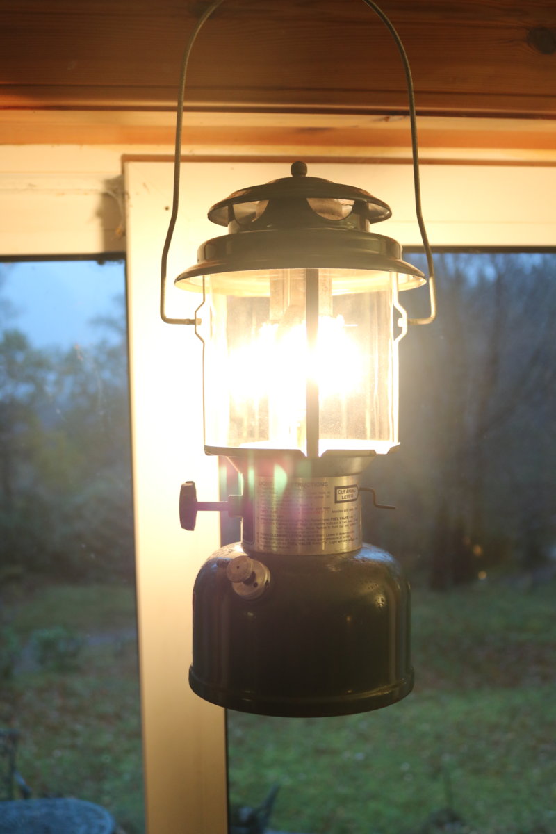

    Hello again everyone.
    I'd given up on the 220K but having fettled everything else and coverted a couple of other Coleman lanterns I thought I'd give it one last try. The first thing I tried was to pump it up with nothing in it and sure enough I felt a good strong blast of air on my lips! So, if it can blow air through it MUST do the same for fuel, so I put it back together again, filled it with fuel, fitted two Butterfly mantles and burned them off first. Then, after 40 initial pumps I let the fuel through and she burst into life. I opened the valve fully and pumped like stink as David suggested and now it's working perfectly!
    I can only conclude that it was either:
    1. Operator error.
    2. A minor blockage that cleared itself.
    3 Both of the above.
    Anyway, I now have a Coleman 220K whispering quietly to itself providing a good, strong light. This is one Coleman I will NOT be converting!
