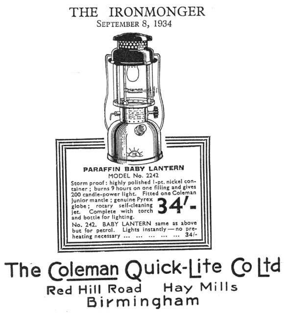

    Redhill Road, Hay Mills, Birmingham - also home of Monitor Engineering & Oil Appliances Ltd. Given the Monitor/Coleman collaborations (some variants of the Solus stove? Blowlamps) elsewhere is there a connection here?

    Thanks Tom and Henry. Now I’m confused (I can hear the chorus - “no kidding?), Neil’s first illustration shows no wheel and second does so maybe I just need that repro without the wheel?
  22. Mackburner
    2242 is a modification of a standard 242 and that model never had a pricker control with a wheel. I would not therefore expect 2242 to have the wheel either. I don't know but I believe 2242 pre-dates 242K by a year or so and was therefore manufacturered before Coleman made that pricker control with a wheel. ::Neil::

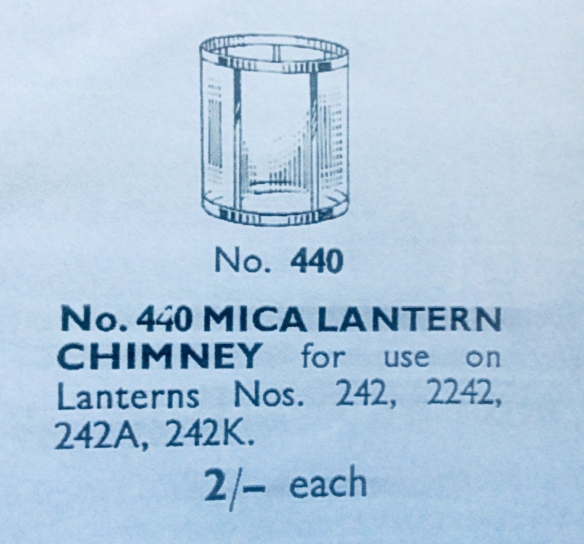

    D4C0954E-C9A3-4382-BDB0-04677BE136D5.jpeg Neil’s illustrations show the 2242 with a Pyrex glass globe but I’ve just found this in a 1936 Coleman catalogue.
