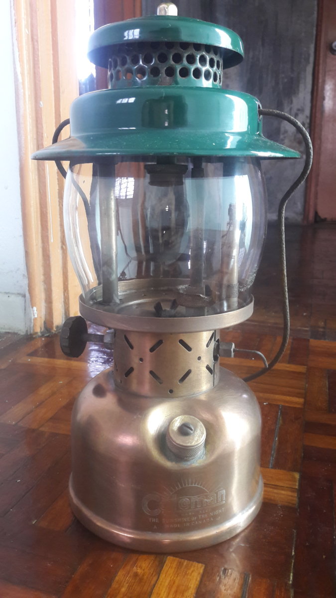

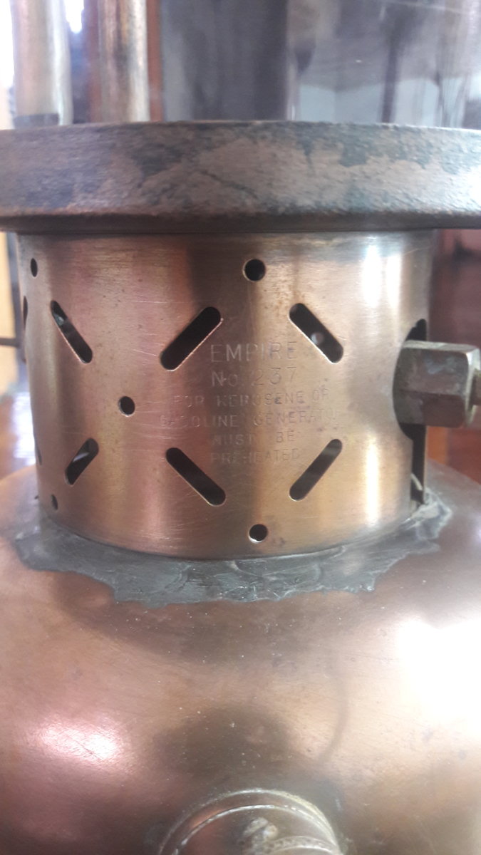

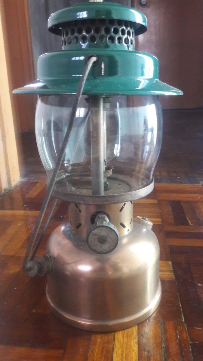

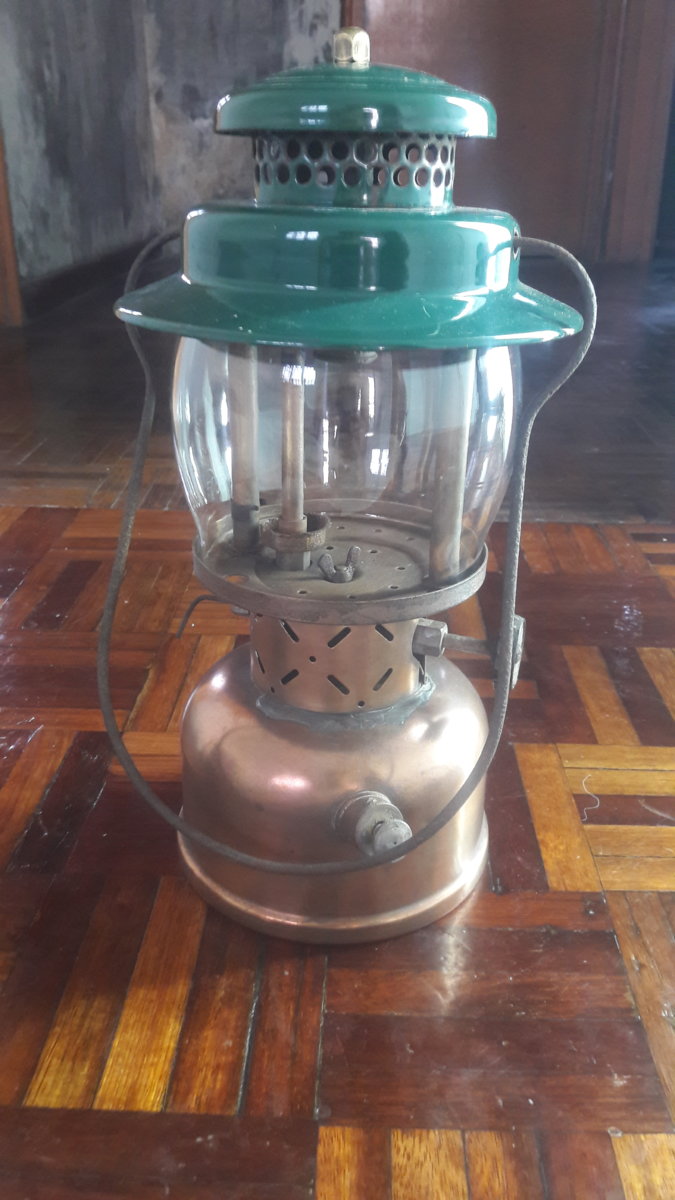

    I've recently bought a Coleman 237 Empire as shown in these attachment. Still unfettled, as it is now. How would i know anything about its age (year it was made)?? Its stamped Made in Canada with the word "Empire" and Sunshine of the Night on its fount/tank.

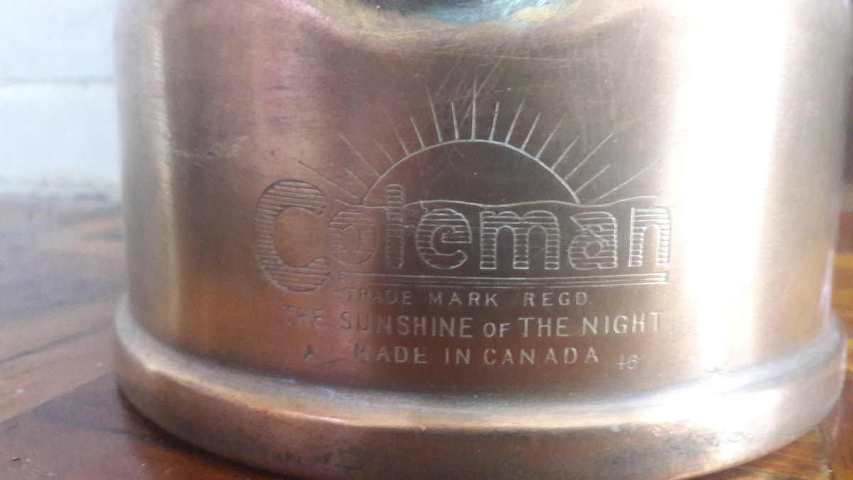

  7. MYN
    Here's a closeup view on the fount's stamping.

  8. Lamp Doctor Australia
    Jan 3, 2013
    622
    Geelong
    Date is A first 3 months and made in 1946.

  10. phaedrus42
    phaedrus42 Subscriber
    2,056
    Hi @MYN , according to the date, your 237 fount and collar were originally painted Canadian Seafoam Green and were never nickel plated.
    Interesting that yours has a dark green enamel ventilator rather than the light green one.
    I see it also has a rare and fragile ceramic burner cap. Most had the brass burner cap with wire mesh screen.
    They are really excellent lanterns, meant to burn paraffin/kerosene but could also burn ordinary unleaded gasoline.
    Any Coleman 220 type "ball nut" will work for the nut on the ventilator.
    If you decide to paint the fount and collar(frame rest) I can recommend the American "Rustoleum Grass Green Gloss Enamel" as a very good quality spray paint that is almost identical to the original colour.
  11. MYN
    Thanks Phaedrus42. I'm not sure whether it had any nickel plating originally or had been removed earlier by the previous owner. Neither am i sure that it should have had a seafoam green or dark green enamel on the hood. Its my 1st Coleman lantern. Haven't read up enough on the details yet. The spirit cup looks so worn-down that it would not hold more than a few drops of methanol.

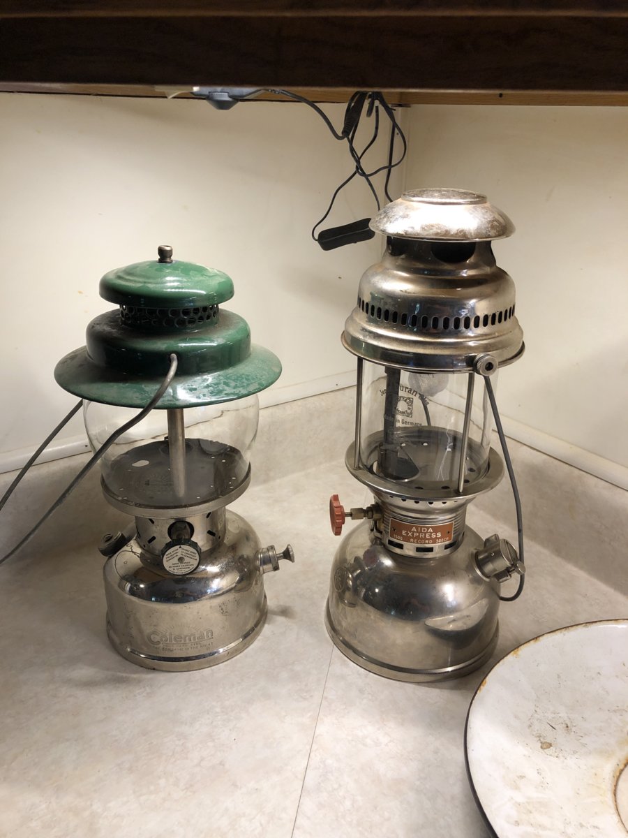

  16. Eric M United States
    Jun 29, 2019
    1
    Knoxville,TN
    image.jpg I’m curious as to the real cp rating of the 237 Coleman’s as I have 3 of them , I also have 3 Aida’s as I do some night fishing off some Florida bridge’s I like them all but the Aida is a far brighter lantern more white light, no joke if your using the 237 down from me on the peer & I put my Aida’s out I’ll draw all the bait from yours to mine, now as for camping on hunting trips I love my 237’s as the light is more easy on eyes.Aidas are a little easier to start up with the built in torch,it draws everybody’s attention,I’ve got the best of both worlds.p.s. I’m rebuilding 2 237’s to sell with new generators & gaskets
  17. MYN
    Both the Aida 1500 and the Coleman 237 are rated at 500cp. Perhaps 550cp.
    They usually won't really make up to those figures if you measure with a Luxmeter.
    The Aida has a mixing J-tube which is somewhat larger and longer than the 237. In combination with its more efficient (Preston loop) generator, I guess that you're likely to get a more superheated, higher velocity vaporized fuel jetting across the air intake. So its likely that the unit gets a better aspiration and better mixing of the fuel and air in the longer mixer tube before they exit through the ceramic burner nozzle. Therefore, chances are, they often burn brighter than a non-optimized 237.
    But on well-tuned units, both of them would settle out eventually to be more or less equal to each other in terms of brightness.
