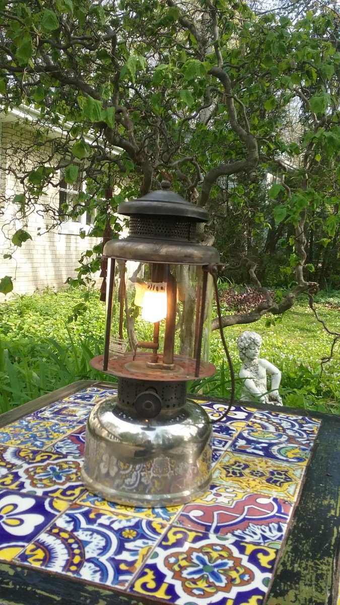

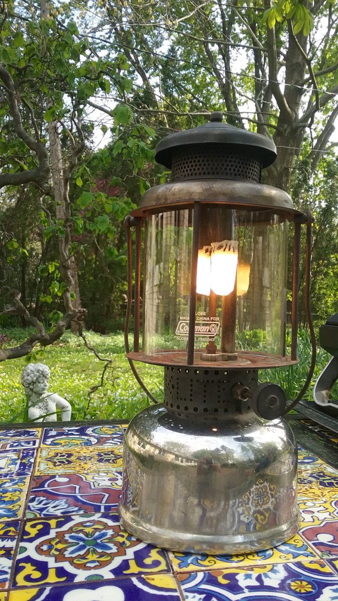

    COLEMAN L327, 1920ish, Turd Slayer. shook stuff out of tank..tightened generator ,checked valve, pumped ,put mantles on ...fired it up.simple perfection. Now I need to Kuntzify it and get a q99 generator. I GET IT!! 20170508_164158.jpg 20170508_164138.jpg
