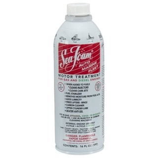

    I am using a full cap of Seafoam gas treatment on every full tank on my dual fuel lanterns using RUG (regular unleaded gasoline) and they work flawlessly. here is an attached image of the product I’m using.

    I think the point about using RUG in lamps isn't that it doesn't work... it works perfectly for a while... the problems will only show up after long term use. I used unleaded in a Shinabro stove for many years (usually on the family holidays) until it stopped working a couple of years ago. It's fixable but it's not an easy process and I sincerely wish I'd never used the stuff!
  6. george
    Yes, gas treatment. It does the same thing as my suggestion in another post and you could use injector treatment, too. Actually, I think anything will work if it's for "gas treatment". Only a cap full is all I use. I've done this to my lanterns for years and never had any major generator problems.
