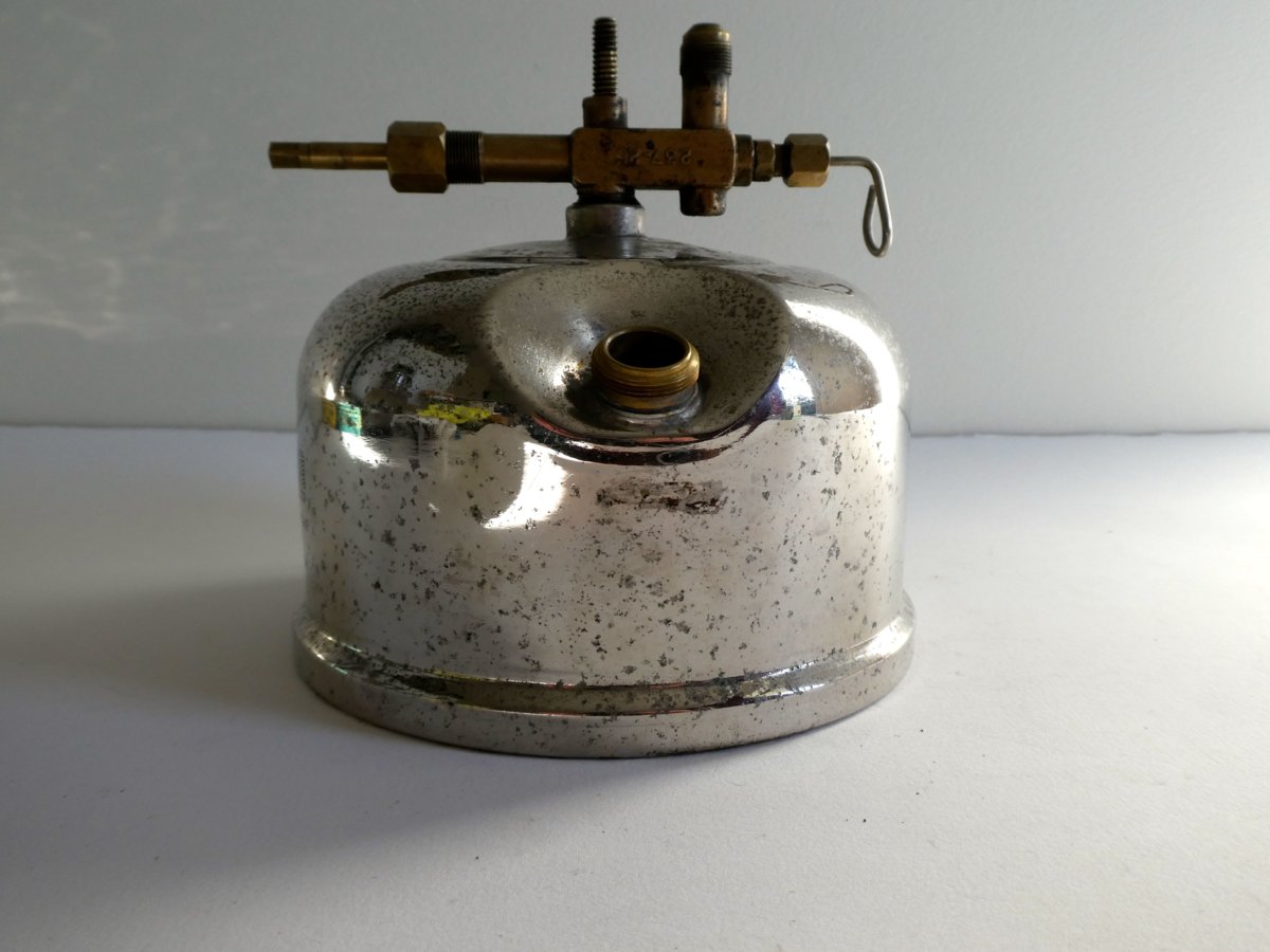

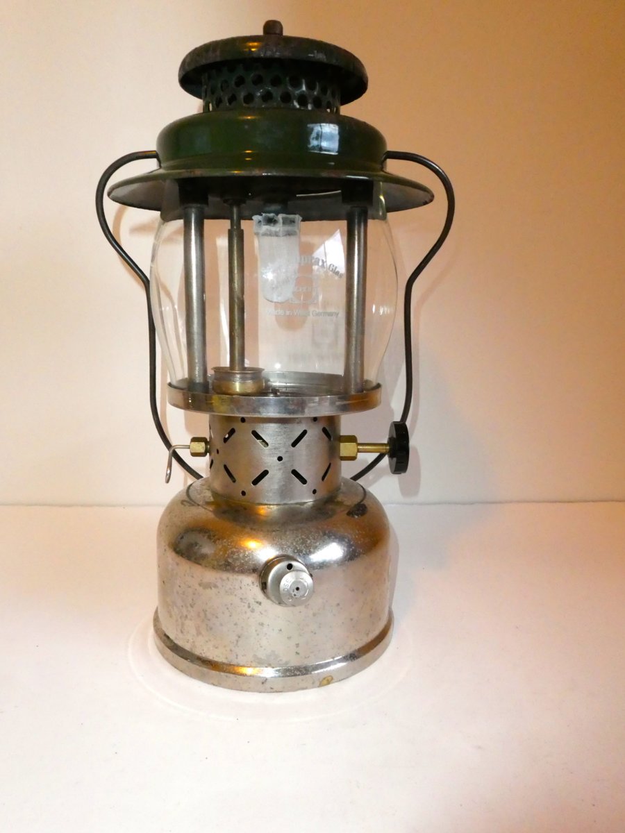

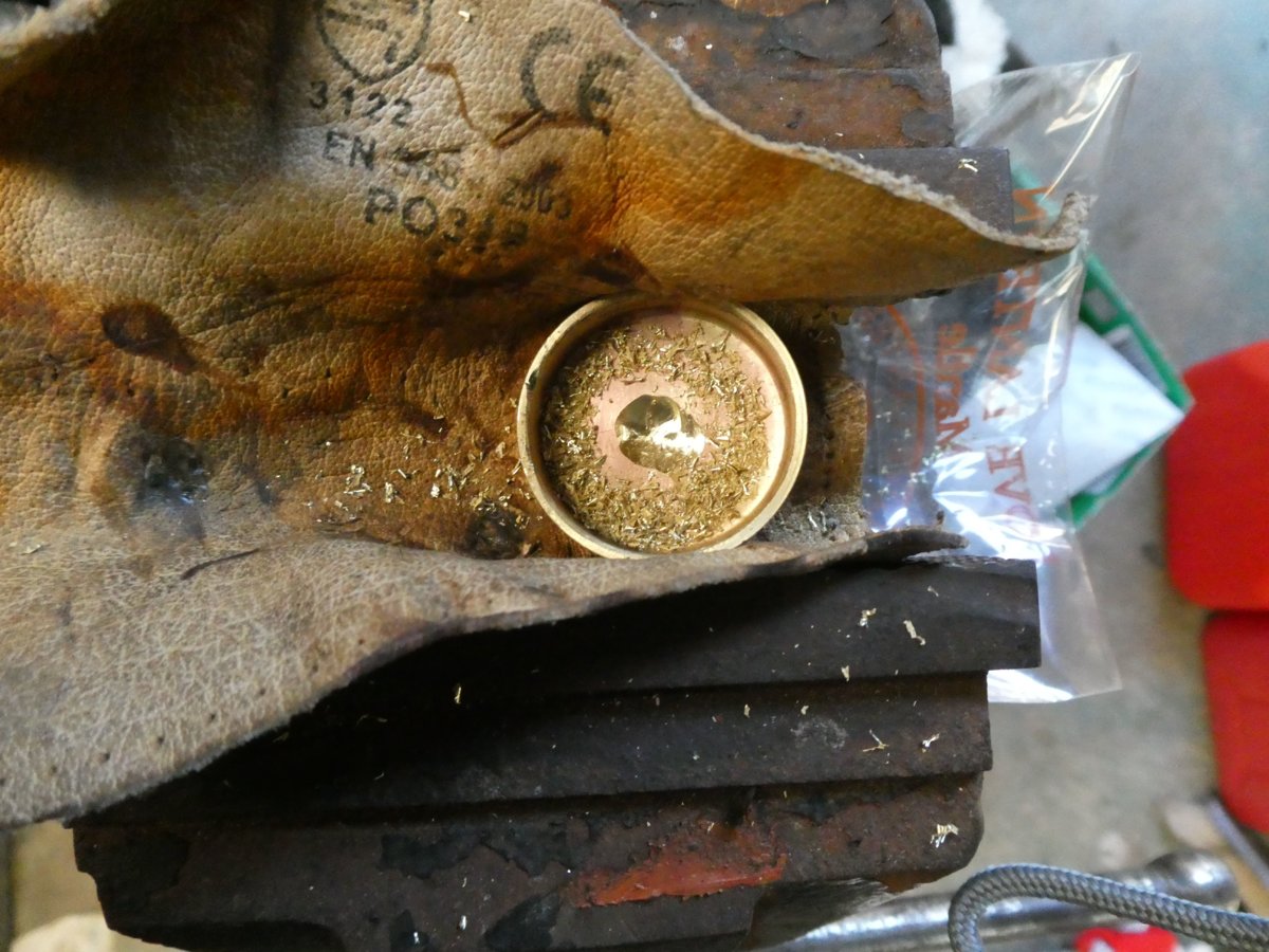

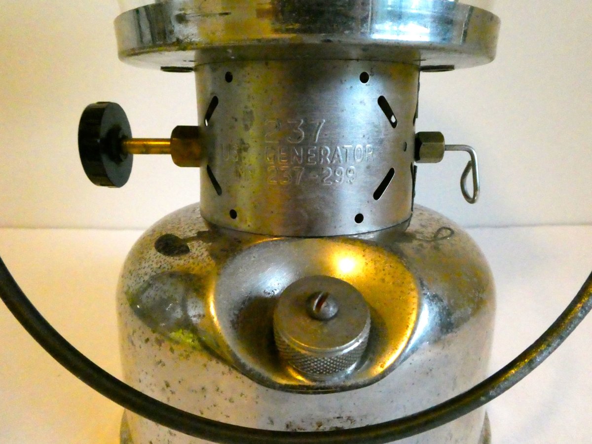

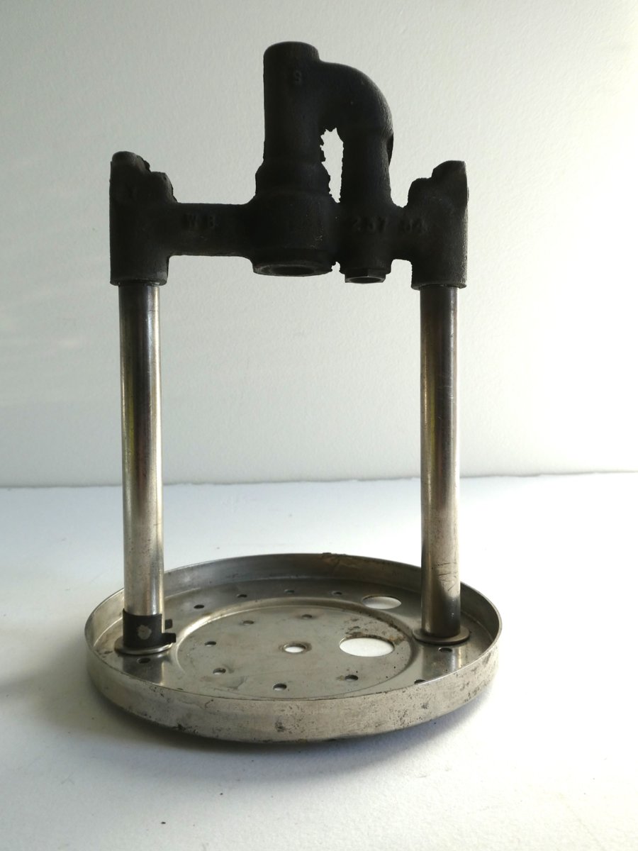

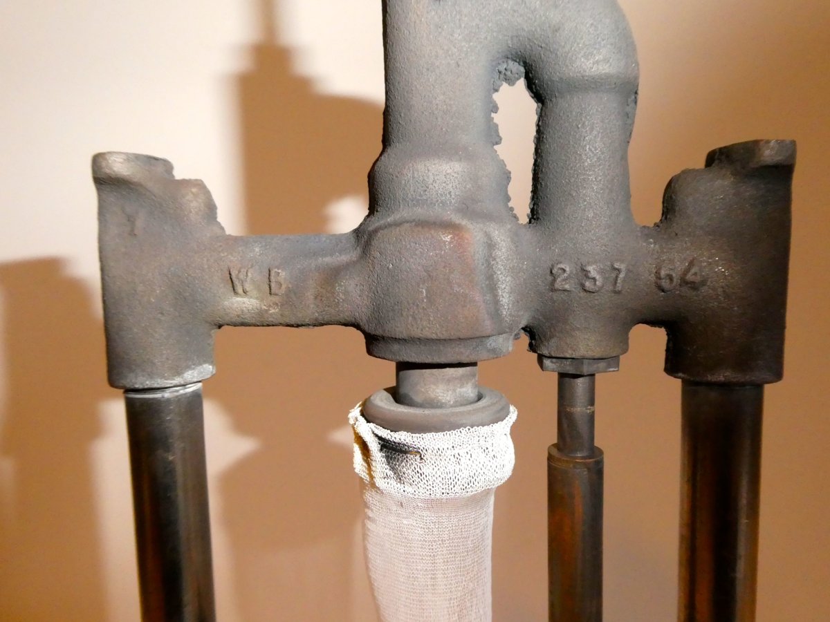

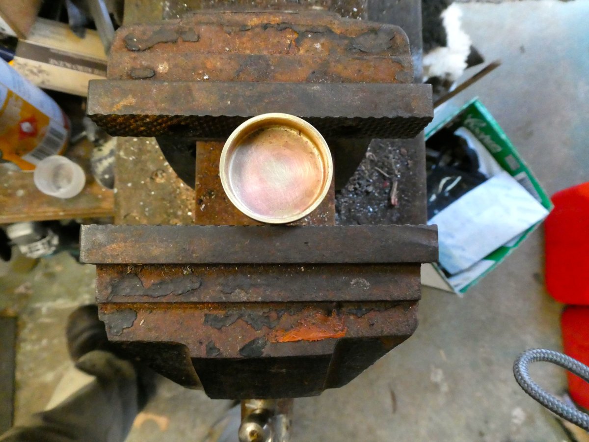

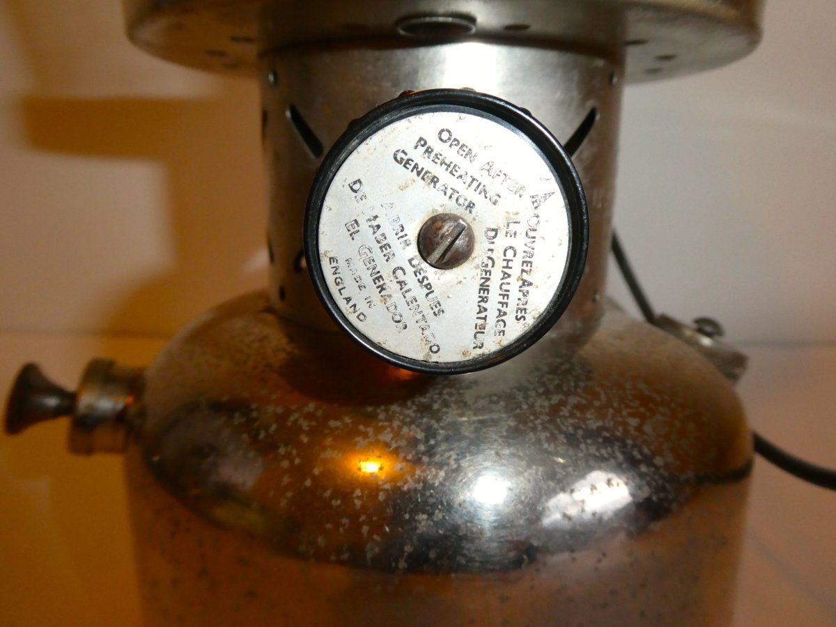

Here's my made-in-England Coleman (10/54). It's a bit rough, but it works well. [ Thank you, @toad of the cape] "WB 237 54" This is my repaired pre-heater. This new generator was a kindly given to me by @phaedrus42 Up and running. This was a pretty straightforward fettle, except for the pre-heater, that had been corroded through: I bought a brass welch plug that was about the same inside diameter (slightly smaller) than the sprit cup. I tapped the pre-heater into the welch plug to mark the centre then drilled the correct size hole (I saved the brass filings for future brazing repairs). I then soldered the spirit cup into the welch plug making sure all the rim, and the base was soldered and not leaking. I had to also fix, with solder, three small holes above the rim of the welch plug. Testing for leaks. I refitted the check valve after making sure the ball was clean and free moving. "237-25" Test firing: The globe (chimney) is a Schott Suprax: one of a few I picked up from a camping store closing down sale in Hobart a while back. Not pretty, but an excellent, robust, high powered lantern. Good for working in the shed! There is some discussion of this lantern here. Cheers Tony
Bugger me Tony,I thought you wanted a colander with that not a chalice, good job their fella. You will note it burns hot and bright.Sadly as I had said it was running too rich and most likely needed a replacement jet so good to have that new generator (well done that chap). warm regards "by the light of a lantern" toad

The instructions that came with the generator fitted to this lantern are here: https://classicpressurelamps.com/th...ting-a-coleman-generator-canadian-1951.12512/ Cheers Tony
