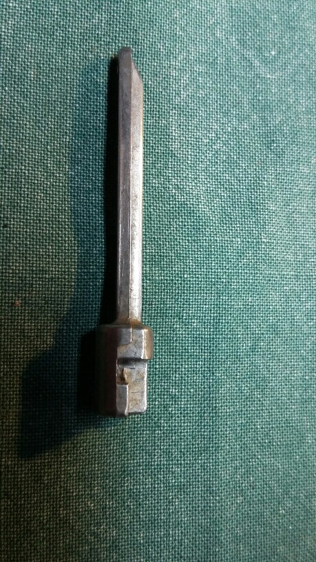

    With the 242 and 249 lanterns, we learn that after fettling or dismantling the control shaft packing, to nip up the gland nut until it stops leaking under pressure, and the shaft is still free to rotate. The 214 is different - the gland packing is different - the gland nut must be tightened to the end of its thread because only then is the eccentric pin fully engaged in the slot of the eccentric block. And it has only approx. one m/m - or less - of engagement in the slot, so that if the gland nut is not fully home, the pressure of the valve spring (?) and / or fuel will actually push the ecc. block up past the ecc. pin, thus pushing the pricker up to slowly start restricting the flow of vapour through the jet. Pressure of the schrader valve spring - that's a curly one because if the valve is slowly closing, that doesn't explain the orange flare-ups. It's hard to believe, but there is a witness mark on the SIDE of my ecc. block which shows where the block has been sliding up past the pin. Fair Dinkum. The ecc. block, by the way, looks like a zinc/muck metal pressure diecast item, with a strange cutaway and a curved slot. The cutaway at least allows you to engage the pin in the slot easily, by watching from the underside during assembly. Making a new ecc. block from brass would be quite easy on the lathe, or even fitting a longer ecc. pin may help. I don't know what other model lanterns were fitted with this awful ecc. block arrangement. Sounds like the 214 had a short production run, and yes, some had heat shields and some did not.
    There's the diecast ecc. block next to the plain and simple Austramax ecc. block. You can see the 'ledge' where the ecc. pin has to engage, not much room there at all.
    Obviously the Austramax block has a greater area of engagement for the pin.
    The witness mark, where the block had been sliding past the pin, is quite visible to the eye on the bench, but very faint in the photo.
    So much cuataway, so little area for the pin to move it up...and down against spring pressure. The ledge for the pin is on the left, half way up.
    "But ah, my foes, and oh, my friends - it gives a lovely light." (Edna St. Vincent Millay). Actually, many spare parts for this lantern are simply not available, and I'm not surprised. It will now run for four hours without fault, so far, touch wood, and I could easily make a decent ecc. block, although getting the slot right could be tricky. In summary, nip that gland nut fully home, and eliminate at least one source of trouble. Cheers.

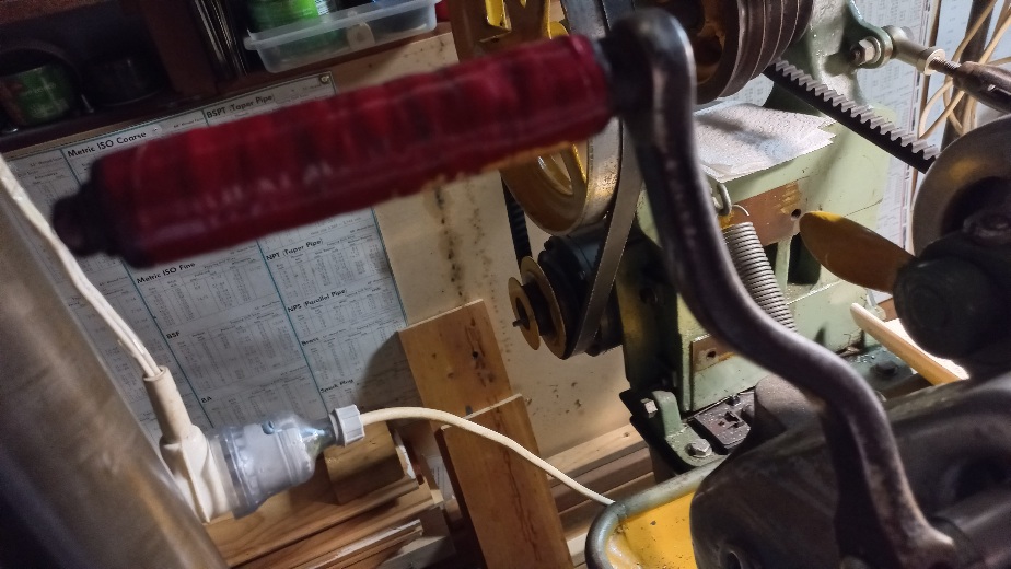

    Had to make a new coil. Brass rod, annealed, 1.5 x 300 m/m, wound by hand over a 2 m/m, 14G spoke. Original coil material was 1.88 m/m. Having a crank handle in the spindle was a help. Next time the leadscrew will be used, about 10 TPI.
    I'm determined to make this lantern reliable, so it's a work in progress. And no, I don't want another 214.

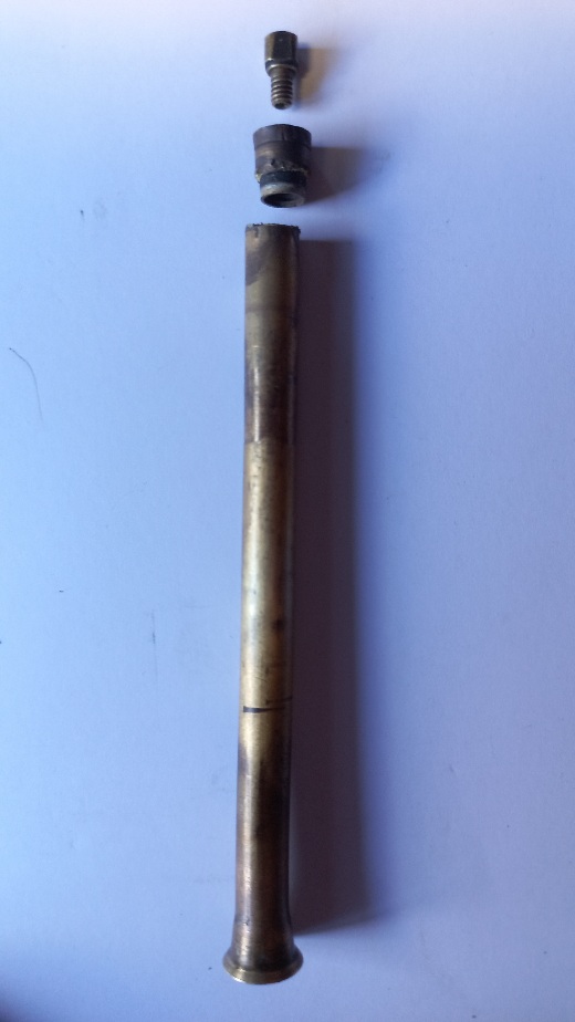

    Oops. Here's the pic of the new AU$18 Globe, with the new coil in the Genny.
    And a pic of the lantern slowly going dim. Flicking the control off and on restores full brightness for a little while, until the valve closes up again.
    The nipple rolled off the bench, took half an hour to find it, in amongst the dust, debris and dead beetles. The thread in the top of the genny was half stripped, (don't ask how) had to make a new one. Fun, fun, fun. Sweated out the old one and copied that.
