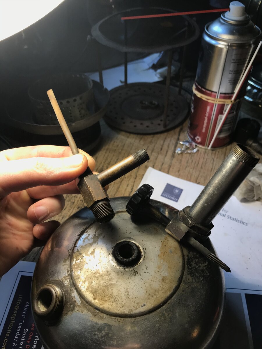

    If you are going to try an extractor, then heat will help as it will start to break down the rust that has formed on the threads. The heat expands things and makes it possible for parts to move more easily :thumbup:
    @Tony Press will know more about how much heat to use and how long to heat and whether things unscrew from tanks etc
    I thought you might have had access to a mig as the extended studding/screw job on your nice wick lamp had what looked like nuts with a line of weld down them?
    It may sound like overkill but it's one of the best ways for extracting broken studs.

    Ha thanks,

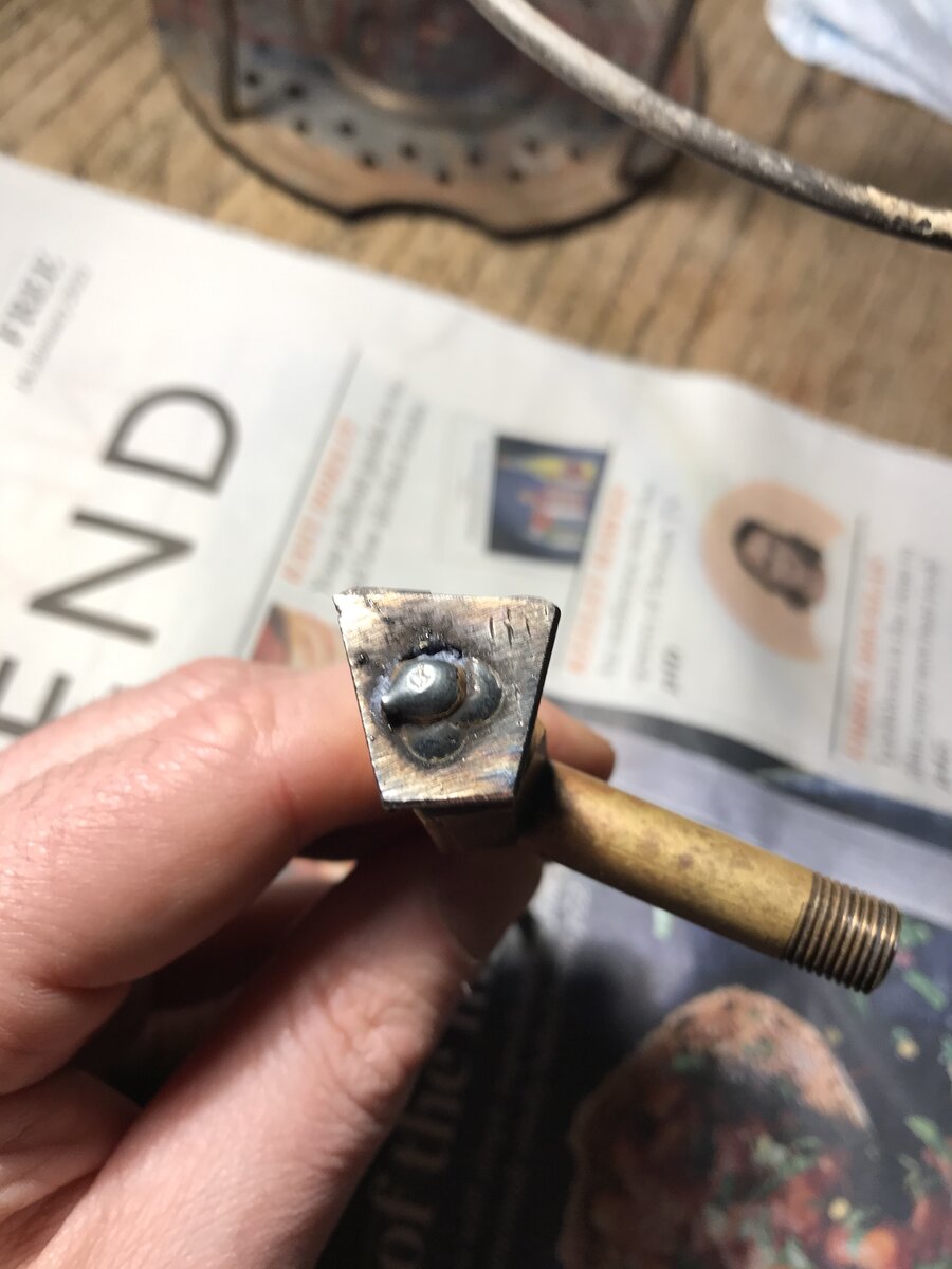

    the line of ‘weld’ on the 4 nuts in that photo, was infact solder...! More than strong enough for that application it seems. This one requires a bit more thought and application...
    for a start I haven’t got the correct diameter extractor and will have to order one from Amazon or the like. It would greatly help if that brass fuel valve assembly came off the tank without ‘Screaming’. I don’t need another breakage there! :-s:D

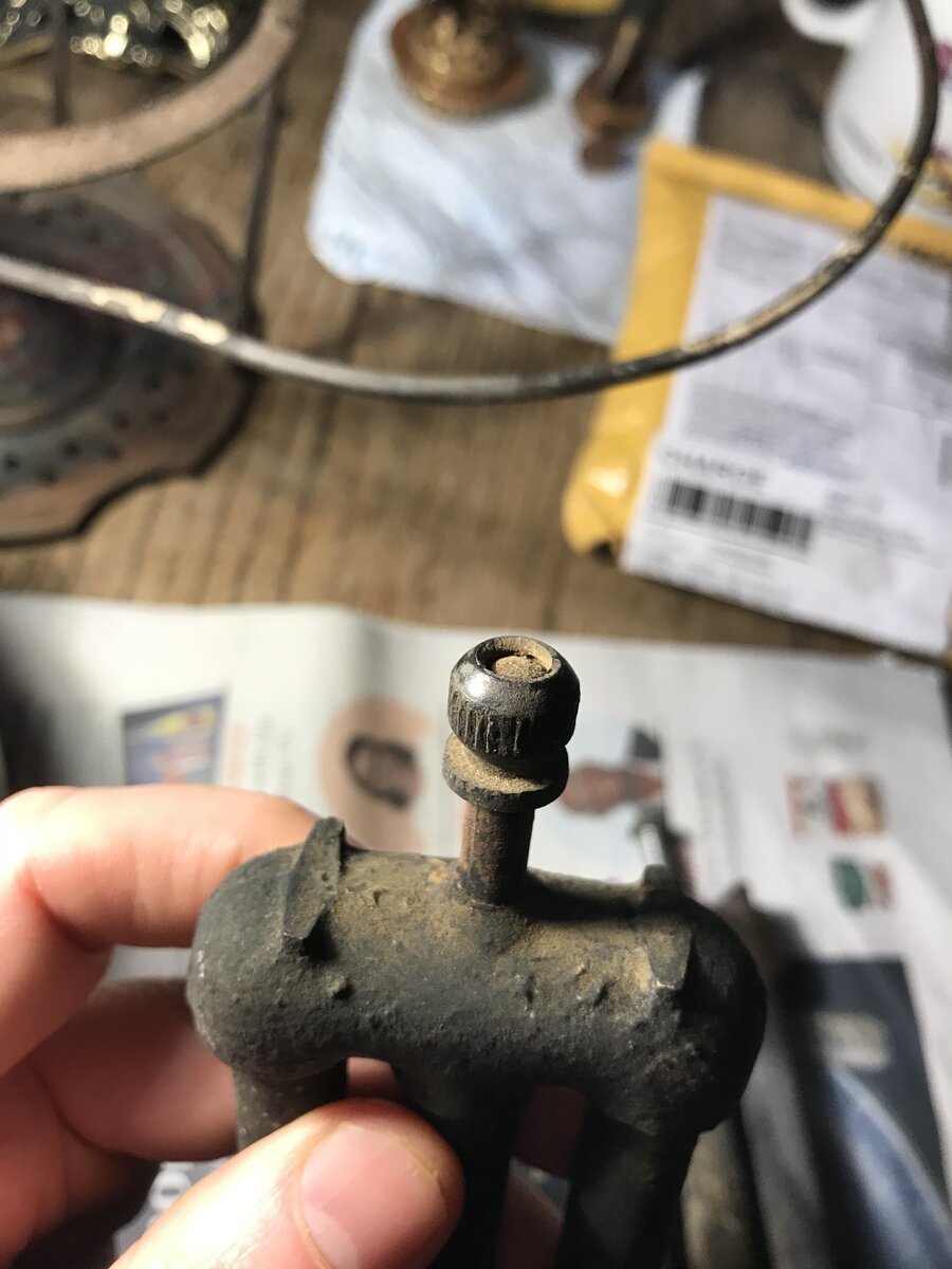

    Success with the fuel valve. It wouldn’t yield with a spanner, but after careful heating and repeated application of penetrating oil, it came off by gently tapping on the side arm with a tiny hammer. The pump tube head was stuck as well. Heating and oil did the trick.

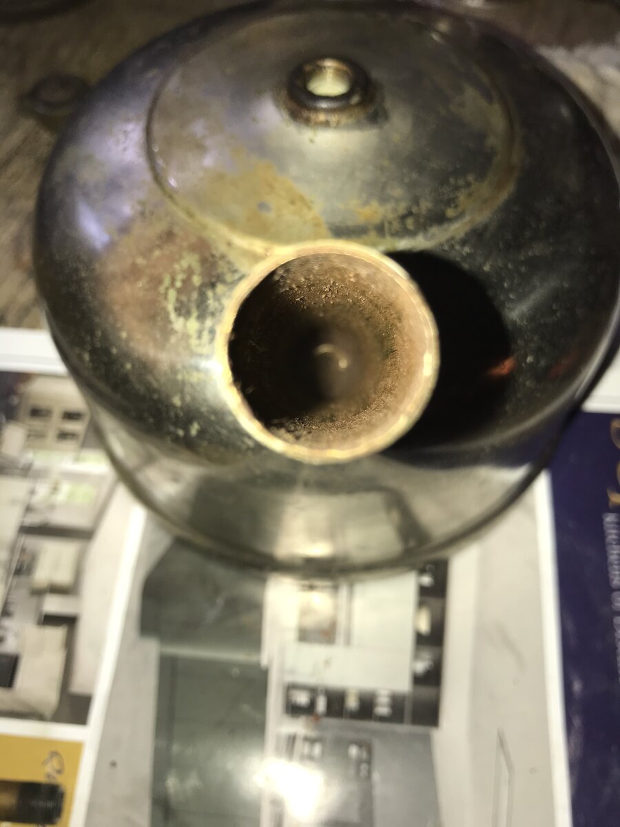

    There’s a lot of gunk down that tube, possibly the remnants of the leather. How do I remove the NVR valve at the bottom? (Assuming there’s is one)...

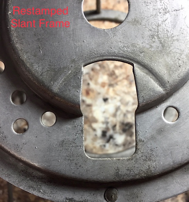

    Hi @Tony Press , I see the lantern example you showed Alex has a Coleman factory Repurposed (restamped Slant 220) Frame.
    These are normally found on several 1929 models in all months including some Sunshine Safety lanterns. Note that these Slant frames all have no half moon cut out for air pump or fuel funnel.
    Coleman obviously already knew and planned the Slant would go and be replaced by the 220B model in 1930 so these frames were being disbursed.

    Well spotted, Larry. I’ll send you a couple of photos. It is down the fettling queue, so it’ll be a while before it’s put up here in the Gallery.
    @coleman54

    You need a special tool to remove a Coleman “check valve” (NRV). I’ve only ever needed to remove one. The best way forward is to:
    1. Clean the pump tube fee of gunk with carburettor cleaner.
    2. Half fill the pump tube with acetone and leave it soak overnight.
    3. While the acetone is still in there, get a strong rod about 1mm diameter (no sharp edges) and poke it down the check valve to loosen the ball in the valve.
    4. Shake the tank around to see if the ball is loose. Hopefully you will have freed it and it’s not pitted with rust. Empty acetone.
    5. Put some penetrating oil down the pump to soak the ball in the check valve. Empty oil.
    6. Test check valve under pressure.
    Fingers crossed you won’t need to take out the check valve.

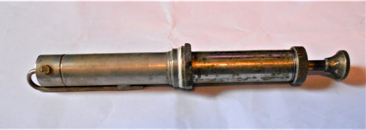

  7. Henry Plews
    3,066
    Normally yes but not with this type of pump. The check valve ball bearing is behind the small hex headed brass screw at the bottom end of the pump tube.
    @Alex74 For cleaning, I recommend you follow @Tony Press 's advice.
    If surgery is required, forget about adjustable wrenches, the pump is tight and it's easy to round off the corners of the hex fitting so use a correct size spanner - 1" A.F. Similarly with the brass screw which being so small, is easily sheared off.

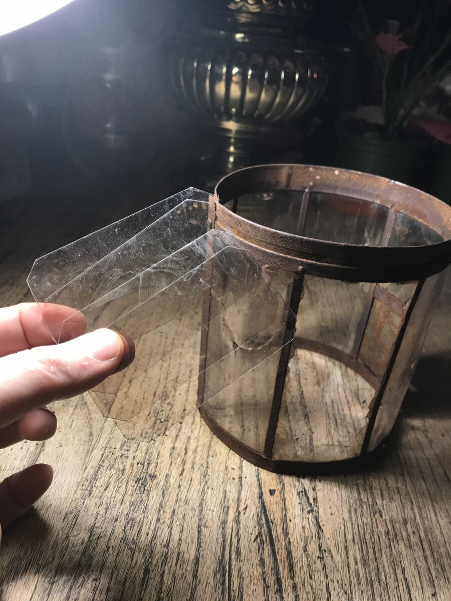

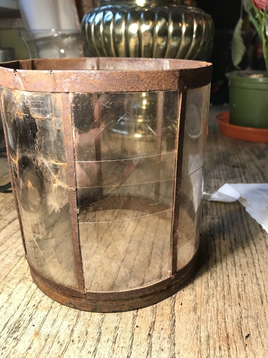

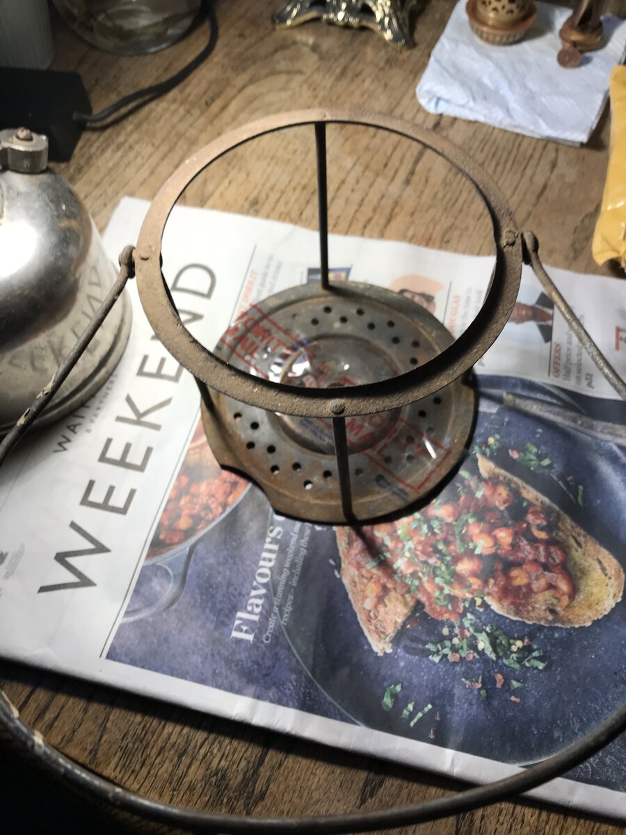

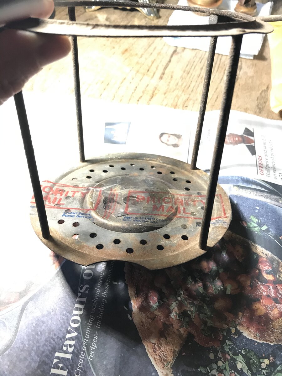

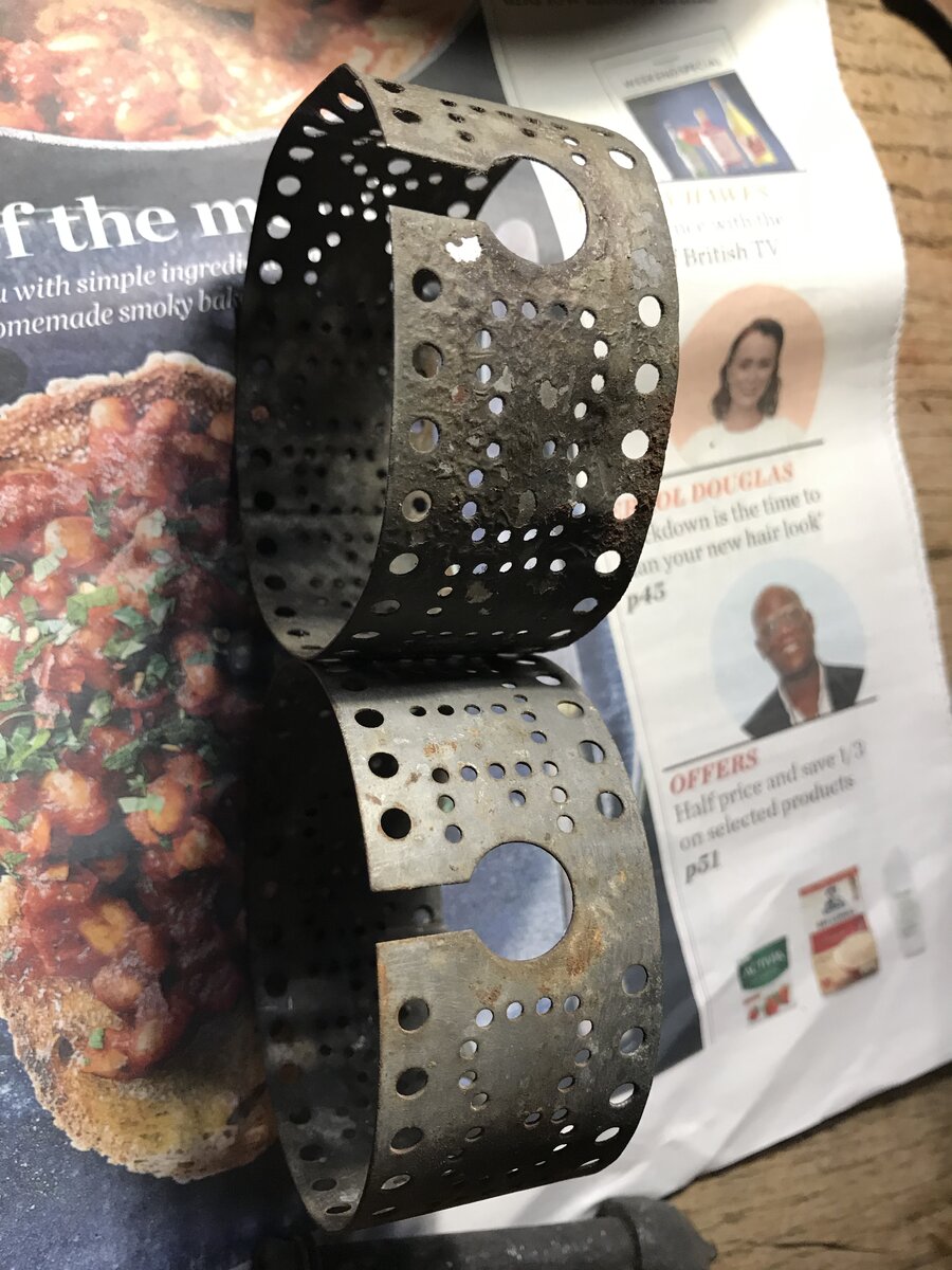

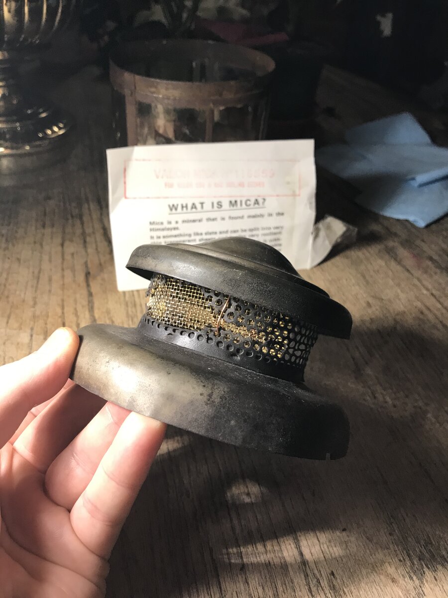

    Progress with the mica globe. The vinegar worked well to free the lighting port door which now slides well up and down. Fortunately the small mica panel behind it was intact. I cleaned and polished the other panels with a dremel, mini buffing pad and mothers. They came up really well. I need to replace the missing panel now. I bought some small Valor stove windows which I’m planning to use ‘in series’ to cover the aperture.
    I rather like the rusty patina on the frame, so I think I’ll keep it to preserve the authentic distressed look....
    I have reinforced the broken mesh of the vent with new brass mesh which now holds it all together with copper wire ‘stitches’....That’s all I can do for now while waiting for parts to arrive...

    Progress with the mica shade. I’ve repaired the missing panels by cutting the Valor sheets to size and carefully pushing them into the grooves of the frame. Fiddly as all remnants of the old panel need to be removed with a Stanley knife first. Then the frames are pressed together firmly to secure the new sheets in place. Clearly he new window is more transparent than the original ones, but that’s a plus I think...

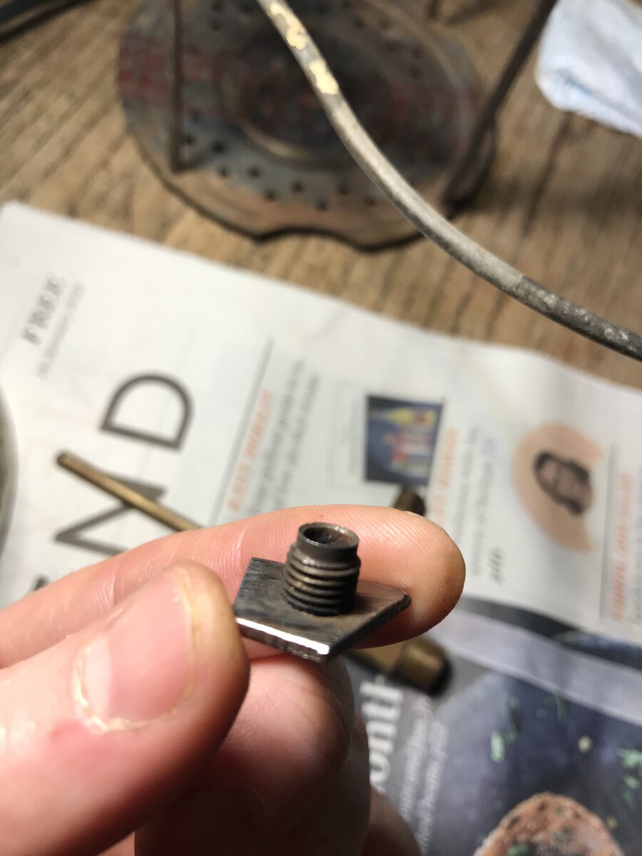

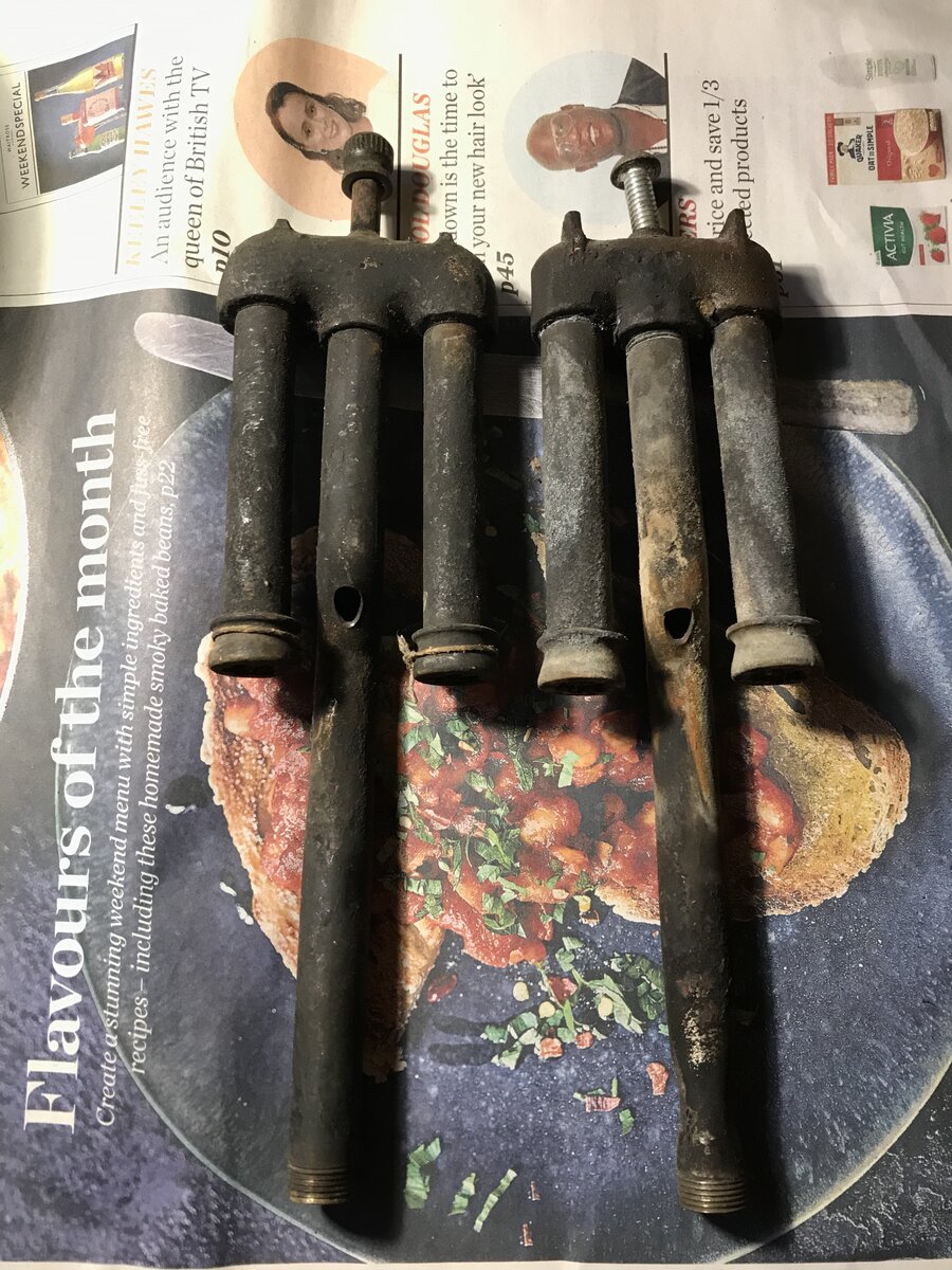

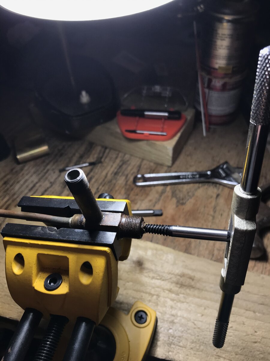

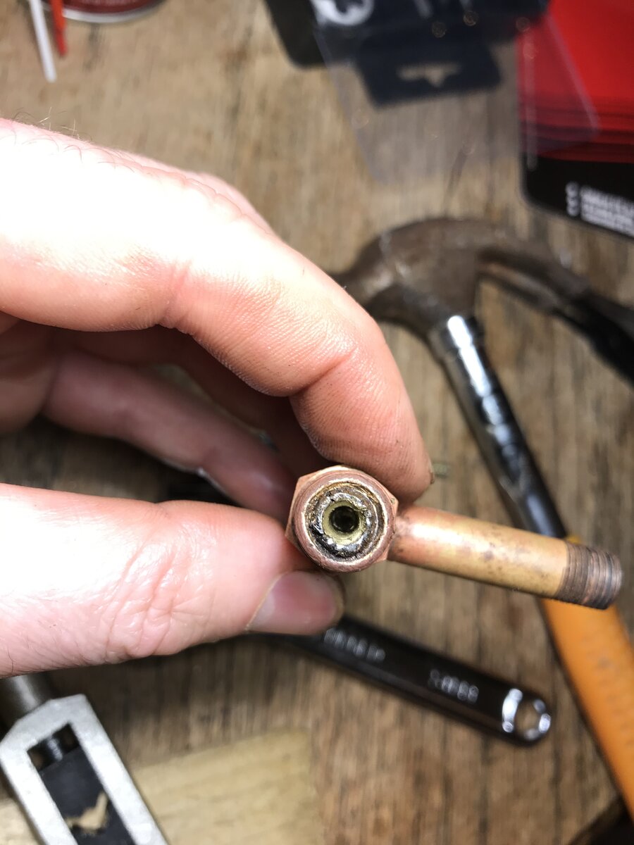

    No joy with the fuel valve. The old broken stud resists the extractor, even after boiling the valve in dilute citric acid for an hour, heating and applying oil. The stud has fractured it seems, but doesn’t want to move. What else could I try before throwing the whole thing away?

    You might have to heat it more to melt any solder that could be there holding in place. Not so much that the brazed area of the valve stem tube would melt.
    I don't know if its soldered in place previously.
    While doing so the soldering at the fuel pick up tube would melt but you can easily re-solder it back.
  19. MYN
    If its just the threaded area that's stuck, maybe heat(dull red) and quench in water for a few cycles. That should release it.

    I’ll try that. Nothing ventured nothing gained. I thought about dipping it into muriatic acid overnight to eat the steel away, but then the zinc in the brass would start to go, causing damage to the threads, so maybe not a good idea. I’ll try the heat/quench cycling method you suggest.
    ps. Meanwhile I Just bought a 327 from Mike on eBay. There’s plan B!

    Great, thanks guys. I cleaned the pump tube of all debris and left it filled with acetone overnight. Alas, I still can’t move the ball with a wooden skewer. I can see a new challenge emerging here! :roll::-s
    I’ll repeat during the week before taking the pump valve apart...or trying to!

    There's too much solidified gunk inside the pump tube and possibly the nrv too.
    Acetone might take a long while to dissolve or soften those. If there are bits of leather as well, acetone won't make it.
    Try concentrated lye (sodium hydroxide) solution for a preliminary soak. Or a strongly alkaline engine degreser or a mixture of both.
    I'd use a strength that's capable of 'dissolving' flesh and hair.:mrgreen:
    If there's rust inside the tube, you'll need acids as well.
