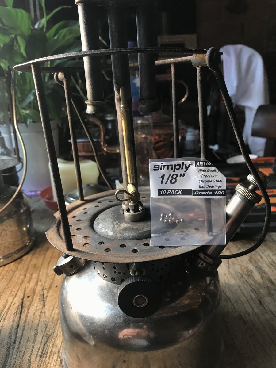

  9. Henry Plews
    3,066
    You can use a 1/8" or 3mm drill bit to measure the hole.
    I'm sure the correct size is 1/8". This packet of 10 won't break the bank
    Search Results: 1/8 ball - Simply Bearings Ltd
    Type 1/8" steel ball bearings in the search bar of your browser for other examples.

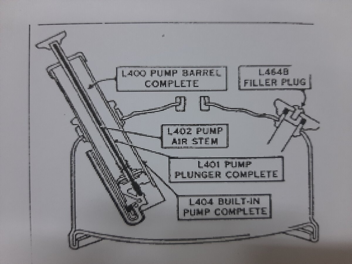

  11. MYN
    It'll be ideal to know the exact size. From the following illustration, I'd say that you get a ball that is small enough to get though the hole with the hex plug removed but must be large enough as not get lodged in the 'snorkel' tube:
  12. MYN
    I'd believe you've got your answer at CCF @Alex74 .
    So, the steel ball's supposed to 1/8"(0.125").
    I'd get the stainless steel version to avoid corrosion later on but that's not entirely necessary. You'd have sufficient oil on the ball (excess oil from the leather and pump tube) by the time you get it to work.
  13. Alex74
    Oct 13, 2019
    516
    Faringdon, Oxon
    Bingo! Fantastic guys. Thank you all for all the advice. Henry was right all along. I’ll order them tonight (just got back from work). Hopefully they’ll be here early next week.
    So 1/8 inch or ~3 mm. That’s larger than I thought, as I was expecting it to fit into the small orifice you see down the pump tube. Doh. [-(:doh:
    And now Santa has kindly offered to send his callipers and drill bits! I have no words. Of course I politely declined the offer, but it just goes to show what amazing people we have on this forum. I’m humbled and very grateful to you all. :D/:clap:

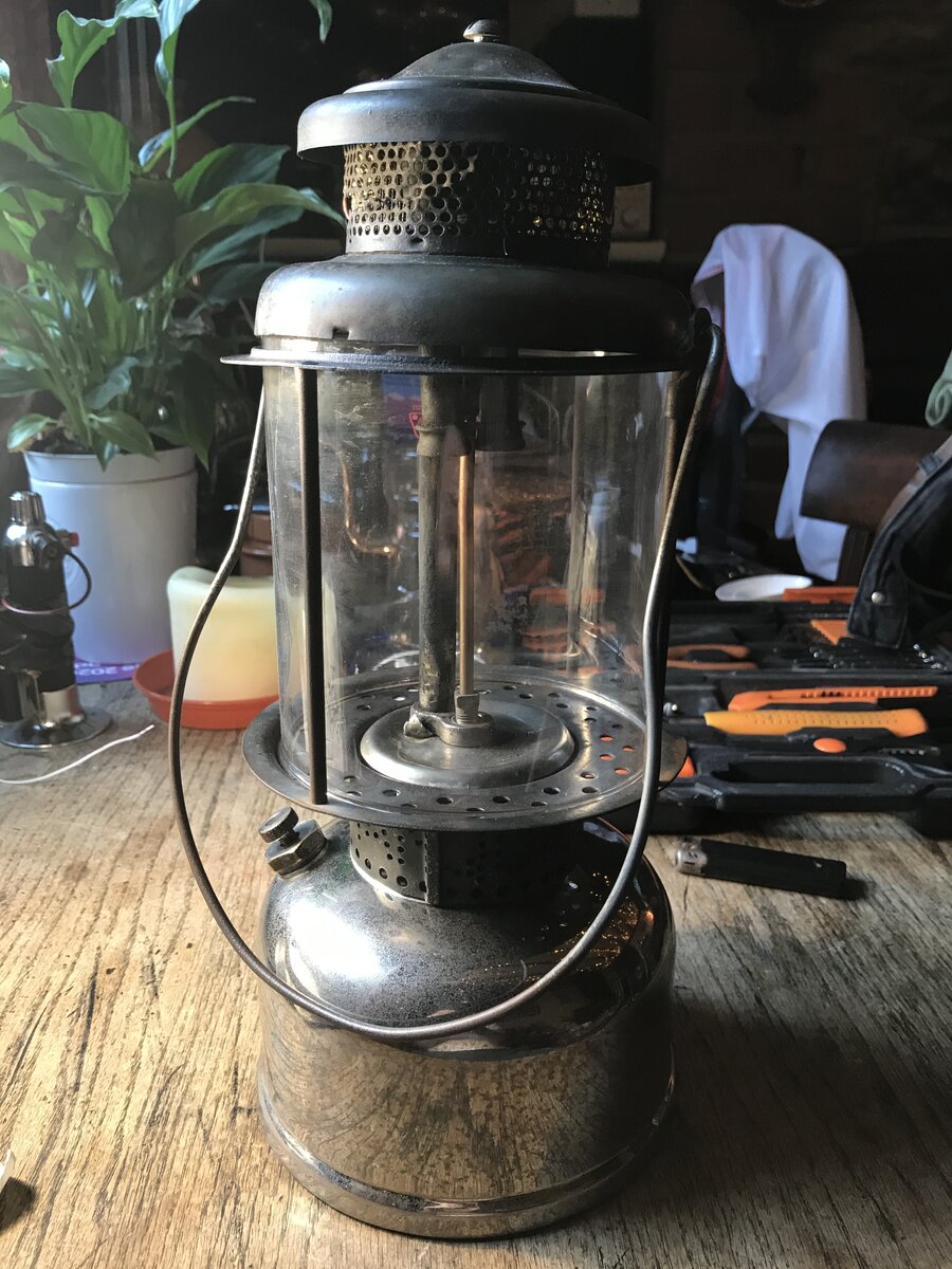

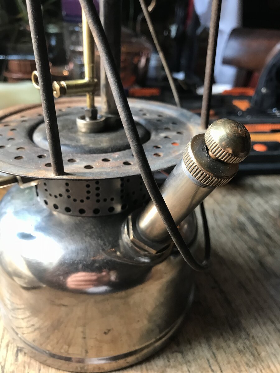

    51895158-B125-4E9A-939B-1AF0438F8712.jpeg CE4DF47D-2810-47E5-AFE2-00C29504D122.jpeg Hi all,
    There’s progress on all fronts. The ball bearings arrived on Tuesday and the pump now works a treat! I changed the seal of the fuel cap too and there’s tons of pressure in the tank with no loss after an hour. The fuel valve is now unblocked thanks to another hot caustic bath followed by a dunking in meths overnight.

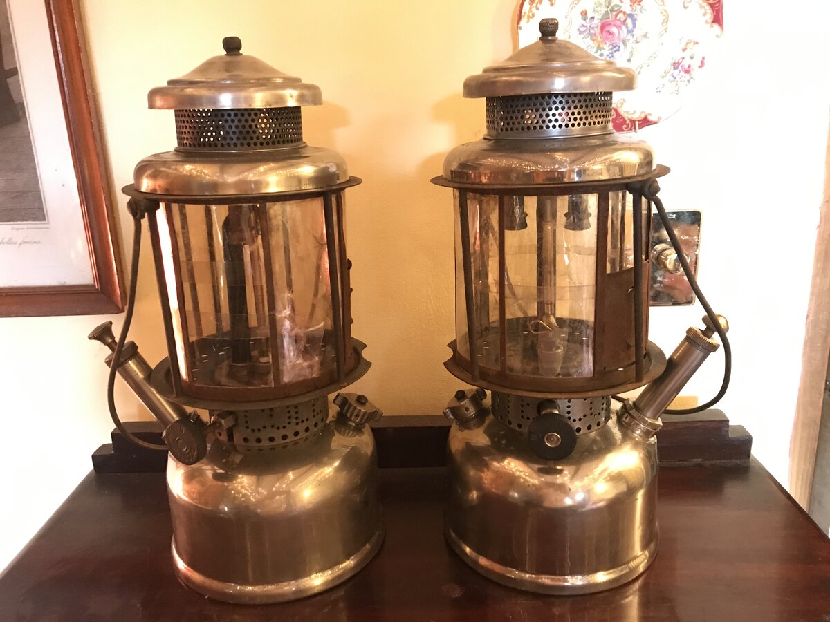

  16. Alex74
    Oct 13, 2019
    516
    Faringdon, Oxon

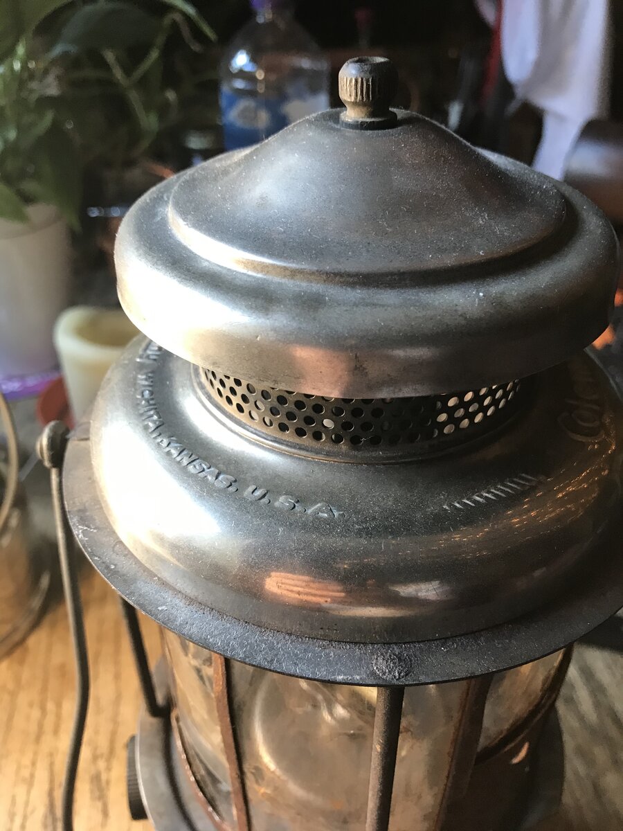

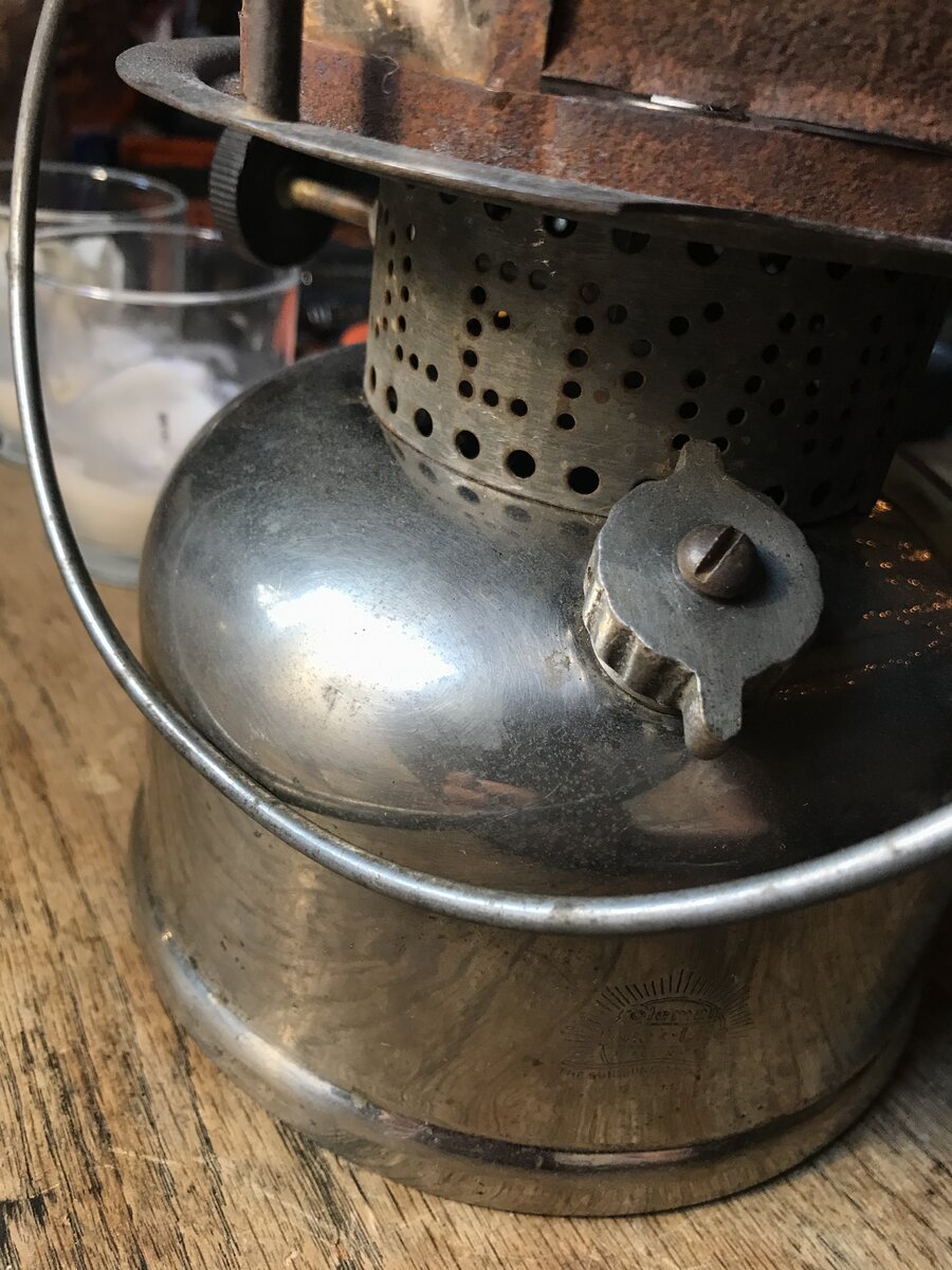

    But there’s more.... as I run my lamps ‘in pairs’, just before Christmas I bought another old 427 and a 327 from the US and they arrived last week (one was with a neighbour since the week before). The 327 provided period correct parts and a replacement vent for the older 427, which now, I believe looks like it did when out of the factory in 1925? Below are shots of the second 427 (stamped 5 11?..) which pumped up straight out of the box, and the pair together, after repairing another mica globe that came with the 327....
    4E2F26DF-D6B6-4452-BEC4-DA264352E4AC.jpeg 478AB626-54C2-4572-A997-893981ED43F4.jpeg 80E53F7C-9863-4036-A262-013AAD601F32.jpeg 4462DA97-0E42-40B0-B83E-94883B188ABE.jpeg B43097B4-3A06-48D5-A180-3C223984F4D5.jpeg AAC19E52-7A10-429C-AB1C-8B16ADBA1813.jpeg

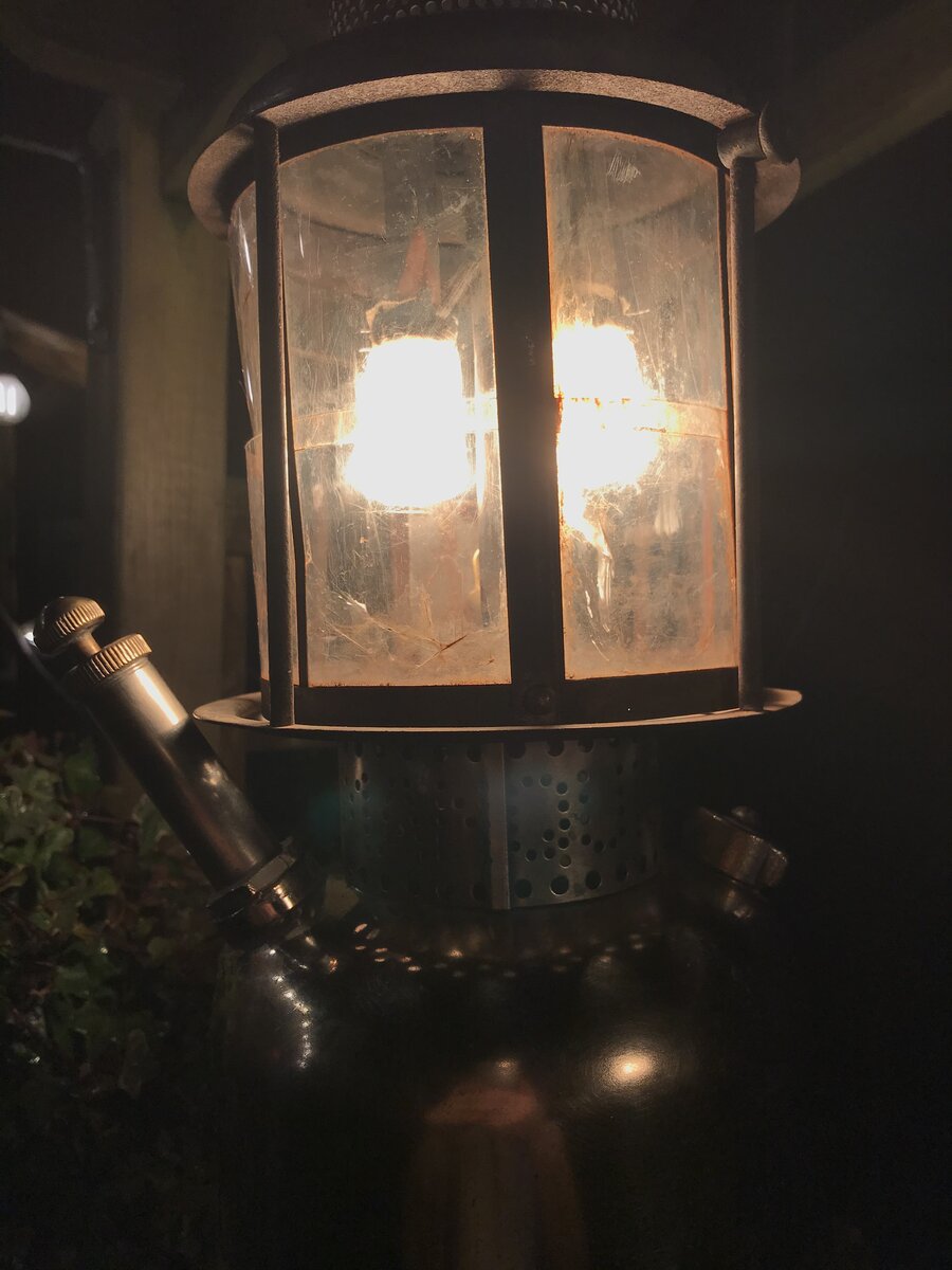

  21. Alex74
    Oct 13, 2019
    516
    Faringdon, Oxon

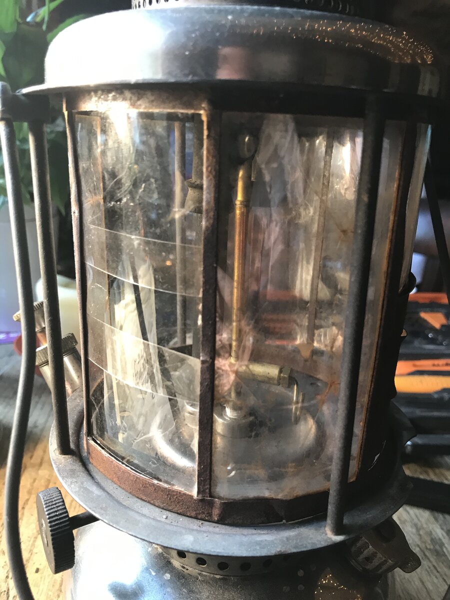

    F40CD621-28C0-439F-B6E8-FBF2907EE766.jpeg B09A52B5-D13D-45CD-9488-07069D3A88CA.jpeg DB1A02B0-11D7-4292-AB6E-505D21F82E9D.jpeg 8B48A666-B2AE-443F-AEA0-90B0FDFEF34D.jpeg CAEE4145-E6EC-48A4-BADD-2F6B1750D294.jpeg CFE027CE-7E36-4E46-A2C3-331325F2FB7E.jpeg 46FC8D67-50C4-4EC4-ACAA-32E4C1E9F645.jpeg 3A3D562D-FCBB-4C14-AD95-204F42710947.jpeg Thanks guys,
    so I decided to test them last night, after watching a couple of YouTube vids on how to light an old 427 safely. They just lit up without problems and stayed on effortlessly for 3 hours without needing to pump them up regularly. They give out a lovely warm light too, probably a combination of using Coleman mantles and the old mica globes. They also produce a very mellow, almost muffled hissing sound. I was pretty chuffed to say the least. Having two in the garden is definitely the way to go for summer bbqs I think. But what a ride to get a working pair!

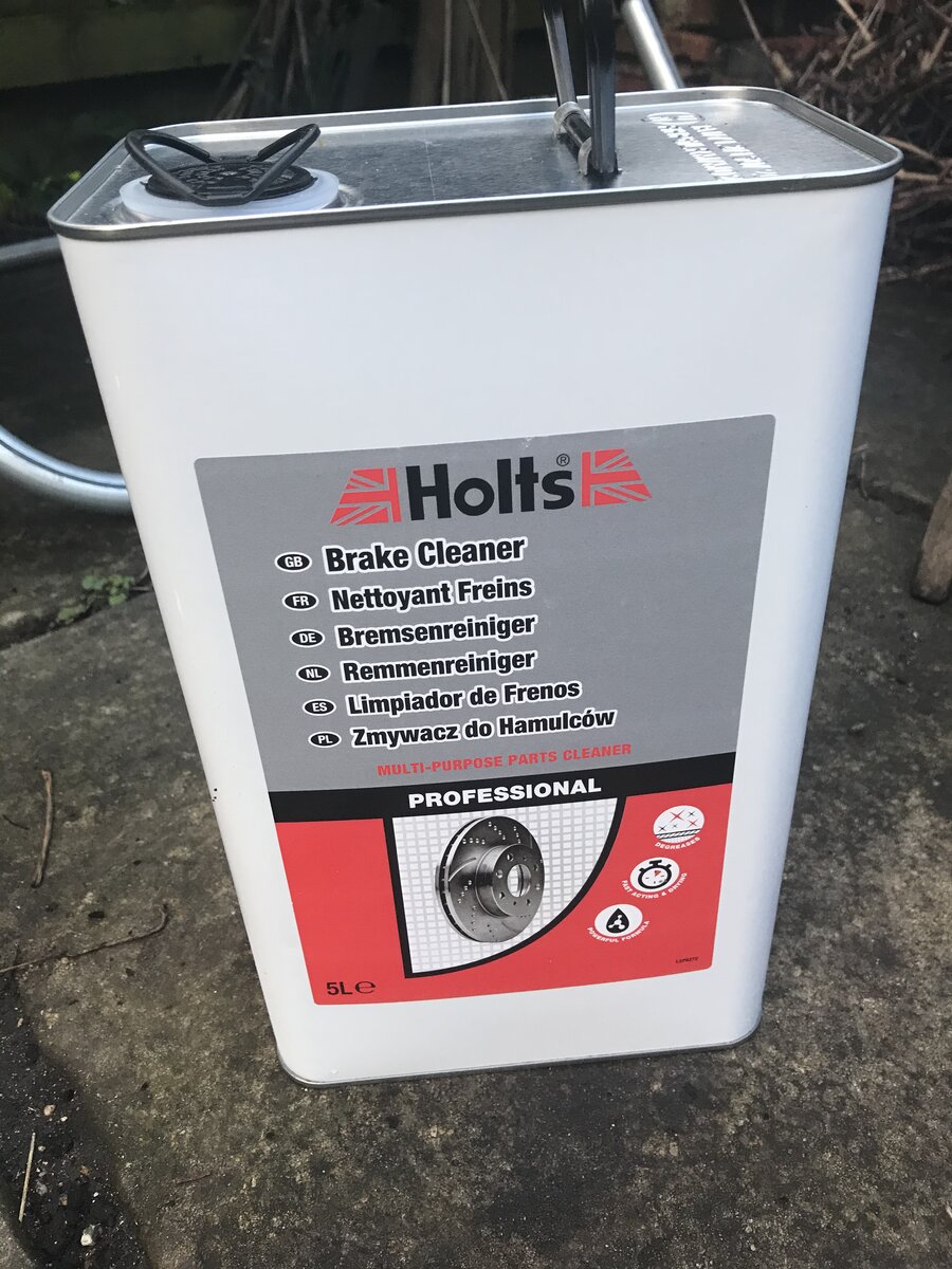

  25. Alex74
    Oct 13, 2019
    516
    Faringdon, Oxon
    By the way, Holts brake cleaner, as suggested by Henry, works really well as fuel, and no smells either. 5677A84A-DDB0-49B6-A7E3-0859E8C5C108.jpeg
