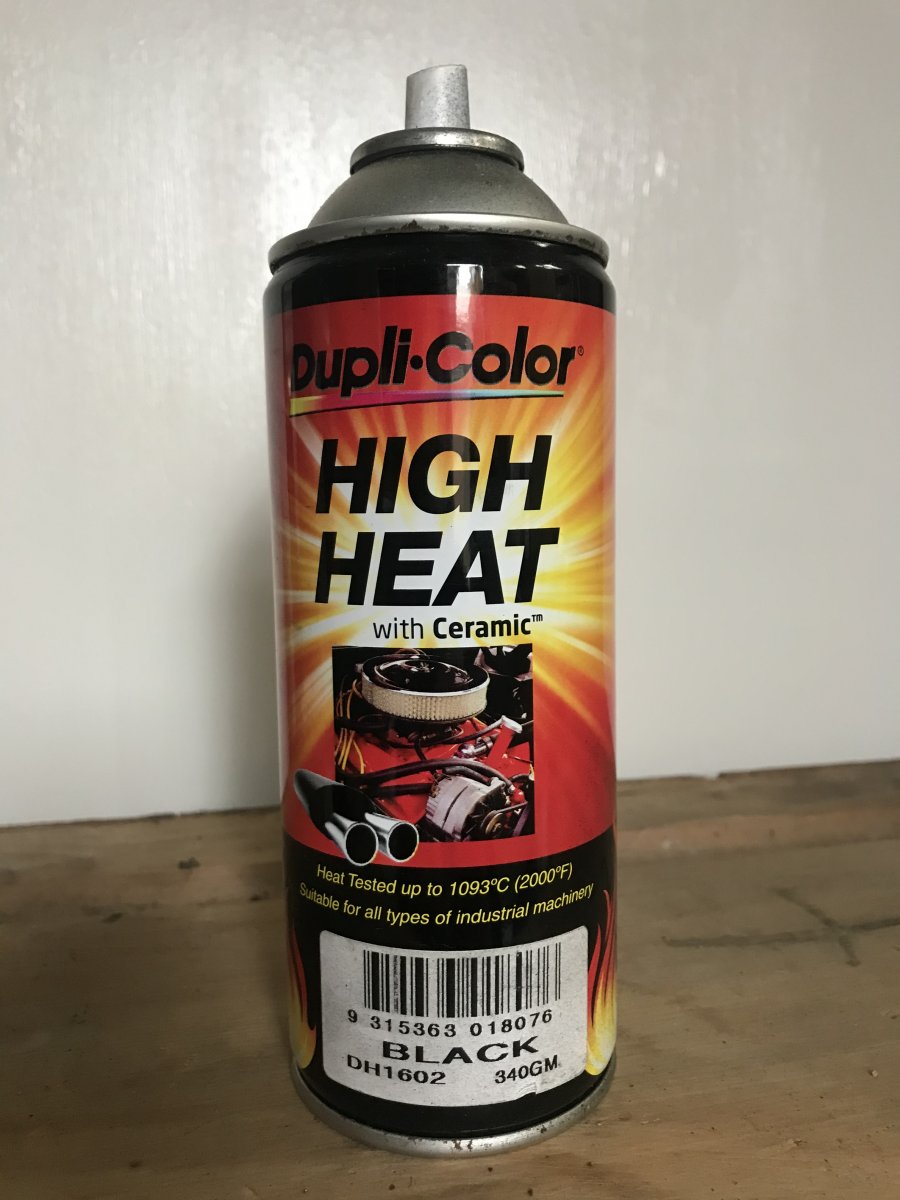

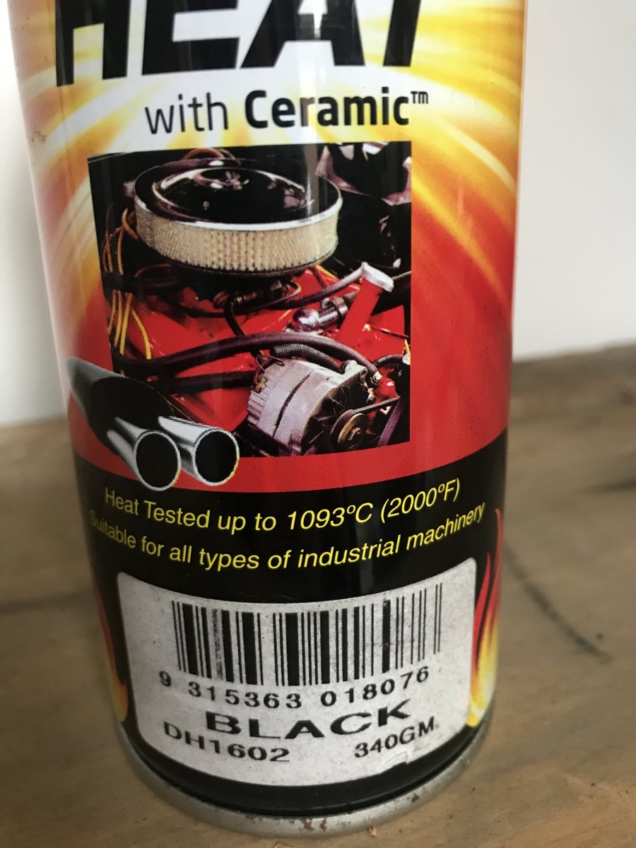

    But before you go and buy your paint, here is but one example, “Heat tested up to 2000°F” that does not withstand the dynamic heat of a fully functioning pressure lantern for more than a few burns. It’s matt black. The gloss colours aren’t rated as highly for temperature exposure.

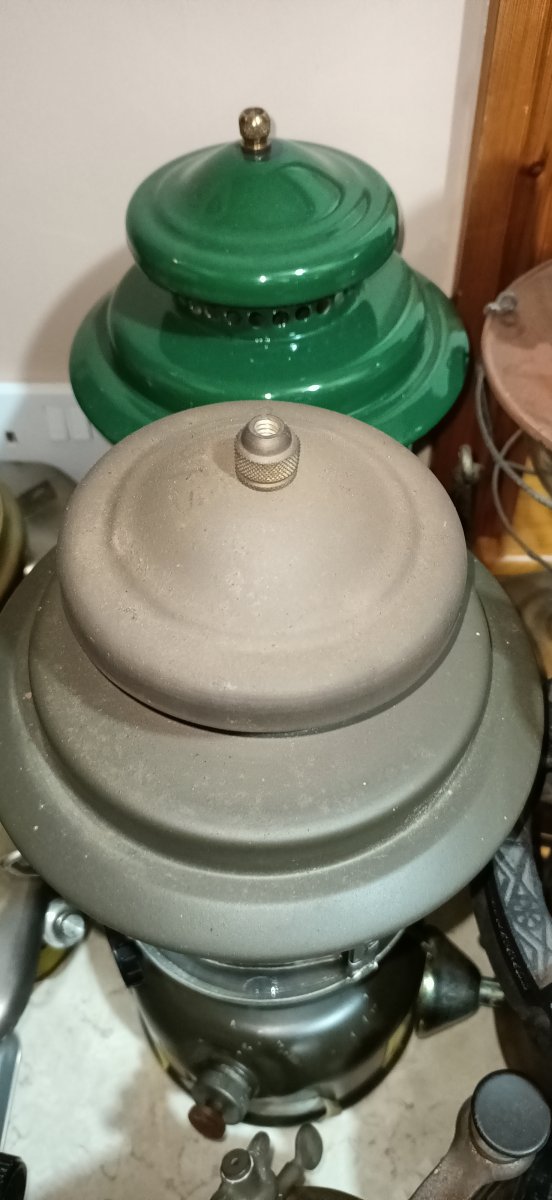

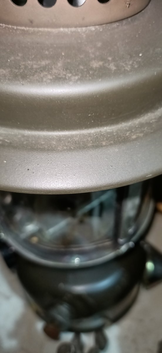

    My SMP Milspec has an original painted hood probably to save the cost of enamelling thousands of lamps that were going to get abused. It hasn't seen much use, but as you'll see the paint is suffering already. I bet after a few nights the paint would be gone, rust has started forming in some areas too. You can see the comparison with a proper hood in the last picture.

    If you say that's paint, Matt, I'll have to take your word for it. From here it looks like some sort of metal treatment - BZP (bright zinc passivated) or something like that anyway.
    But it only goes to show, as has been said already, a lamp hood is an extremely harsh environment and no paint known to Man (well, us, anyway!) is going to withstand the high temperatures involved...

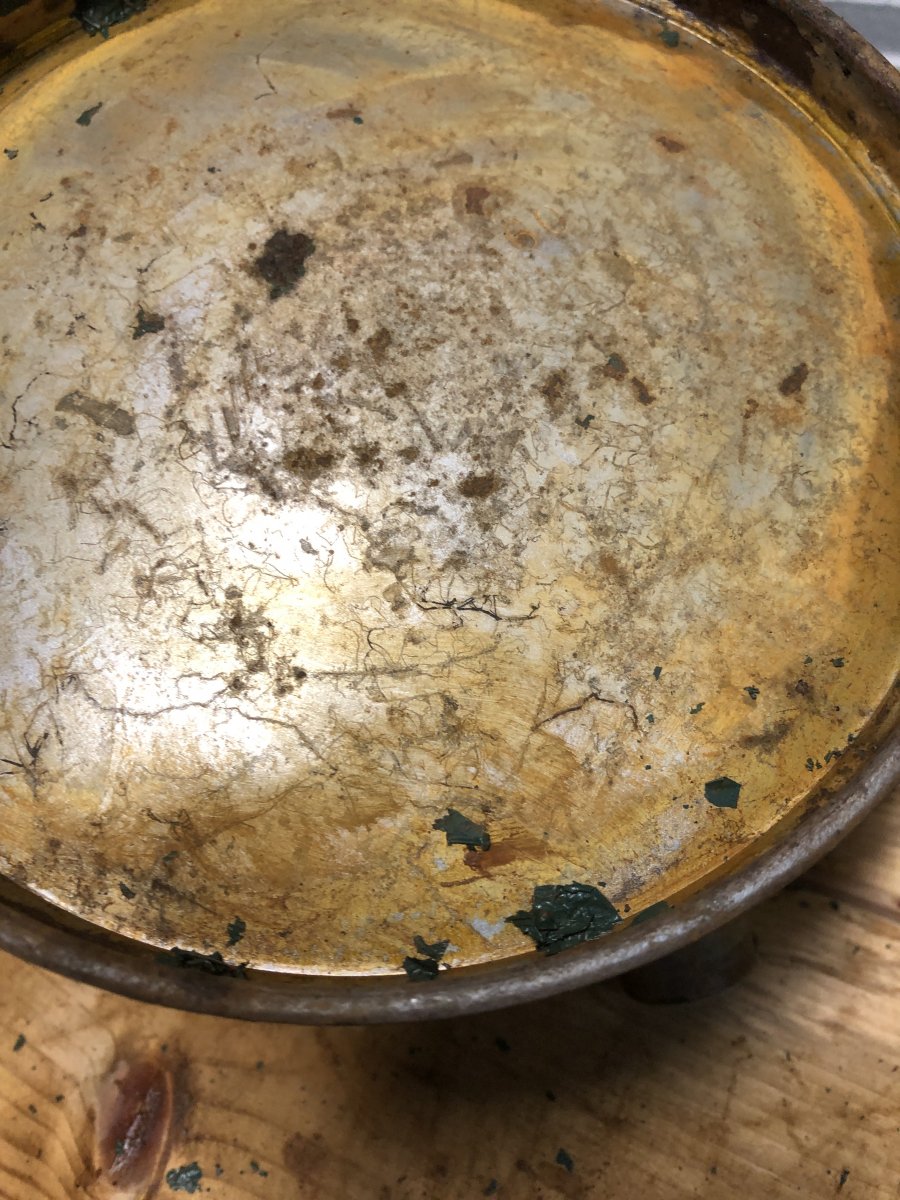

    Ok, sweet. While I’m here. This lantern I just stripped of paint has what looks like cracks. Can anyone confirm? image.jpg

    @Levi Tomey That is oxidation trough the cracked paint. You can sand it and will disappear

  24. MYN
    You mentioned you've just stripped the paint(green I supposed) and the bottom of the fount looks like that?
    Looks kind of metallic to me. Is that nickel or chrome plating having those crack lines?
    If so, then the plating's compromised and rust has already bled through.

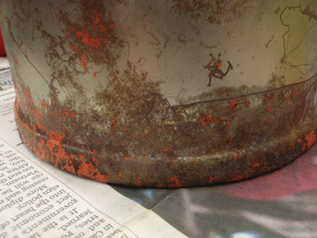

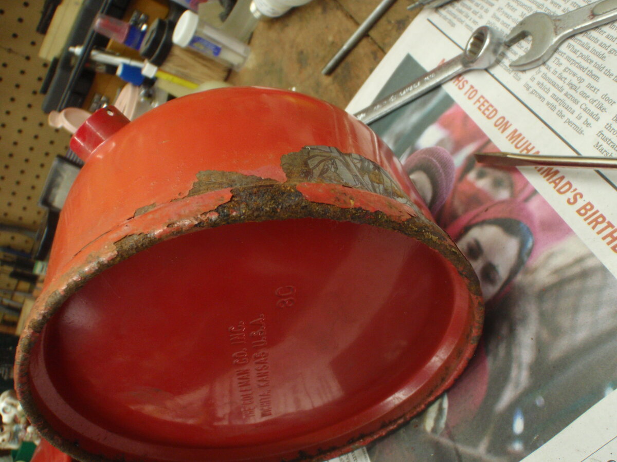

  25. MikeO
    Jan 14, 2014
    247

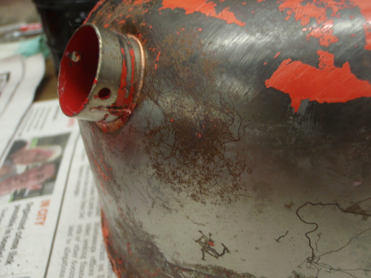

    I've had several 70s-80s Colemans get that vein-look under the paint. If in doubt, put in some fuel, pressurize and you'll know if it's a stress-crack soon enough.
  26. MikeO
    Jan 14, 2014
    247
    I'm not sure if it's just oxidation following the path of least resistance under Coleman's unprimed paint, but 222/335/635 models seem to get it to varying extents. Check out what was under the paint of this narsty 4/80 Model 206 Coleman! Unlike yours, it was the bottom that was nice.
    Mike
  27. David Shouksmith
    Unprimed steel? - you kind of get the idea these modern Colemans weren't built to last. Not like the older stuff, anyway...
  28. george
    @David Shouksmith Boy, you are so right! Disposable society! Hell, turn'em out like hot cakes, they break make some more cheap shi$! Profit, profit, profit!!
    (Get off the soapbox, George... People don't want to hear it!)](*,)
  29. MikeO
    Jan 14, 2014
    247
    I don't believe Coleman ever primed any of their lanterns--brass or steel--and the US went to steel long before Coleman Canada. Lower grade steel and poorer quality paint perhaps?
    Mike.
  30. podbros
    4,110
    ..Also the preparation before painting can be curtailed..degreasing and keying operations such as pickling?
