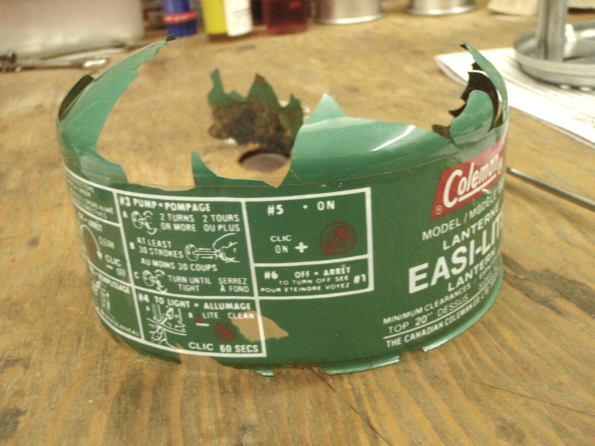

    Some of the older Coleman finishes are quite bulletproof like the Colac finishes. They're kind of ugly, so if the colac is missing it's because somebody removed it. The seafoam paint they applied to wartime lanterns and post-war lanterns and stoves can be quite fragile and scratches/wears off quite easily. Same with ivory paint applied to 1941 US 500 Speedmaster stoves. And then there's some of the crazy late 60s-early 70's 335 and 220E lanterns that they would paint after flash nickel plating the fount. On those, the paint comes off in sheets, but you do end up with a cool lantern, even if the nickel plating is a bit thin.
    But yes, I think some founts got better cleaned of manufacturing oils/residues, better batches of steel, better batches of paints, and better surface prep. Poor paint adhesion is not just a modern thing when it comes to Coleman. Definitely worse though! Check out this 222 where the clear decal and some poor storage pulled off the paint in a crazy relief of the fount...

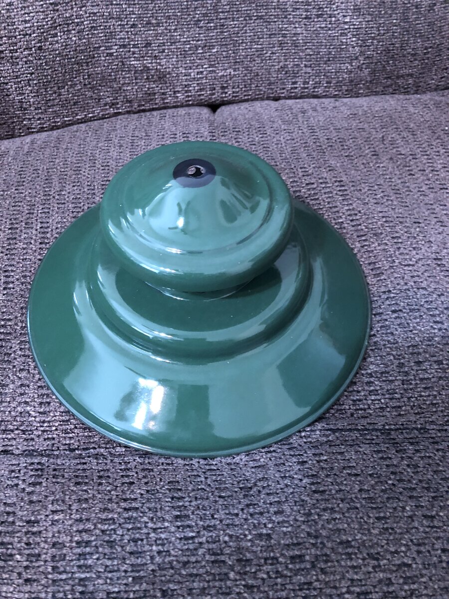

    Ok, one reply for everything. If you do your own nickel playing it’s actually cheap. The bottom of my fount was actually kinda decent. Those crack looking things are all over the fount. I ended up buying a mint ventilator. And because it’s already a mishmash of spare parts all over eBay, I’m going to nickel plate the fount because it looks cool and let me tell you my grandfather was a huge fan of chrome and I don’t want to shed the money for chrome plating. Also, no it is not nickel or chrome plating under the paint that had those cracks as far as I know.
