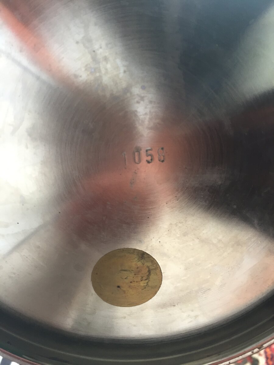

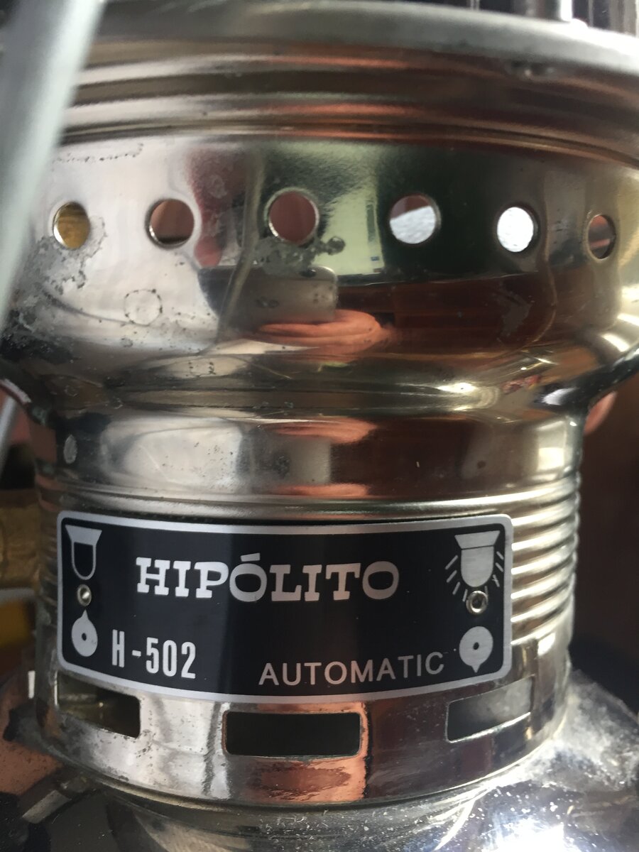

    Hipolito 502: IMG_4329.JPG IMG_4330.JPG

    @Fireexit1
    1058
    In my opinion it is 10th week 1985

  5. Fireexit1 United Kingdom
    3,538
    @Reinhard Thank you. Your proposed date matches the "feel" of the lamp in terms of finish and condition.It has not seen a lot of use and has no rust at all under the hood. It has suffered a small crack in the J tube that has resulted in some soot/discolouration under the hood. otherwise in great condition.

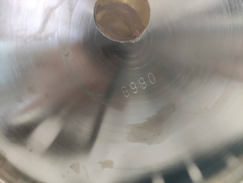

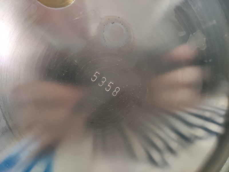

    Mar 18, 2015
    33
    Denmark
    This is quite interesting.
    I have several Petromax lanterns that were easily dated using the code of the sixties, but my three
    Hipolitos could until now - potentially be from any time in the apx. 30 years of production in Portugal.
    My Hipolitos are stamped 1189, 5358 and 8990.
    1189 = Week 11 1989 (Using @Reinhard code - which makes sense)
    5358 = Week 53 1985 (Here things get slightly muddy - a 1985 calendar shows only 52 weeks that year, but it could reasonably translate to the 30. or 31. of december, as week numbering vary with time / country)
    8990 = 1989 or 1990 (I take it, but what about the week number then?)
