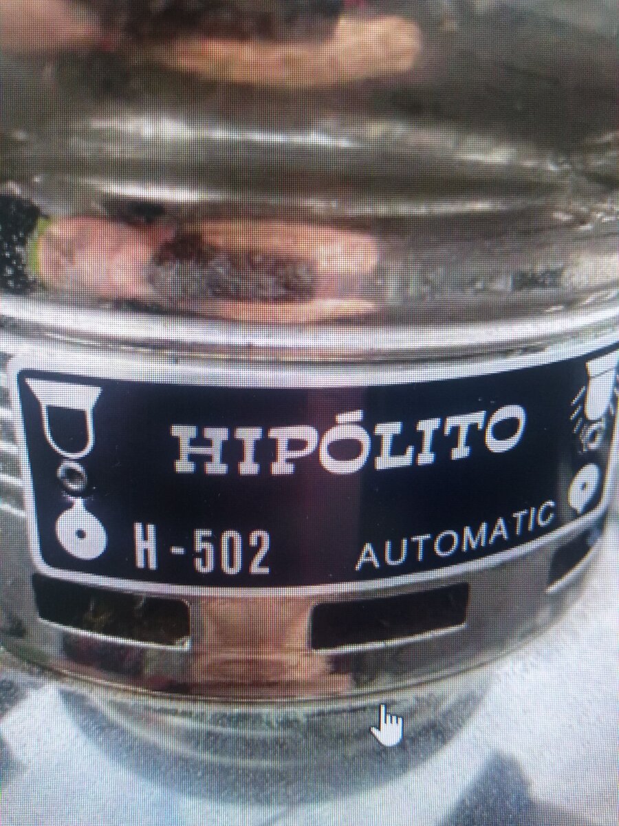

    Hi Everyone,
    Received today my latest acquisition, a Hipolito 502.
    The number stamped on the bottom reads 2068, which, from reading this page, I decoded as week 20 (May?) 1986, happy to be corrected if wrong.
    Will post in the Reference Gallery once I've taken some pictures.
    Tim

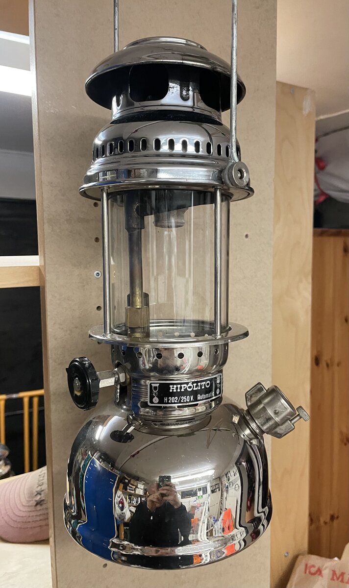

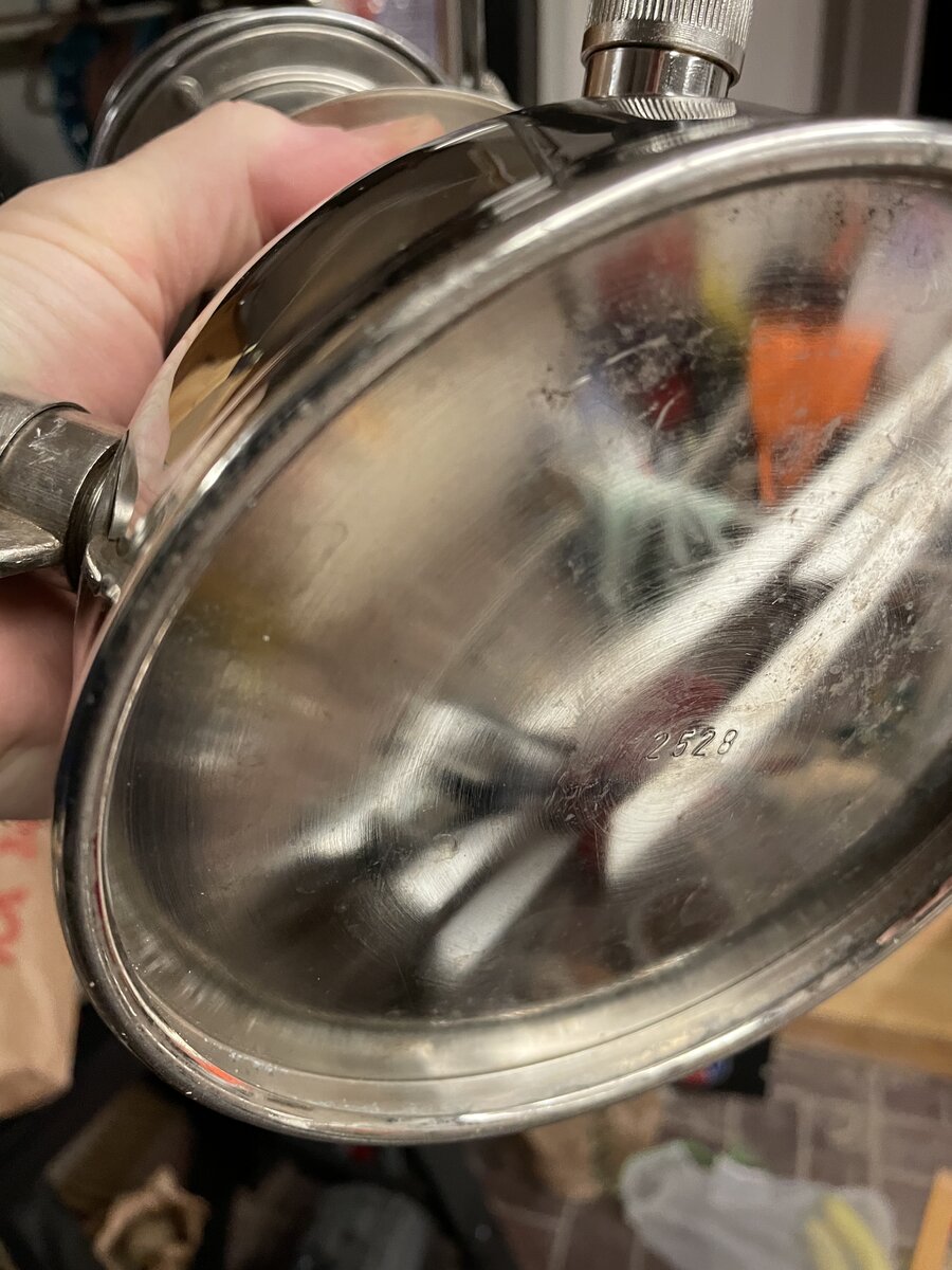

    I am answering an older post I know. Here’s my info regarding the Hipolito lantern I own.
    Number are 2528.

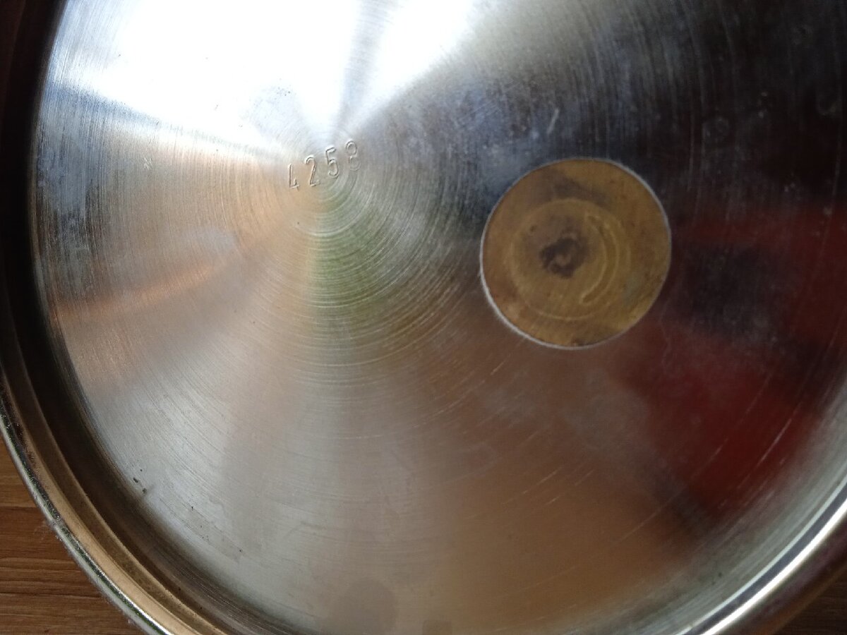

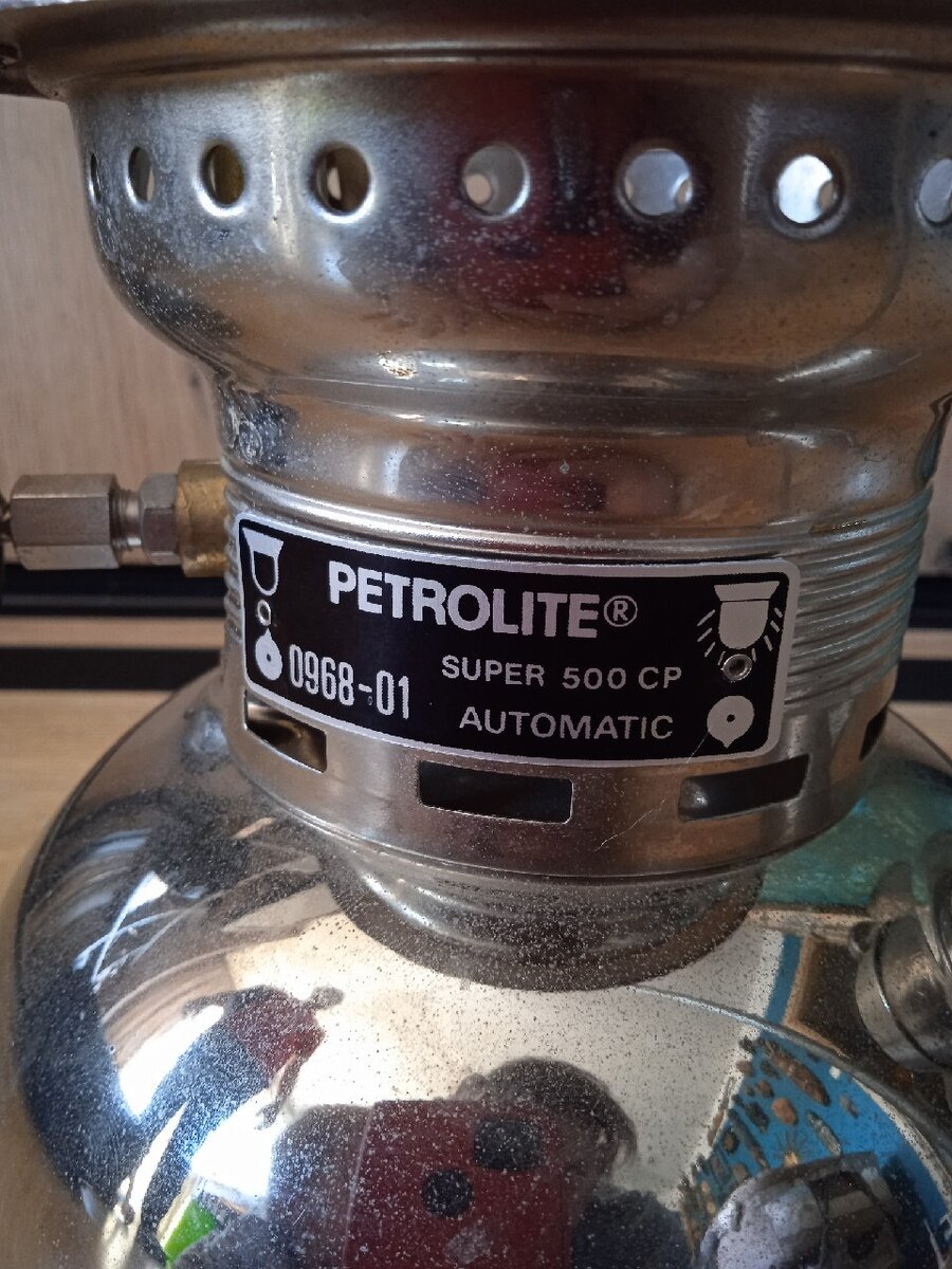

    This is not my lamp. Pics stolen from Interned for the sake of science:)

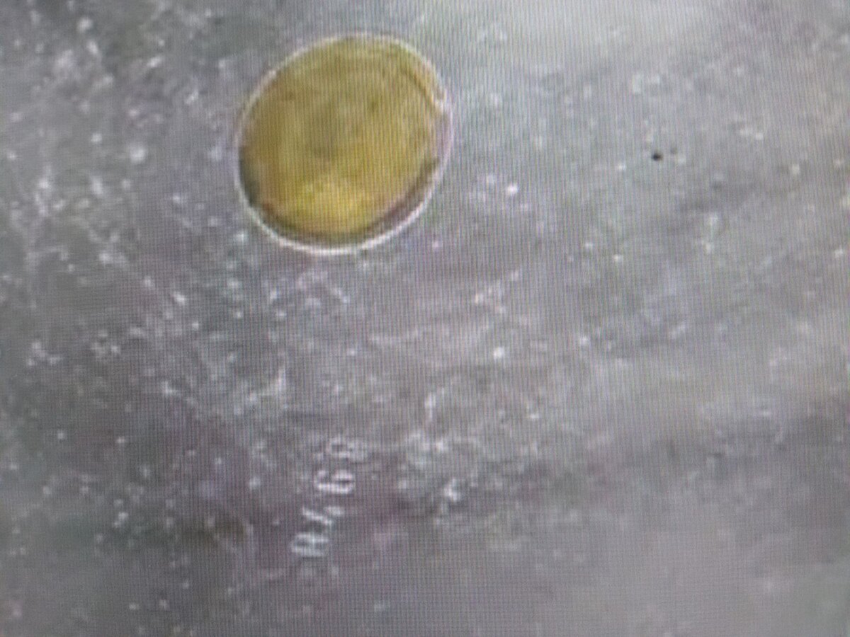

    Poland
    And another one.
    8978 ?

    @Piotrek
    The Hipolito number is hard to read and you read it upside down .
    It is probably 0468 = week 4 year 1986

    @Piotrek
    The Petrolite 4258 is made in week 42 year 1985
    @Matti Kucer
    The Hipolito H-202 is made in week 25 year 1982
