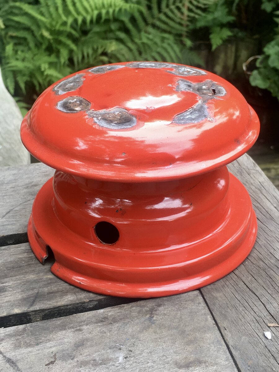

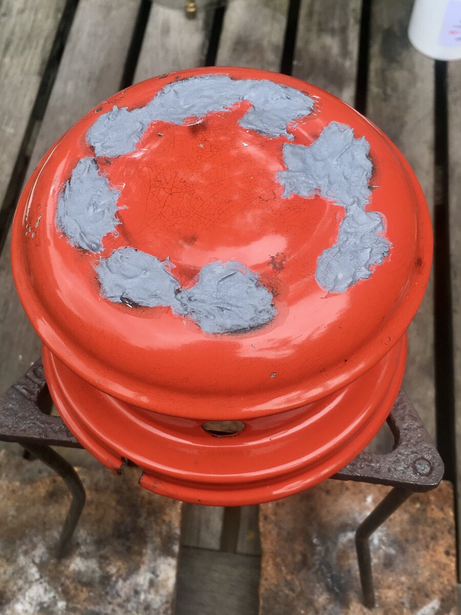

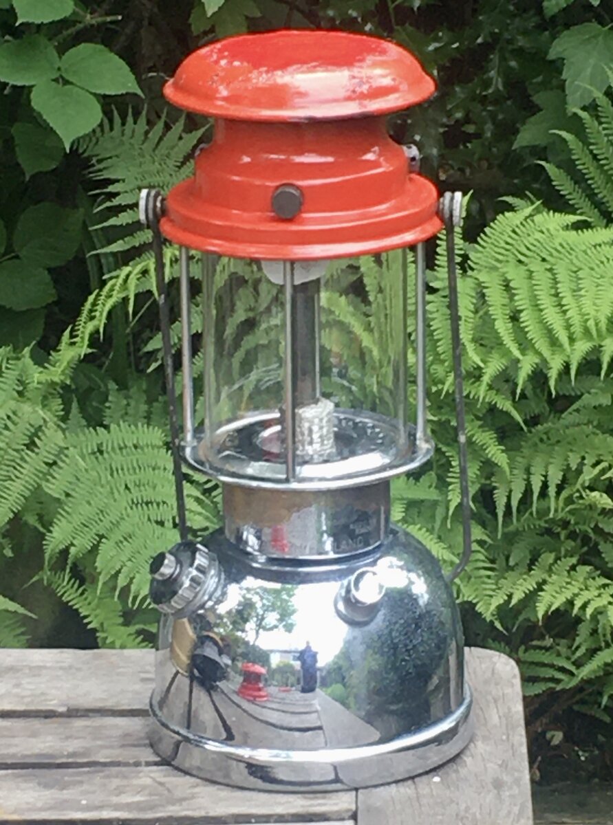

    Having done a bit of hood enamelling with a blowtorch, and witnessed the effect of heating and cooling of enamels on their bond to underlying metal, even when it’s sound and not rusted, I suspect there’s always a posibility that cracks in the enamel can develop and subsequently flakes of enamel detach themselves. I’m referring here to normal heating/cooling cycles of a lantern even without the detrimental impact of rain and water ingress.
    The enamelling process on a very damaged hood.
    984BCF16-569A-4872-AD9B-E0BA975F23B5.jpeg 3CA30EB6-B1D0-4AB9-BB5A-2EA33D3F7E86.jpeg 4360E2D5-759D-470D-8757-A0455F830495.jpeg 3C1BBDD8-4BB6-4587-A7F4-31E7EA0DD19B.jpeg
