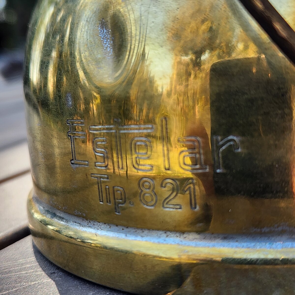

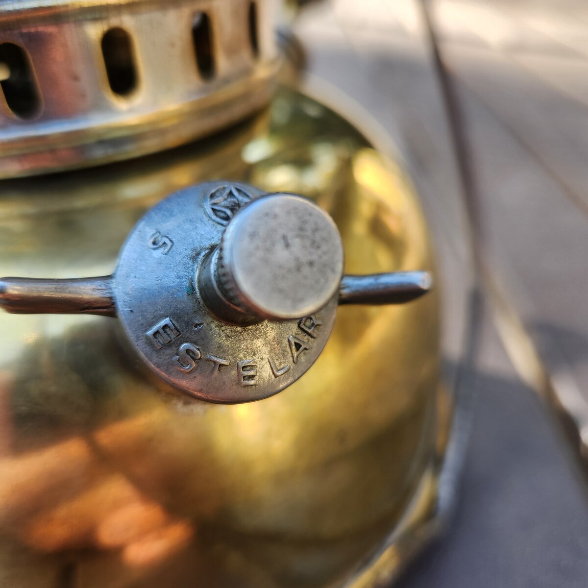

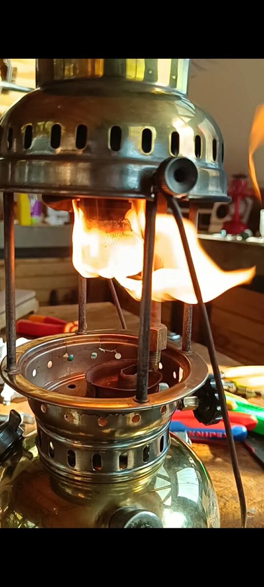

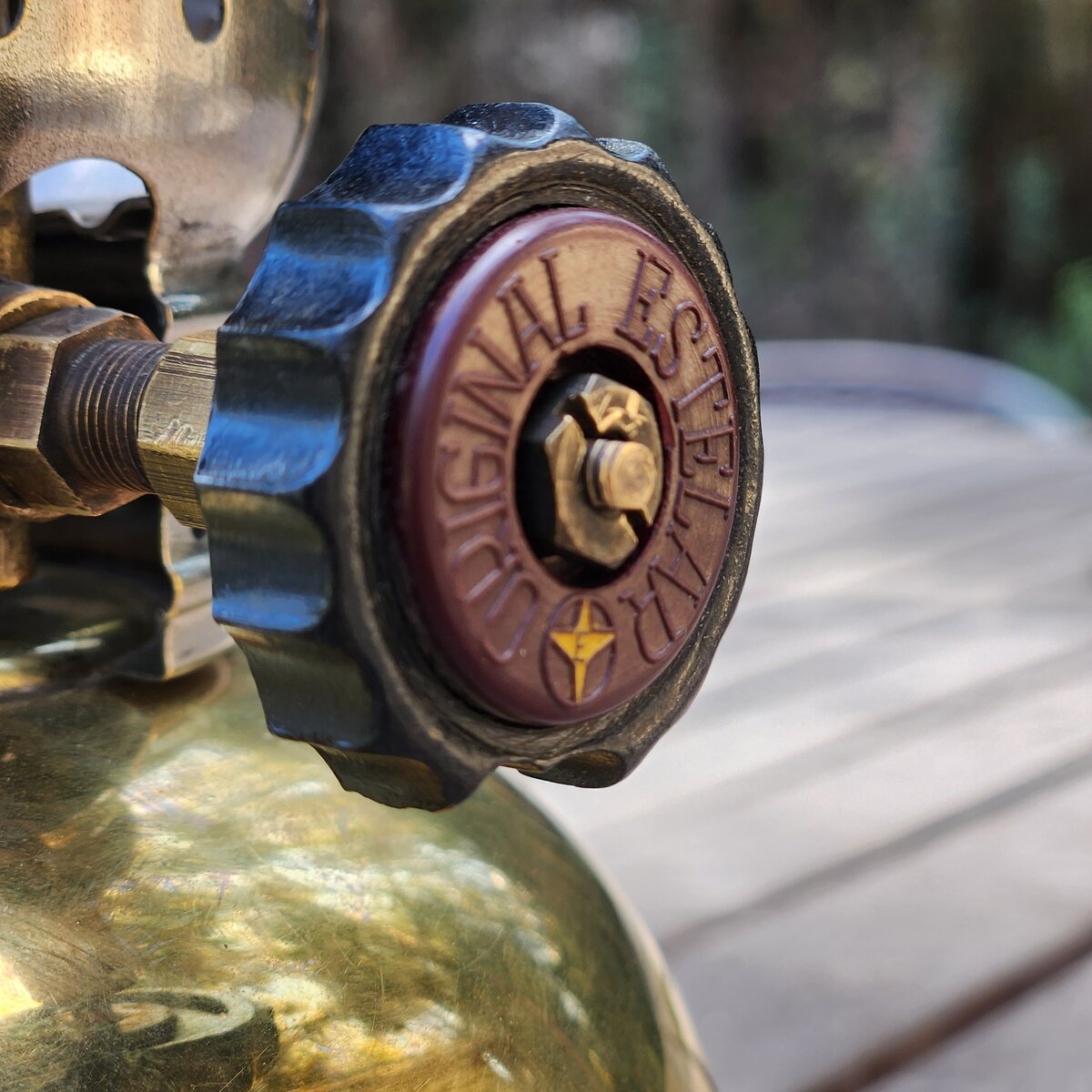

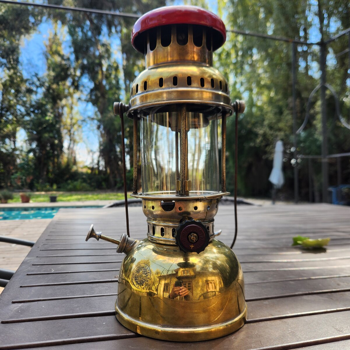

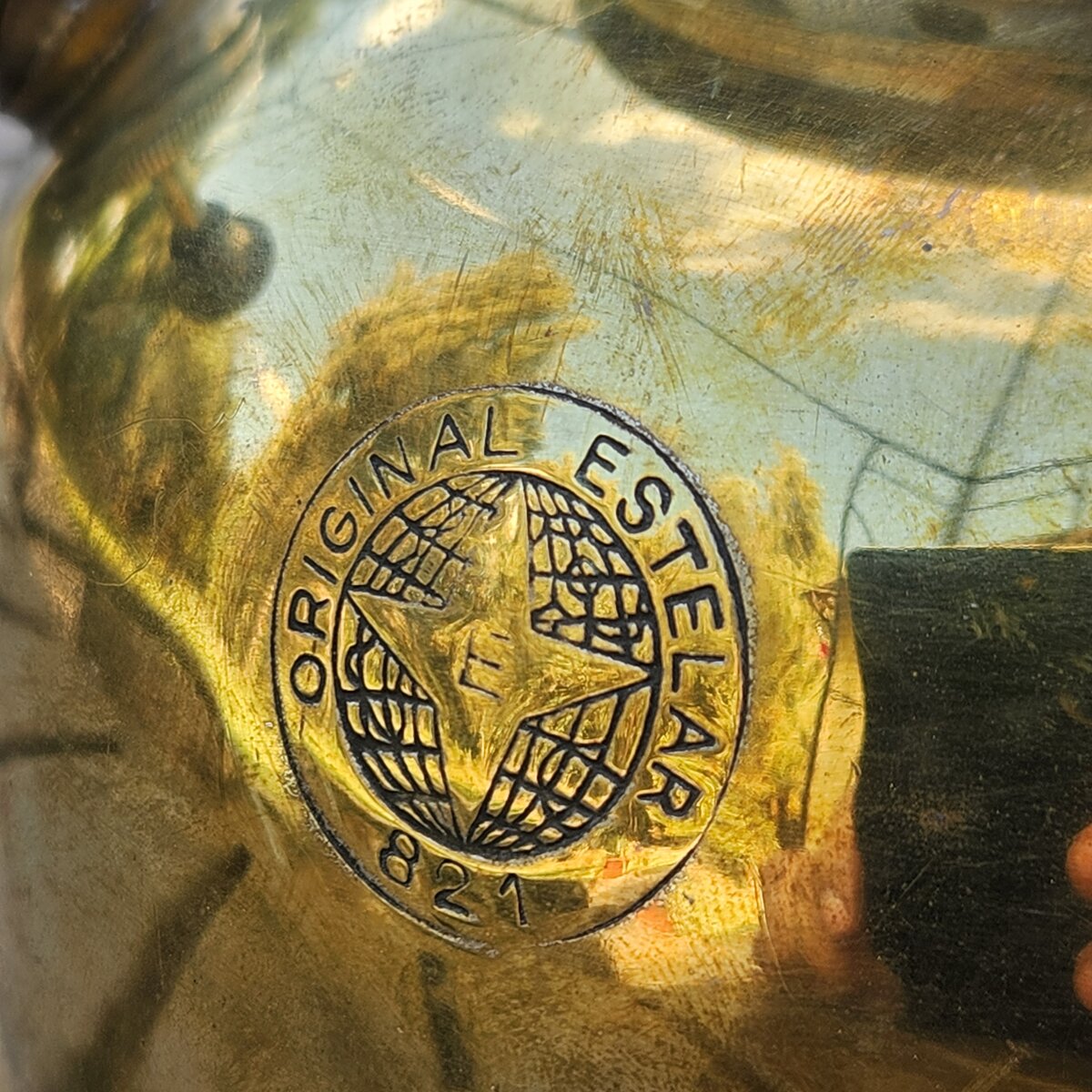

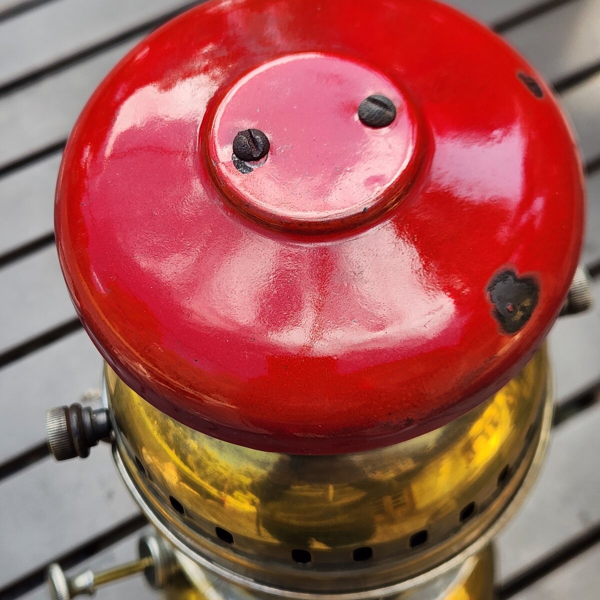

    Hi Folks, I haven't posted here in a while, but today I bought this lamp for about 35 euros. It turns on, but I think there's some problem with the generator.
    I'm sharing some pictures, including one of the lamp lit up.
    Perhaps you have any suggestions. I'm not familiar with the history or quality of the Estelar brand.
    Is it as good as an English or German brand?
    Cheersfrom Chile Southamerica

    Reinhard Germany Subscriber
    Oct 15, 2018
    1,090
