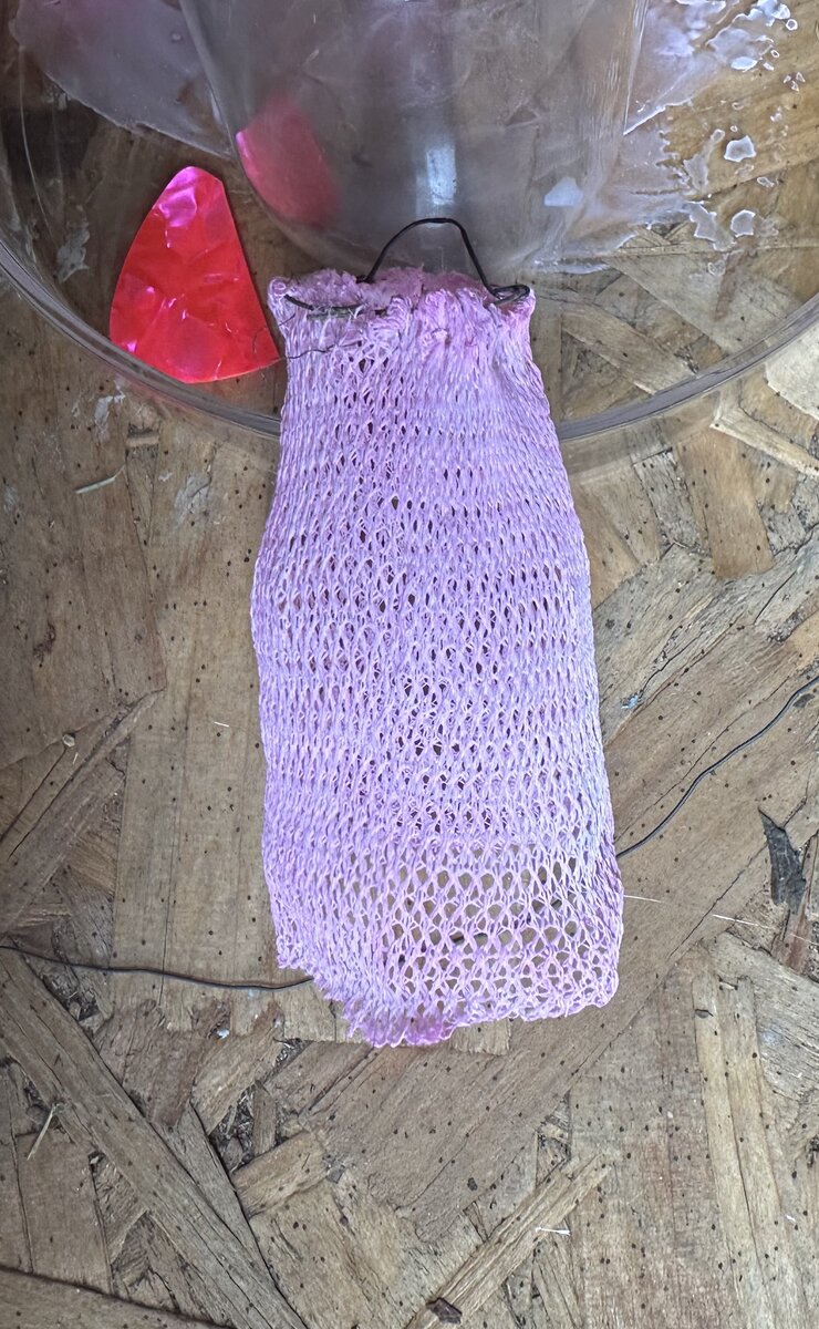

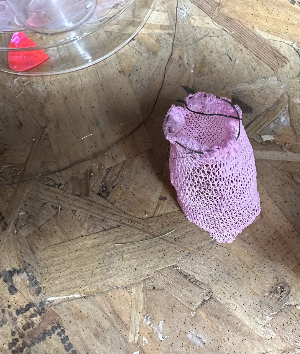

    Thanks for the compliments, I may plan on making a proper mantle holder in the future but right now I’m trying to mastering the art of the incandescent mantle making. Pre burnt cone shaped incandescent mantle is notoriously hard to make due to the distortion of the skeletal ash structure due to the shrinkage of organic material during pyrolysis. I found the best way to strengthen the top of the mantle ring is to apply a solution of aluminium, magnesium and calcium chloride solution with a ratio of 1:1:1 with a concentration of 5%. Then convert the chloride to hydroxide by dipping the unburned mantle fabrics in a jar full of ammonia gas. The doping shown above slightly reduces the luminosity of the top section of the mantle but the strength increased considerably.

    The burnt mantle could be protected and strengthened by dipping the burnt mantle into a thin solution of collodion which my recipe is 50% acetone, 40% diethyl ether engine starting fluid and 10% denatured alcohol. The source of the collodion is a cheap flammable guitar pick. After the treatment the bottom of the mantle can be trimmed easily without damage with a sharp pair of scissors.
    I’ve attached some images of a smaller cone shaped mantle which I made for my DIY upright Bunsen burner.( you can notice the smaller diameter than the standard large cone mantle for the kerosene lamp.)

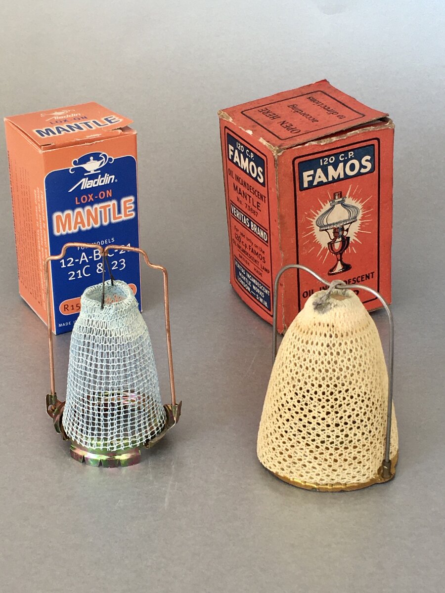

  4. WimVe
    3,542
    You can also use hairspray.
    Mind the distance due to the lacquer pressure.
    Shape compare:
    [​IMG]

    That is quite helpful for the shape of the origional 120CP cone shaped mantle. The 120CP mantle seems to be far larger than the aladdin loxon mantle size by comparison since 120CP is more powerful than the aladdin 40CP? The weave of the mantle of the 120CP has a much smaller pore size compares to aladdin with the similar top opening sections. Hair spray will work to an extended but nitrocellulose guitar spray works better as when it burns off it does not emits as much of an odour and smoke as hairspray will.
