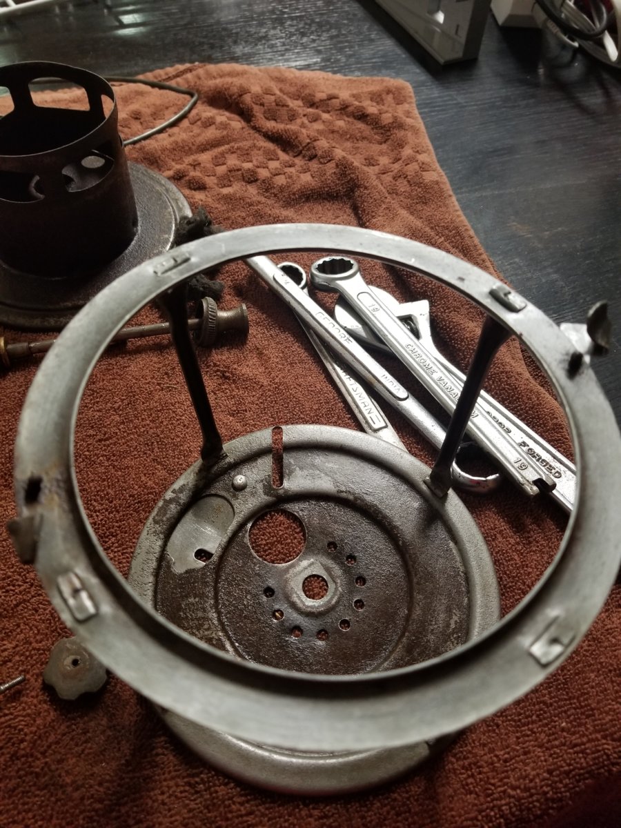

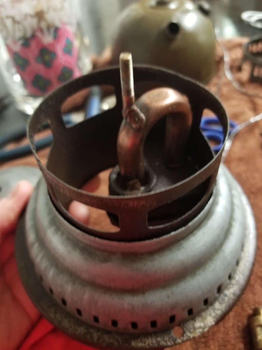

  7. LanternTom
    Apr 19, 2014
    305
    Hebron, Indiana
  8. WimVe
    3,529
    Well take good care of the tank. It looks in need of some rust removal and preservation.

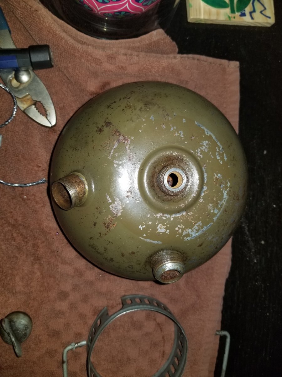

  9. Reinhard
    Reinhard Germany Subscriber
    Oct 15, 2018
    1,090

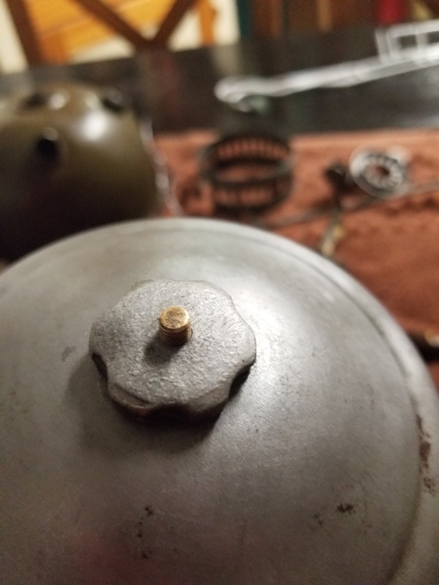

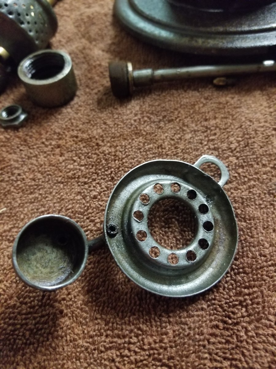

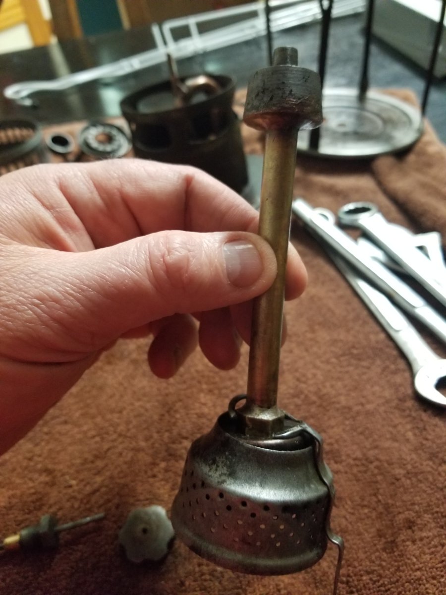

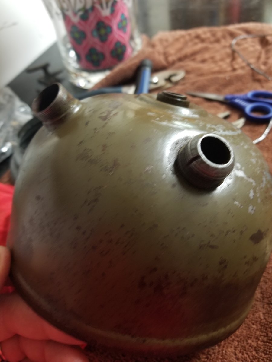

    @LanternTom

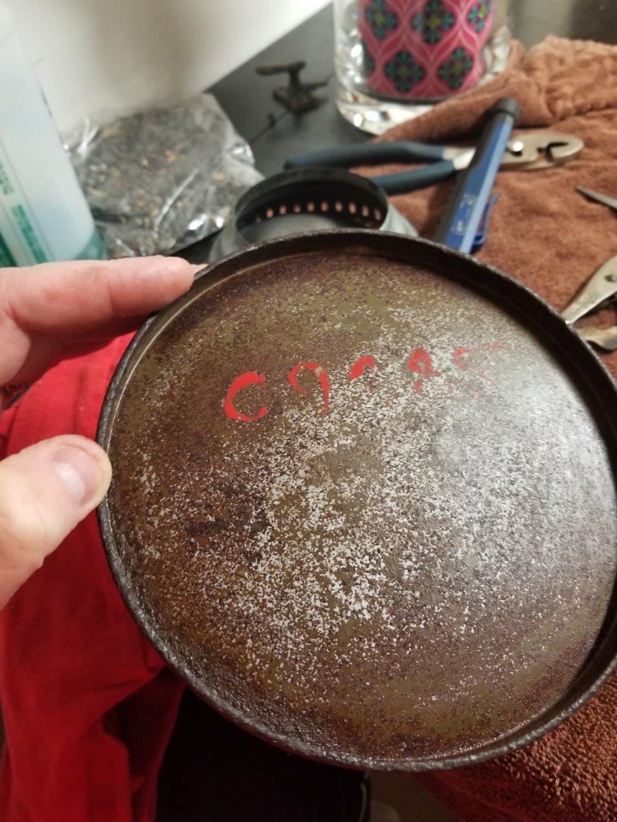

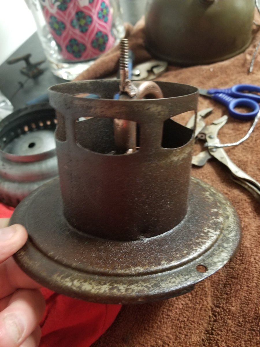

    Please take a picture of the tank top and a picture of the complete pump. Pump cover,Pump button.
    Regards Reinhard
  10. LanternTom
    Apr 19, 2014
    305
    Hebron, Indiana
    @Reinhard
    Here are pictures of pump and tank

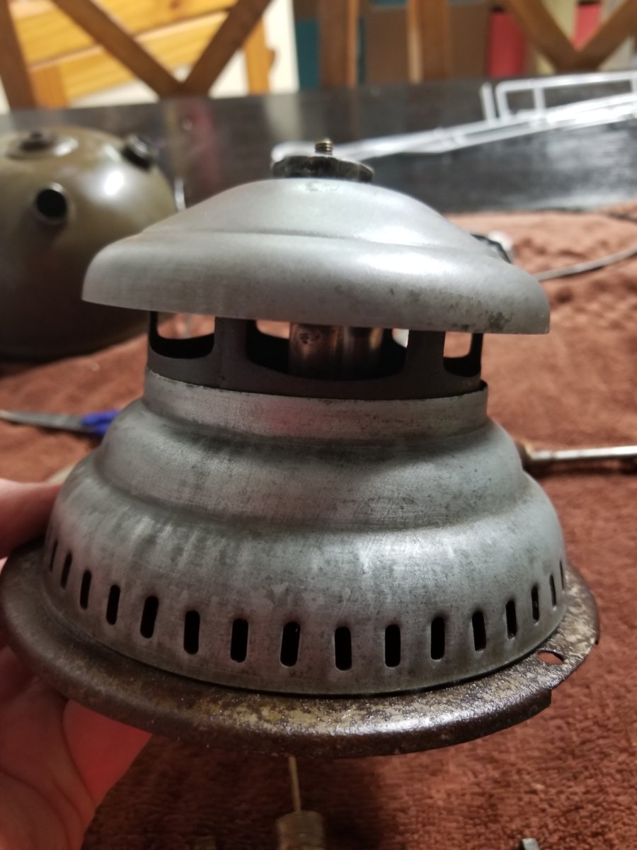

  11. Martin K.
    Martin K. Subscriber
    Sep 20, 2013
    1,148
    Well, overall this lantern looks a bit odd to me. Surely it could be regarded as a Hasag 351L, but there are some details I've not yet seen on Hasag or Mewa (VEB Leipziger Werke) Lanterns:
    • the small preheater funnel outside the globe cage is only known at Ditmar and Swiss Hasag (Eugen Schatz/Meinrad Aschwanden)
    • the hood nut looks different to any Hasag/Mewa I've ever seen
    • the shape of the top of the Vaporizer is even/straight (not a "mushroom" shape)
    • the filler cap looks totally different
    • the pump handle and the tube cap look also differently
    • the cover of the chimney is punched not very accurately
    • The handwheels seen on these lanterns are often made from reddish fainted plastic, not from fibre, Bakelite, or cardboard.
    To my guess it is some rare lantern that seems to show up from time to time in the Baltic states. From that point I believe that it was made somwhere else, but not in Leipzig/Germany.
  12. LanternTom
    Apr 19, 2014
    305
    Hebron, Indiana

    A help in identifying the tanks are the pumps.
    The pump caps always fit only on the associated pump cylinders.
    They all have different diameters.
    They are not compatible with each other.

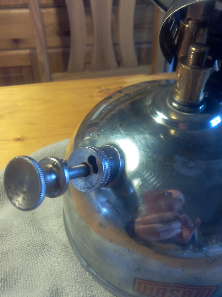

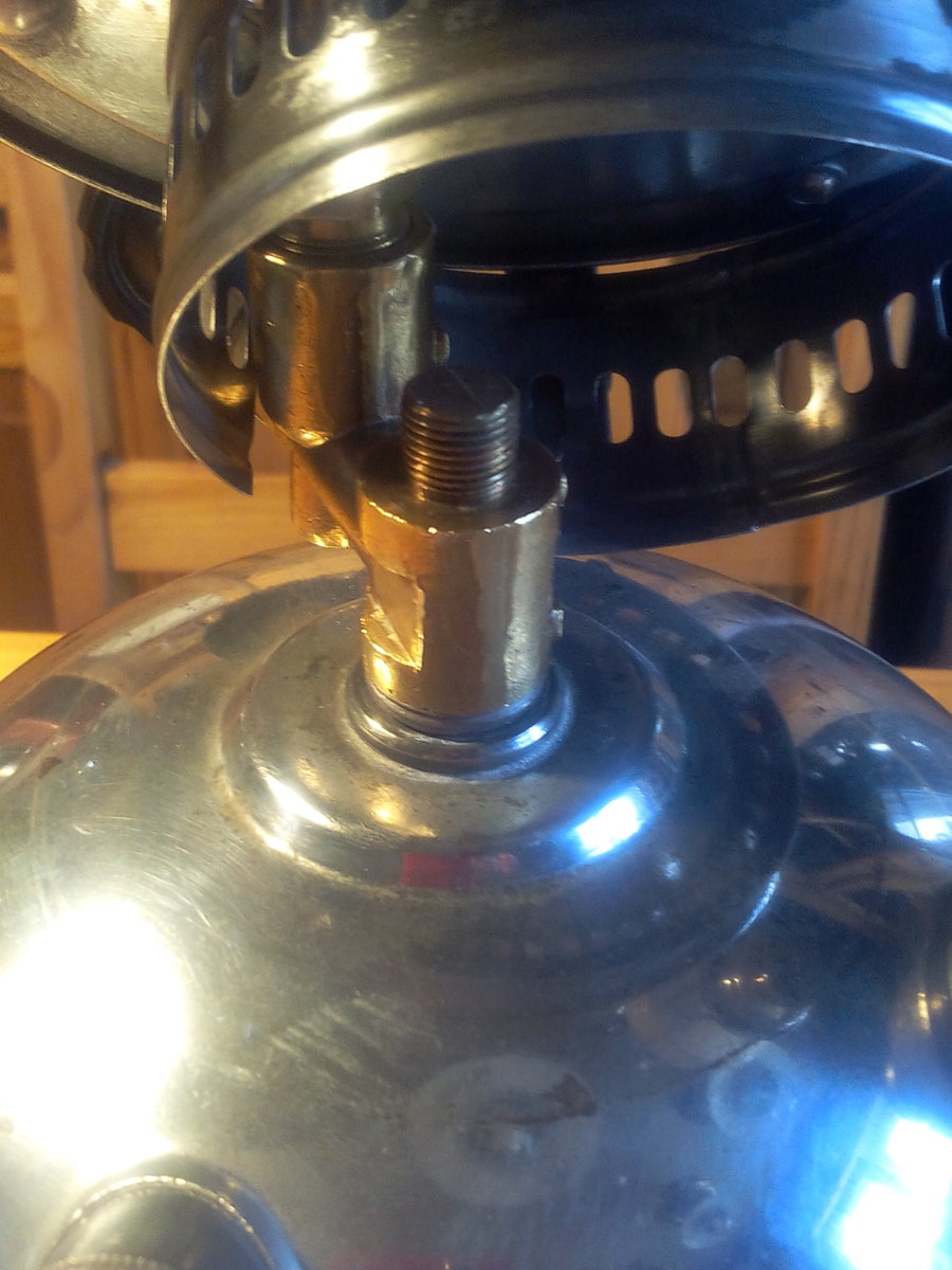

    @Reinhard
    That is exactly how my valve looks with the notch in it for a wrench. Sounds like i have a mixture of stuff...
  18. Reinhard
    Oct 15, 2018
    1,090
    All successor models of the Hasag 351L also had this notch for the fork wrench.
    Please show some pictures of your complete valve.
    And also of the handwheel shaft with all small parts.
    Regards Reinhard

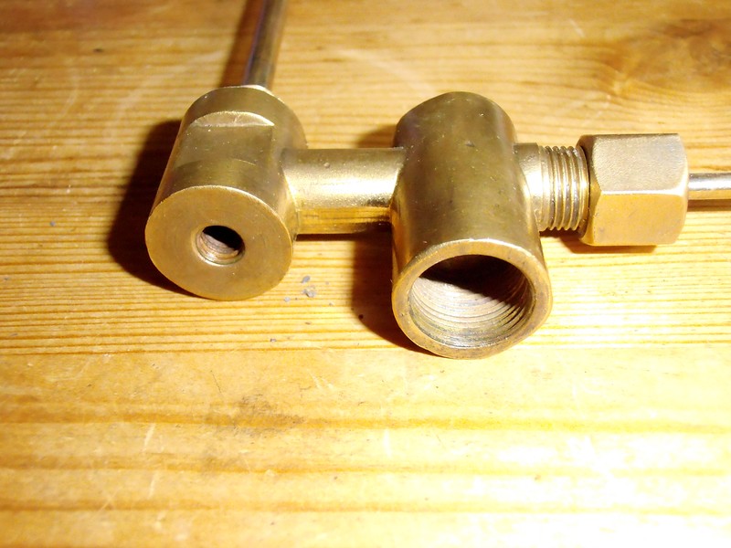

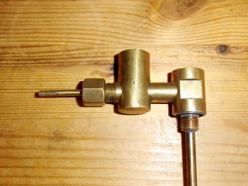

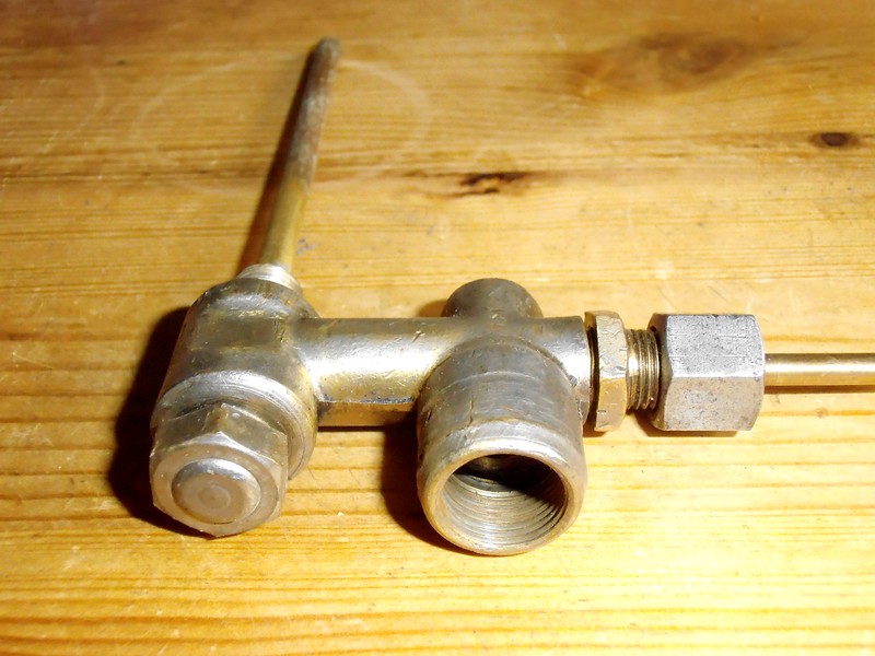

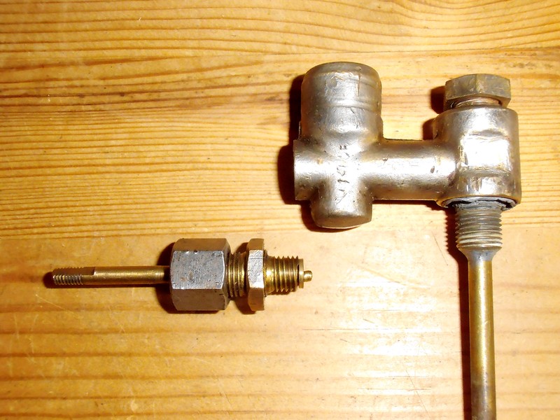

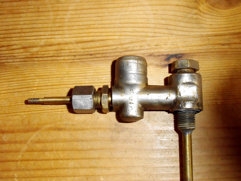

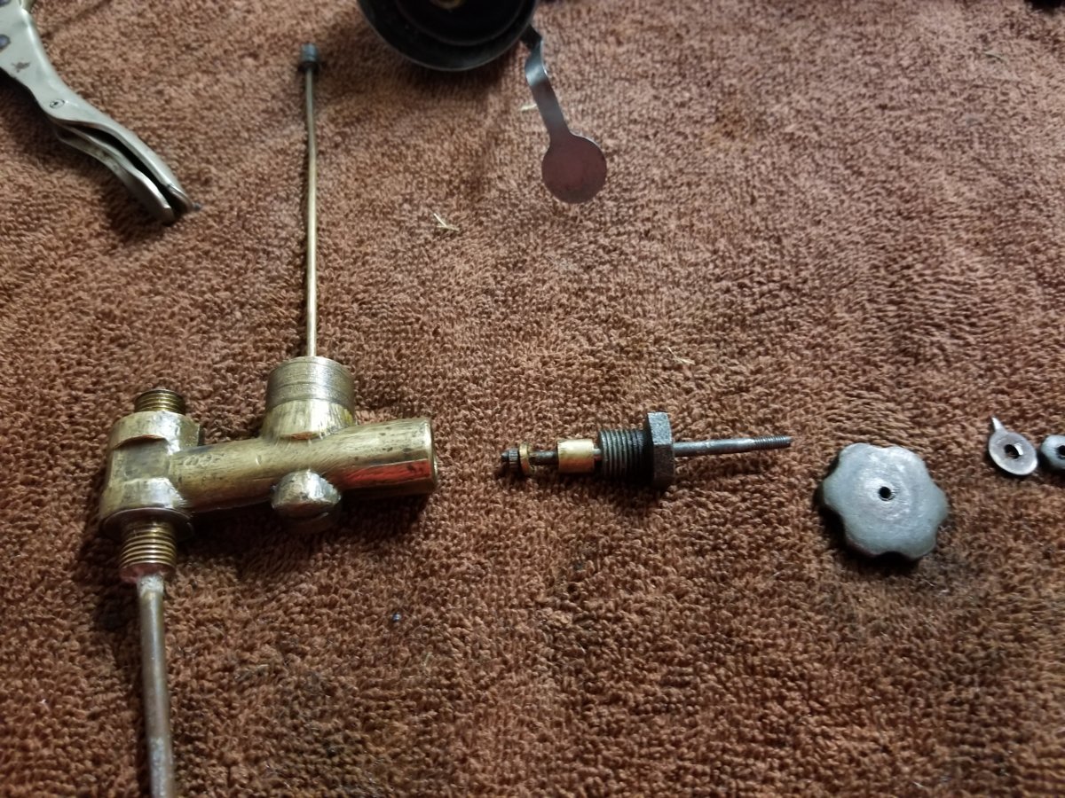

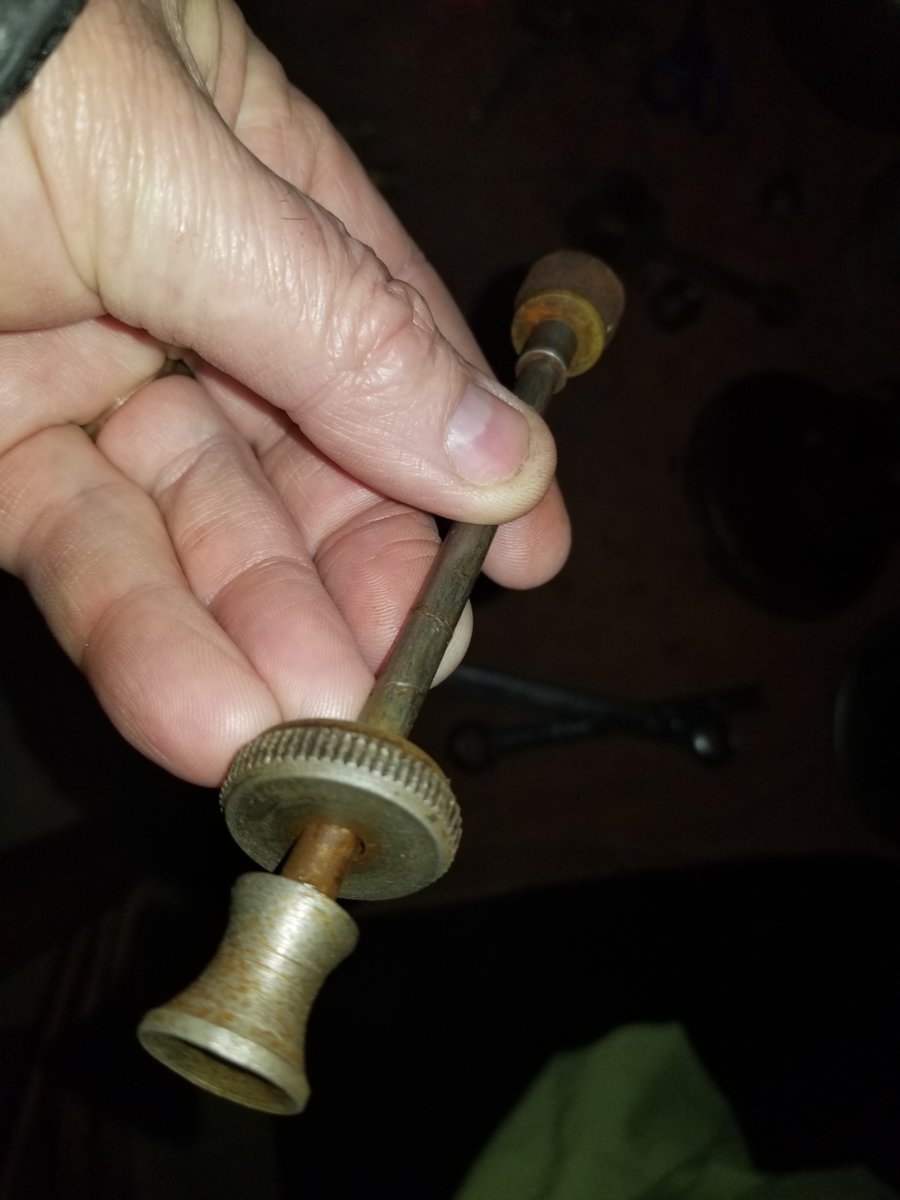

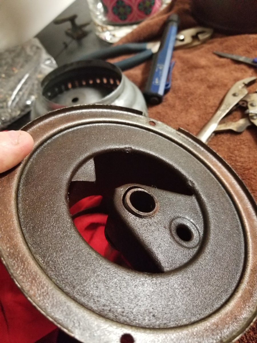

  19. LanternTom
    Apr 19, 2014
    305
    Hebron, Indiana

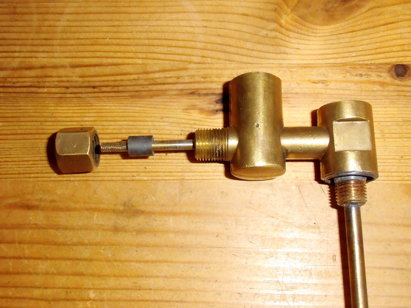

  20. Martin K.
    Sep 20, 2013
    1,148
    ...now that's another interesting detail which is odd: At a first glance, your part looks nearly like the Ditmar style, where the gland packing is located inbetween the small disk and the sleeve on the shaft, and then commonly inserted into the lower part of the vaporizer:
    A difference is the gland nut at the Ditmars, and the screw at yours.
    In comparison to that, at the Hasag parts use a separate piece with the gland packing to be screwed into the lower part of the vaporizer:
    Moreover, the Ditmars use a screw to fix the base plate of the globe cage, whereas Hasags use a nut, like you can also see on my photos. The diameter of the shaft is (nearly) equal at the two makes. So your part is some kind of a hybrid, which I've never seen on any Ditmars, Hasags and lanterns of VEB Leipziger Werke.
    Regards, Martin

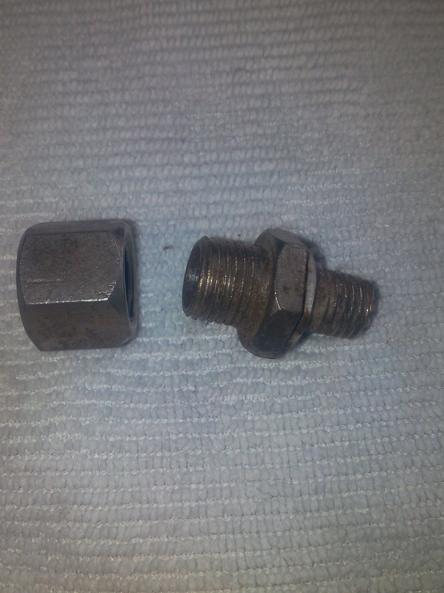

  21. Reinhard
    Oct 15, 2018
    1,090
    That's really interesting.
    The eccentric nipple has thread only on one side.
    The eccentric nipple of the Hasag 351L had a thread on both sides and a union nut. (K 249 and 251)
    Regards Reinhard

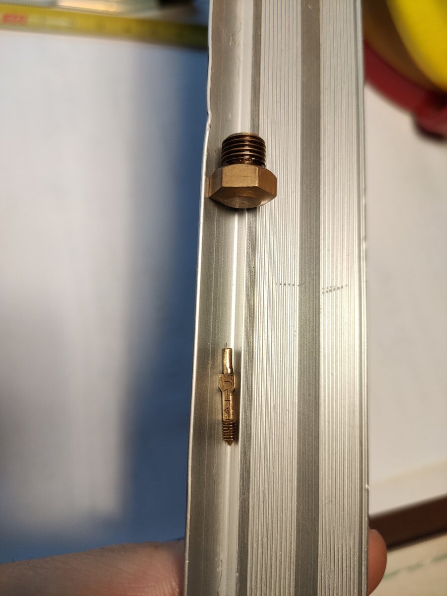

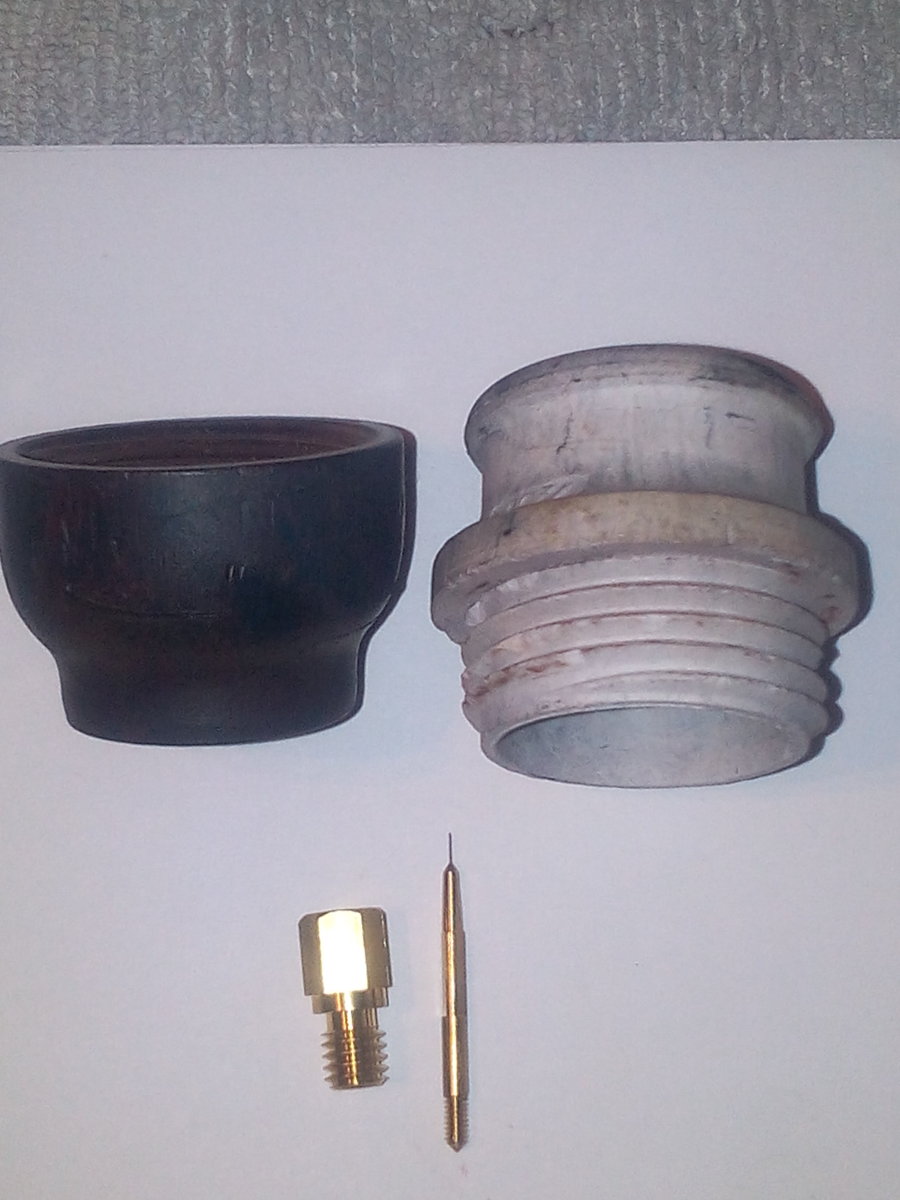

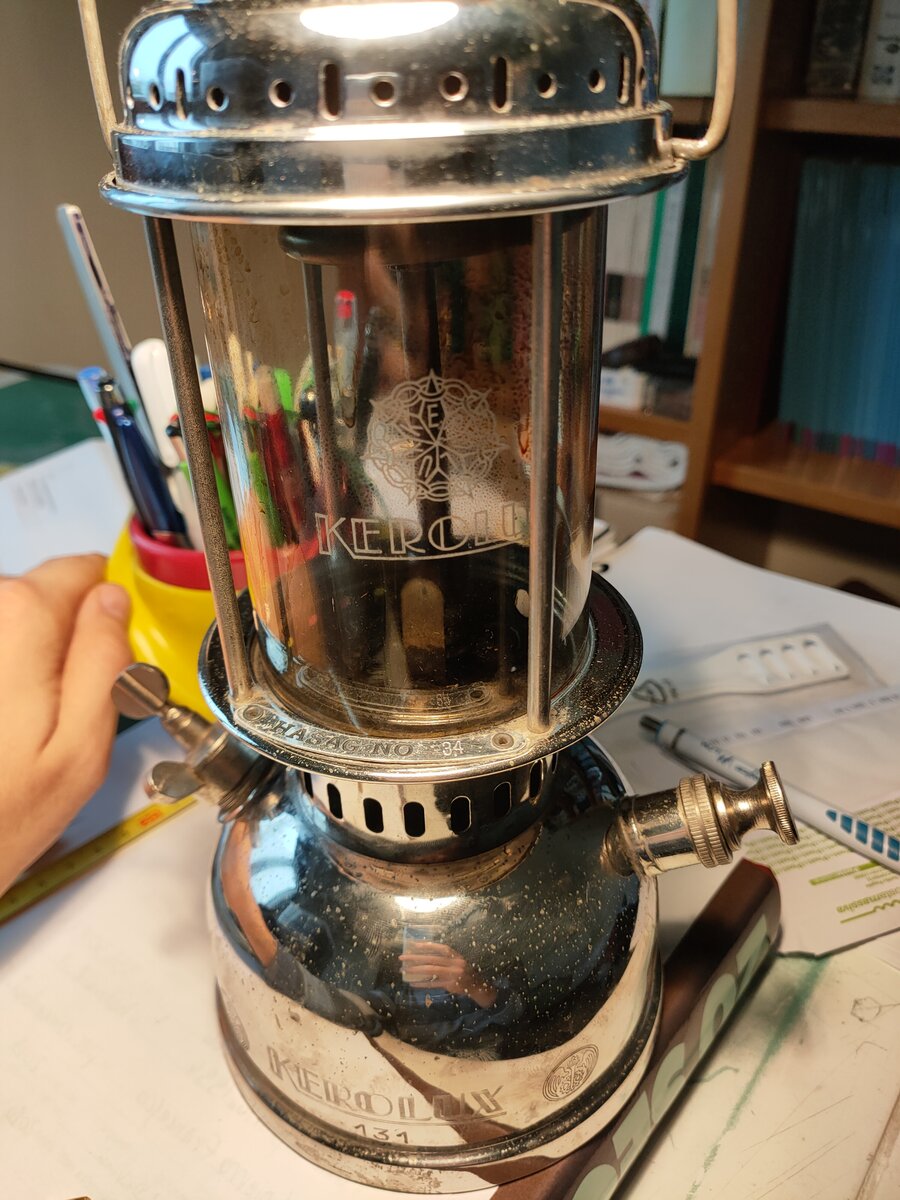

  22. Francesco94 Italy
    Dec 26, 2020
    3
    Italy
    Dear Reinhard I see in this post you are a real expert about Hasag lamps.
    Could you help me? I have a very old Hasag lamp and I want to make it function again but I have some problem :
    -i need another needle for the carburettor nozzle , is it a 0,11 mm isn't it?
    -i would like to understand the model of the lamp
    Thank you very much :)
  23. Reinhard
    Oct 15, 2018
    1,090
    @Francesco94
    The real expert is my friend Martin K. I only have a few 351L and one 51A,but that's 300HK lamps. Your Hasag is a 100 HK lamp. The threads of the Jets and needles from Hasag and Petromax are not compatible.
    Regards Reinhard
  24. Francesco94 Italy
    Dec 26, 2020
    3
    Italy
    Thank you very much Reinhard , then I will wait for @Martin K. 's reply :)
    On the second picture i have posted on th needle it's printed the number "11": what does it mean? Is it the size of the needle(=0,11mm)?
    Is there a way to make or replace that needle?
    Thank you very much , it's my first experience on the pressure lamp world :)
  25. Martin K.
    Sep 20, 2013
    1,148
    @Francesco94
    this is certainly a cute little lantern from the pre-war Hasag manufacture in exceptionally good condition. It is a Hasag No. 34 rated at 100HK, and technically almost identical to the Petromax No. 900 "Little Baby". You can find both of them here in the reference gallery. The brand "Kerolux" (registered by Hasag in 1935) marked on it was intended for export abroad.
    Nowadays it is almost impossible to get suitable spare parts for those (except the glass cylinder, so be extra careful with the original one), and the jet has a different thread than the 150HK types still available from China. The needle/wire diameter could well be 0.11mm, as the orifice diameter in the jet should be 0.12mm @100HK (0.14mm @150HK) for kerosene/paraffin. The only thing you can try is to get the original jet free (e.g. by ultrasonic bath) and maybe obtain spare parts from the Korean seller "Lovelantern2014" on Ebay, who offers small needles. So you could try to adapt those intended for "Ditmar 100" or "Phoebus 615" as possibly the closest match. However, these are not exactly a bargain.
    Please make sure to service it thoroughly, replace the gaskets/seals which may have hardened over time, and clean the vaporizer and tank in order to get it running properly. These small lanterns are somewhat sensitive to improper settings or other shortcomings.
    Regards, Martin
