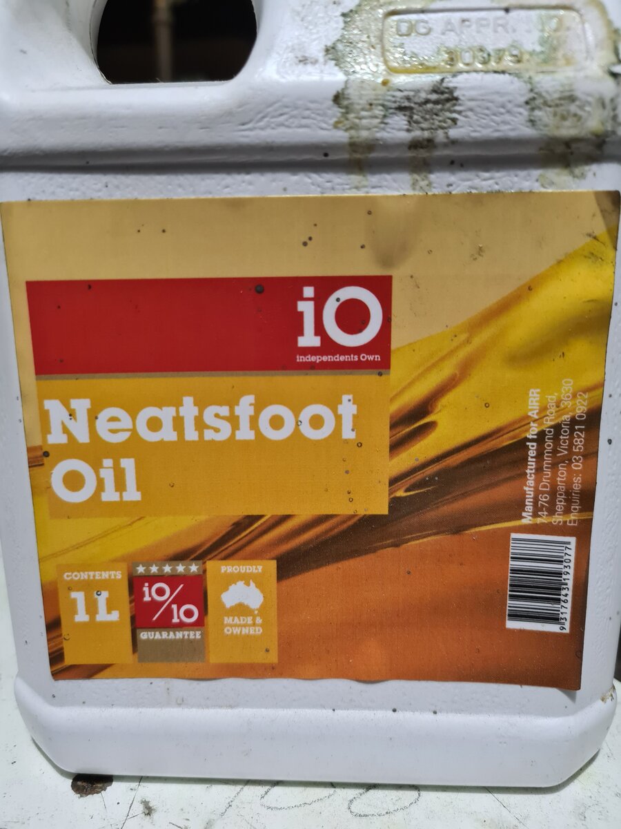

    G'day mate welcome aboard, nice TL14 interesting colour looks great, I find the best oil to use on pump leather is Neatsfoot oil, its used on horse saddles.
    I have saved many leather pumps, ones that you would think can't be saved at all, this stuff is amazing, here is a photo.
    Good luck mate.

    @Buggerlugs Thanks for the tip. The olive oil worked well, but I'll bear this in mind should I have further difficulties!

    Yes, neatsfoot oil is highly recommended for leather and I use it myself. I can't say I've noticed it's any better than, say, olive oil so perhaps the benefits are more in the longer term.
    It's much less easy to obtain than the various oils found around the household and a good bit more expensive. I got a 500ml can from a traditional cobbler for about £6 IIRC but that would have been 10 years ago at least. Having said that, 500ml will last several lifetimes if it's only to be used for softening pump-leathers.
    Yer pays yer money... :)

    I get my neatsfoot from equestrian centres. Finding "pure" neatsfoot can be tricky as mostly it comes as a "compound" no doubt with drying and glossing agents.
    I use it for restoring all manner of old dried out leather.

    I've done some research and I can get 500ml of Neatsfoot for around £5. Looks like it's also worth investing in if you have a lot of shoes (and I do!).

    Neatsfoot is what Coleman has recommended for an eternity and also what you get in their cute little squeeze tubes so that you poke them in the oiling hole on their pump tubes. Probably close to the price of the bottle I got at my local farm supply, but then other than equestrians--and pressure appliance collectors--do many people need 500mL?
