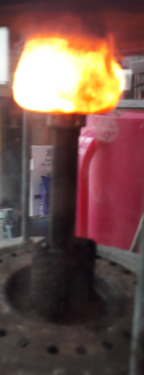

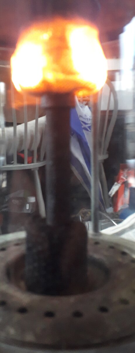

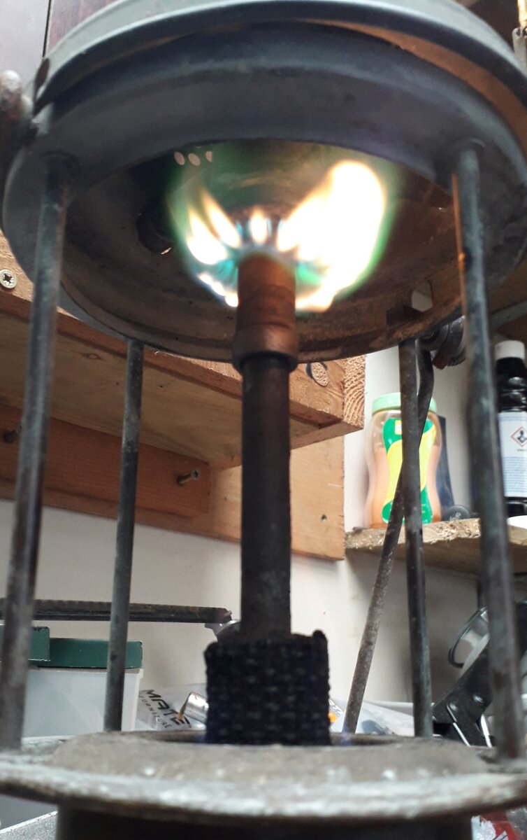

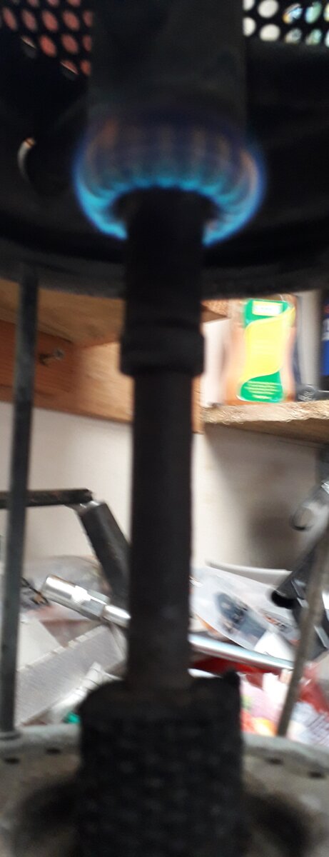

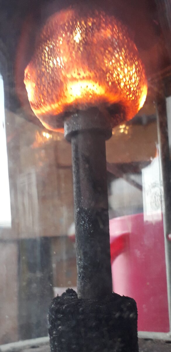

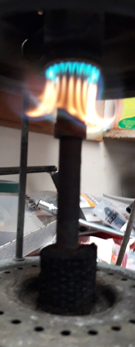

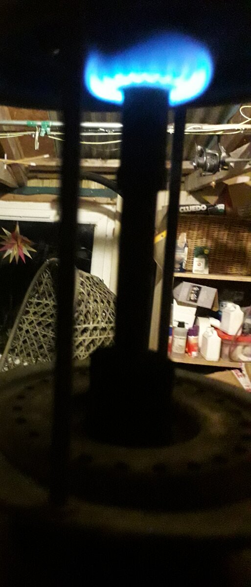

    @podbros, I've tried the burn test I probably put far too much Methalyated Spirit in the cup and wick!, I also think I pumped to much before she lit as you'll see I released some pressure a couple times but I did get nice blue flames, any good?:lol:

    An obstruction in one of the air vents, along with over pressure can result in a rich mixture, hence the yellow flames. Unfortunately if I were to nail my colours to the mast earlier I would say the vaporiser jet is enlarged and allowing too much fuel into the burner. If you had a spare hood / burner from another lamp you could switch them to help confirm either way.

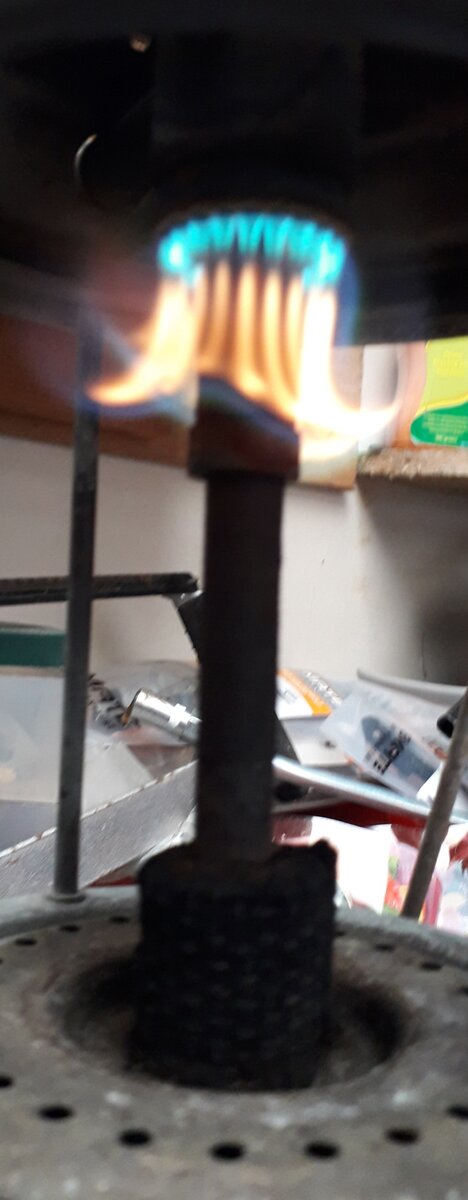

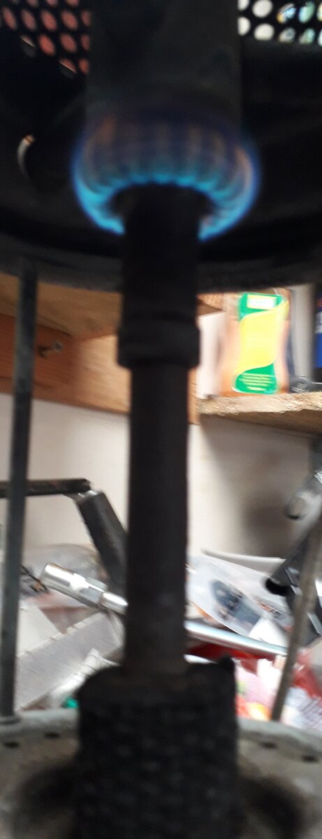

    @Gary Waller, as this my first Lamp I haven't got another lamp and I dont know of any locally I could borrow, I did hear a kind of light pop/thuwnk noise as the as the burner kicked into motion It must have been gunk stuck that I didn't get out, I did try the burn test again and this is what I got. Is there any fix at this point or will it run with a mantle albeit at a reduced capacity?

    Actually that last pic looks quite good, when you ‘click’ on it you can see all blue flames
  21. steerpike451
    Jun 29, 2016
    183
    Norfolk, UK.
    1: a pop as the vapour lights is normal.
    2: as Pod said, that flame shot actually looks pretty good.
    3: in the first photo with the yellow flames I can see that the hood is not fully down, which will affect the mix adversely .
    Try it with a mantle and see what happens!
  22. Balach Mor United Kingdom
    Feb 23, 2023
    32
    Isle of Skye
    @@steerpike451, The pop wasn't the vapour lightning it was more than it and only the first time so I think I did a poor job of clearing the burner but it seems clear now, You are right about the hood being up slightly it wouldn't catch alight when I pressurised it so I moved it up and it did catch but as you can see bad flames the 3rd photo is with the it down and with lower pressure, I think there might still be some remnants of dirt so that could be making it more orange because it is sparking ever so slightly from time to time, the last photo is also with lower light so it may look better than it actually is but I do think it slightly bluer than the 3rd picture. Cheers.
  23. Gary Waller
    Apr 3, 2018
    621
    That second shot looks much better, try a mantle on it.

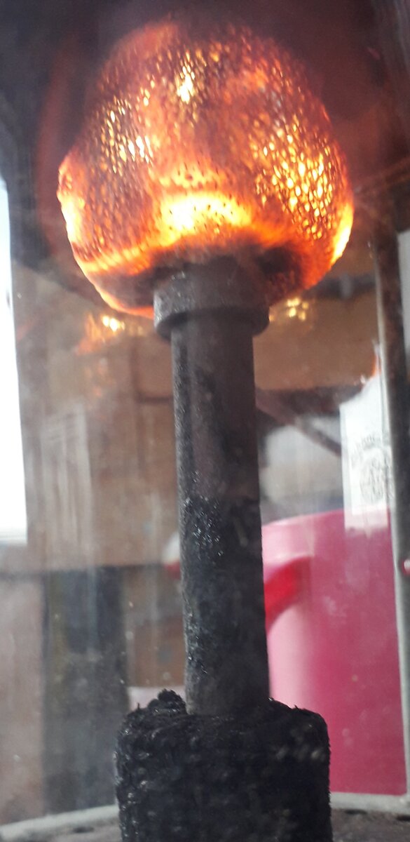

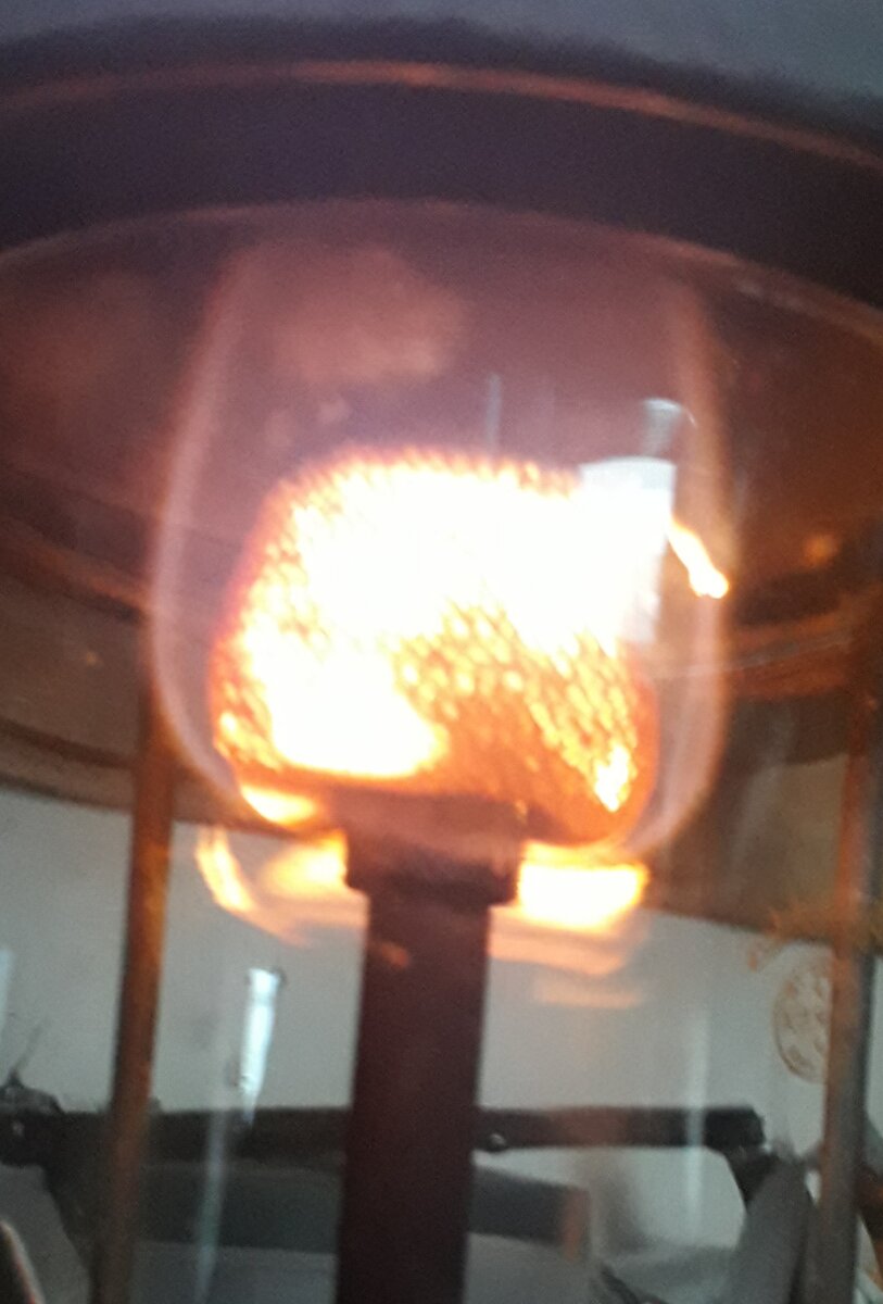

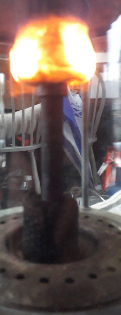

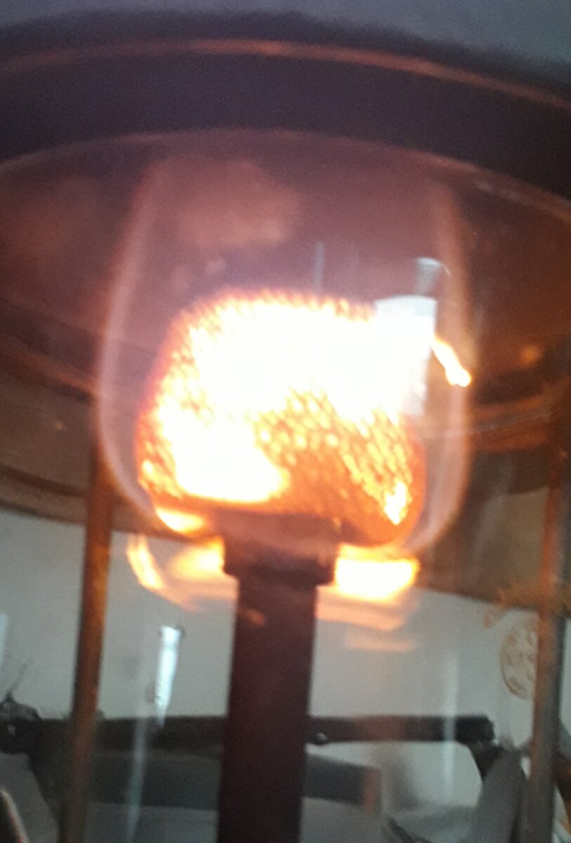

    Hello everyone I think it has failed the mantle, I don't think the mantle burned correctly it doesn't light up at all really just a couple spots like it should be, any fix?.

    How much pressure are you giving it ? - should be at least 40 pumps on a full tank.
  27. Balach Mor United Kingdom
    Feb 23, 2023
    32
    Isle of Skye
    @Fireexit1 I've tried again at 50 pumps, the tank isn't full it's about half full, it worked a bit better than last time but still poor should I fill it up fully?, but after I switched it off the mantle looks very blackened with only a few white spots remaining, cheers
  28. JEFF JOHNSON
    16,867
    The vapouriser's jet is enlarged, my advice is to get a new vapouriser.
  29. Fireexit1 United Kingdom
    3,536
    I think Jeff is right. You have fixed/cleaned everything else so all that is left is the vapouriser. Some searches here in this site will give advice on tips and tricks on reviving them, but this is not always sucessful.

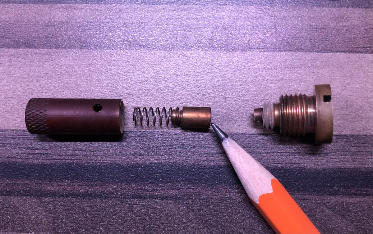

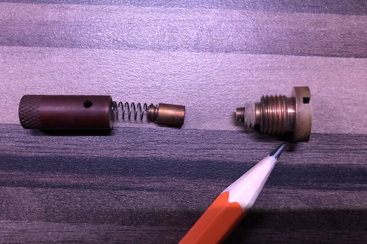

  30. Henry Plews
    3,066
    @Balach Mor Bialaddin and Tilley vapourisers are more or less the same so here's a little trick that's worth trying, after all, you've nothing to loose.
    Tilley X24B was fine, now not burning correctly = help please.
    I later edited that post,
    Check that the cleaning needle still shows through the jet, it should be a very close fit and a jewelers loup or good magnifying glass will help determine how effective the piening is. Keep dropping the vapouriser and checking with the magnifying glass until you're satisfied with the needle/ orifice clearance.
    Test the vapouriser in a lamp. If it still behaves the same, repeat the process but only drop it once before checking that the needle clears the jet.
    Incidently, the needle diameter is 0.007" / 0.18mm so the orifice is going to be in the region of 0.0072" / 0.18+?mm
    And from another post,
    I forgot to mention, save yourself money by not replacing the mantles unless they have holes. Any soot deposits will burn off once a correctly functioning vapouriser is fitted.
