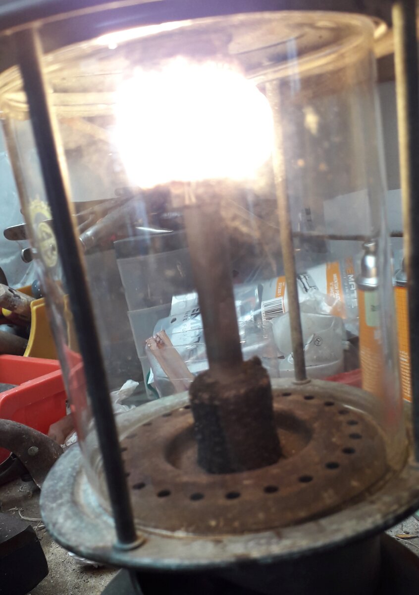

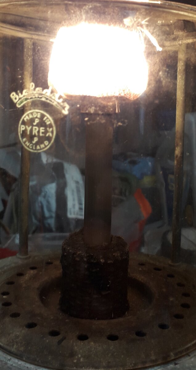

    Well Gentlemen, I reckon this is it, I had to replace the Vapouriser as even with attempting to revive it still didn't work correctly, The mantle cleaned up nicely after the proper operation, again thank you all, Ceud mile Taing!.
  2. Fireexit1 United Kingdom
    3,528
    Well it looks very fine now - vapourisers can be a bit of a "lucky dip" - I have had more good than bad ones :thumbup:
  3. ROBBO55
    4,394
    Congratulations :thumbup:
  4. podbros
    4,084
    Ah that looks better.. well done! :thumbup:
