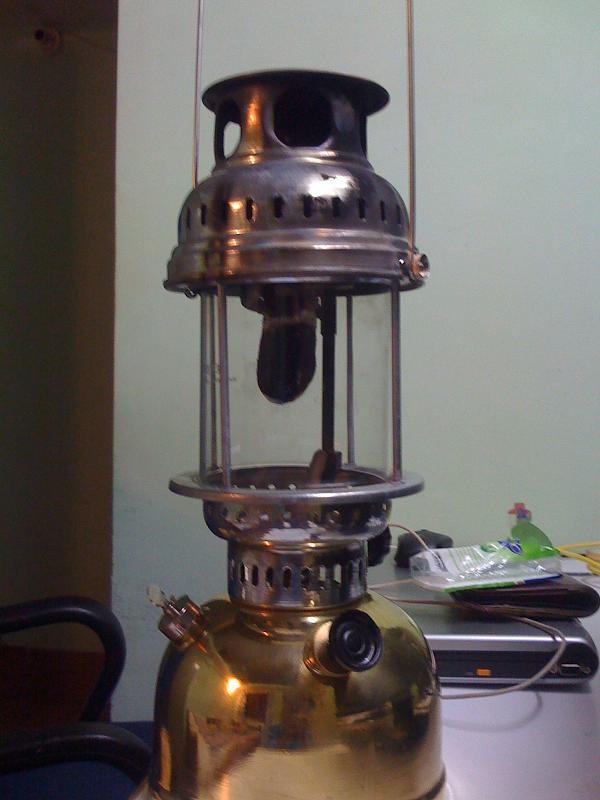

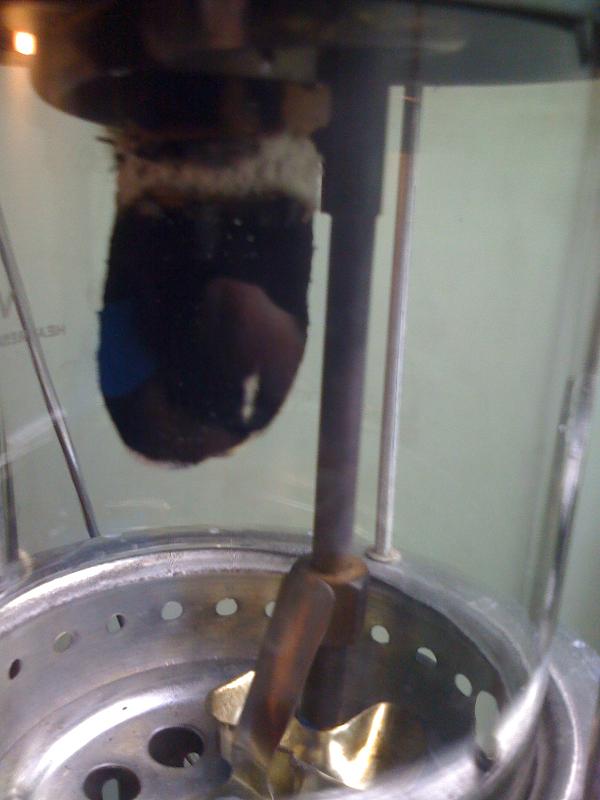

    So I totally dismantled the lantern, checked every part and put it all back with a new jet, checked pumping mechanism with water. The lantern and parts appears to be of quality make and build, and the pumping appears to be perfectly alright.
    Then, after a leak check with in a bucket of water, and drying out the insides completely, I filled up the kerosene, preheated with spirit and lighted. But the same problem as before occurs and this time I ended with a totally black mantle and an orange flame after an initially half bright mantle for about 2 minutes :( Pressure in tank seems OK. Not sure what else I can try.
    Like Christer mentioned, the lantern has a 350 CP jet and a 400/500CP mantle.
    The only thing I could not overhaul is the font (the "pipe") from the tank to the outside (..to the needling mechanism and generator/jet). This joint did not appear to be a threaded one, and looked like some special seal was holding it in place - a rubber gasket and a metal ring - tightly squeezed. I read somewhere that there is a 'vaporizer valve' at the font inlet inside the tank and that a malfunction of this valve can cause a blackened mantle. Does anyone here knows better on this matter? Why is there such a valve and what is its function? Is it there in all types of Pxs / is it a must? How do I replace it, since it is inside the tank?
    Here are some pics.

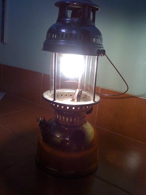

    Yay !! Finally I got the lantern to work :) Here is a pic. No black mantle.. just bright light :)
    I found the problem to be with the burner system - U tube - that was causing the blackened mantle. I bought another lantern of a different make which had had a more "advanced" burner with a more narrow "U" bend and a turbulator paddle inside.
    Next task, to fix the Cemax U tube and to find out why it causes black mantle.

  14. JEFF JOHNSON
