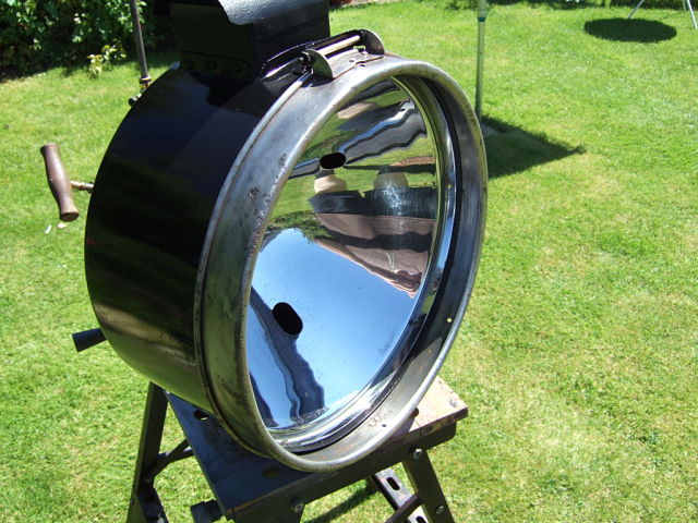

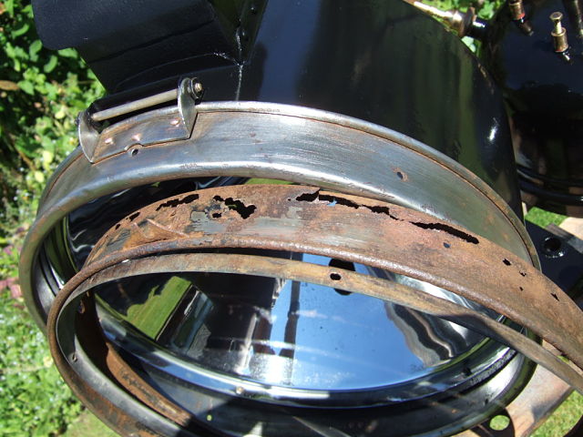

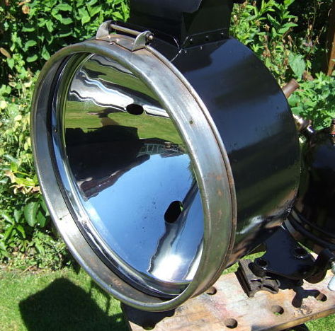

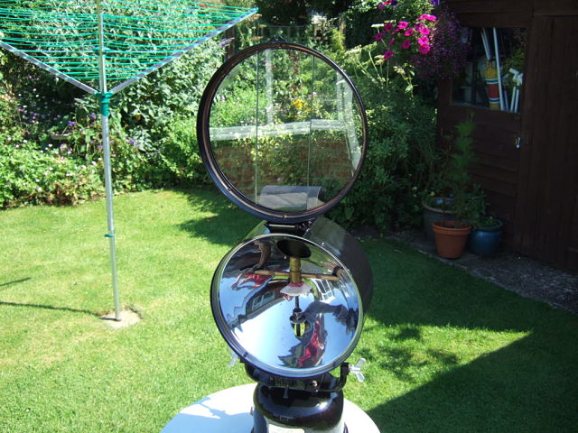

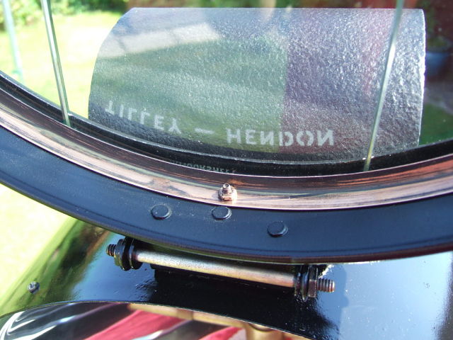

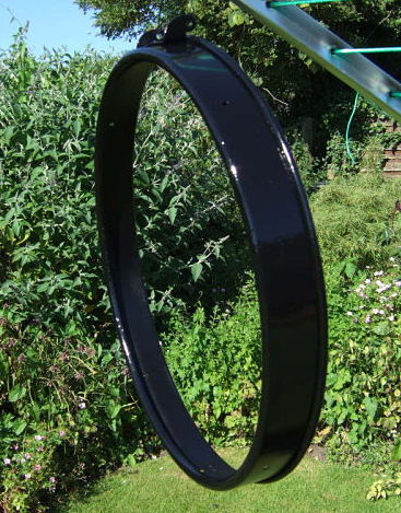

    This is known as "Heavy Fettling" one step away from light engineering :doh: :shock: :thumbup: or is it the other way round , who knows :doh: :D :thumbup:
    David shouksmith kindly sent a replacement lamp glass holder/rim to me ( as the original looked like an emmenthal cheese ) & it arrived this morning , so it was cleaned back to bare metal , primed & painted ready to be fitted tomorow after the paint has cured off 8) :thumbup:
    The inner glass support ring was cleaned up too :thumbup:
    Tomorow i will complete the build & maybe even fire the lamp up to complete the restoration :D :thumbup:
    Stu :D :thumbup:

    Hi stu it looks fantastic,the original glass holder rim was realy shot,and well done david for having a spare to complest this restoration,i am realy looking forward too seeing it fired up

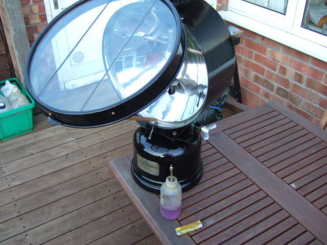

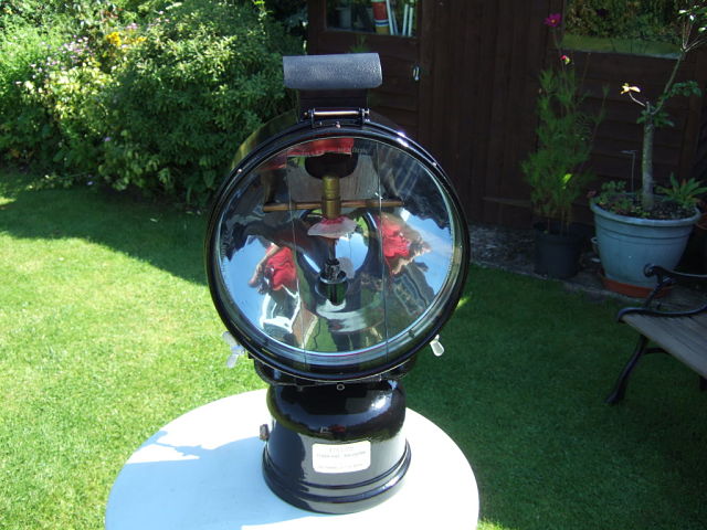

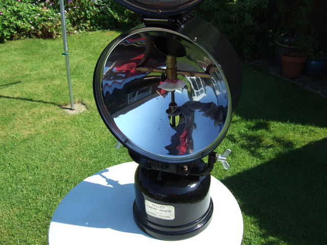

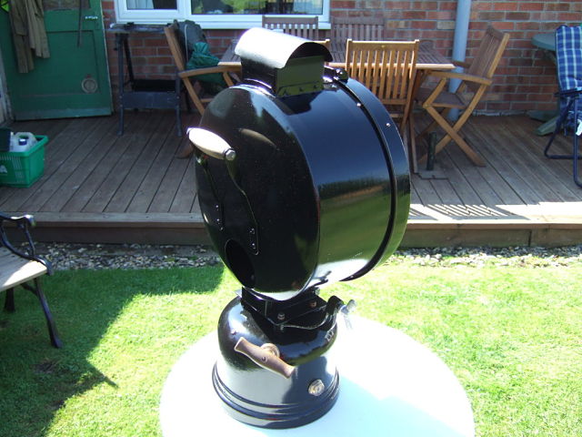

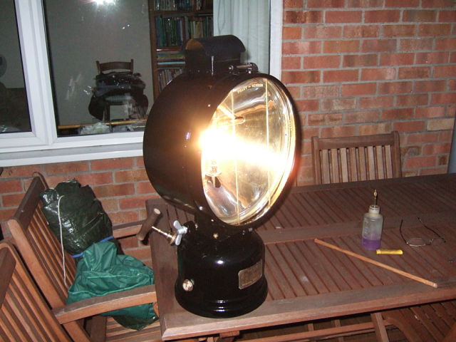

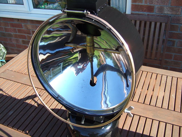

    Hi All
    Well it's all finished [-o< :D :thumbup:

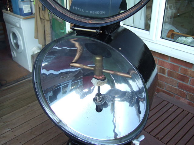

    The paint has cured off very well due to the really hot weather this week , so last night while sitting at the outside dining table i finished off putting the glass back into the frontispiece of the lamp 8) :thumbup:

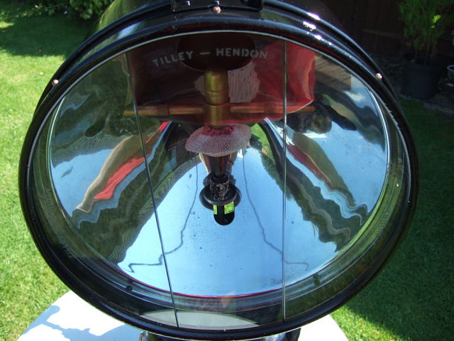

    Next i had to fiddle about with a mantle because the burner seems to be smaller than a Guardsman :doh: , so i had to re-tie one to get a good snug fit :D :thumbup: & thats it done , I can't quite believe it :shock: :D
    I hope youv'e enjoyed the restoration as much as i have doing it & thank you for the kind comments & encouragement :D :thumbup: , anything can be saved if you try & there are so many great people here at CPL & on CCS that will help you with good solid advice through their experience & even spares if they have them ( Thanks David ) :clap: :clap: 8) :thumbup: .

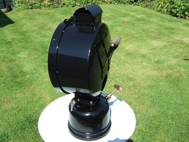

    I give you 1938-40 Tilley FL-6 :D :thumbup:

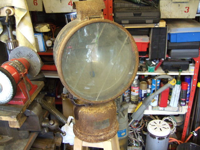

    From this [-o< :shock: :thumbup:
    To this :shock: :D/ :D/ :D :thumbup:
    Best regards Stu :D
    PS will take some pic's later when it's dark to finish off the post 8) :thumbup:

    What a great restoration congrats Graham.
  7. David Shouksmith
    Yes, it is - physically smaller and only 250cp (IIRC) as opposed to 300cp (both Tilley's claimed figures :roll: ).
    The correct mantle is a No. 191, but if you've got the larger one to fit snugly then it should work OK.
    You're welcome to the front rim - just let's see the lamp fired up later on... :thumbup:

    Wonderful job Stu :clap: :clap: :clap: . Very nice lamp once again. :thumbup: You never fail to amaze me with your fettling skills - Steve.
  9. mr optimus
    367
    Well done Stu totaly amazing restoration work,the difference in the before and after pics are unbeleivable,you should be realy proud of your work on this restoration :clap: :clap: :clap: :clap:

    Awesome job Stu. Thank you for the lessons and for seeing that this one could be saved. =P~ :D/

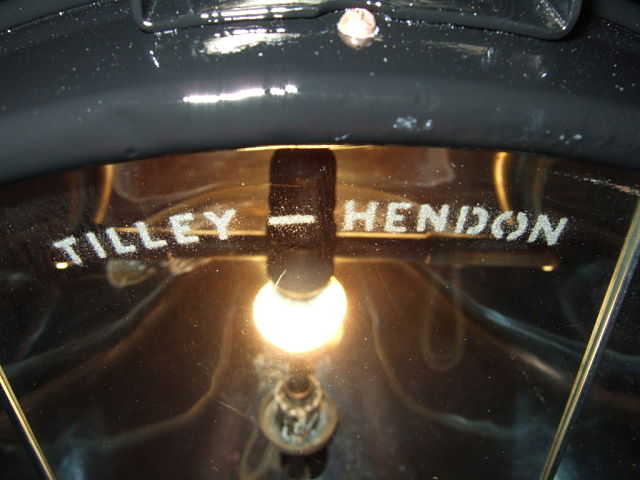

    P.S could I trouble you to take a couple of photos of the decal... That's all my FL6 resto needs before its completed!
    F.A.B :lol:

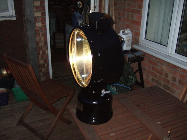

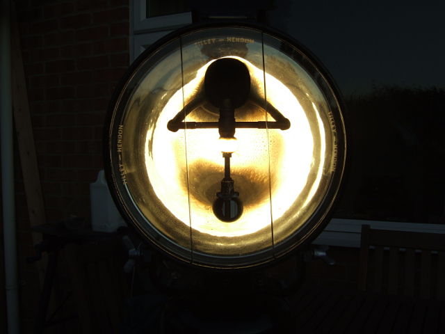

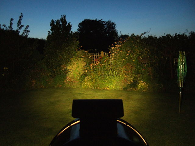

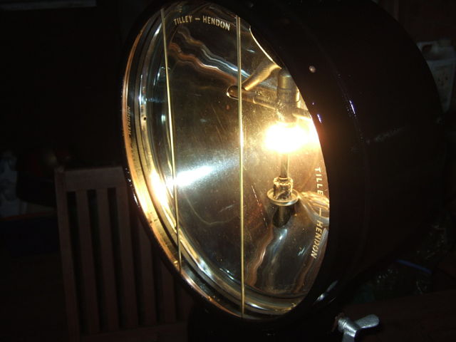

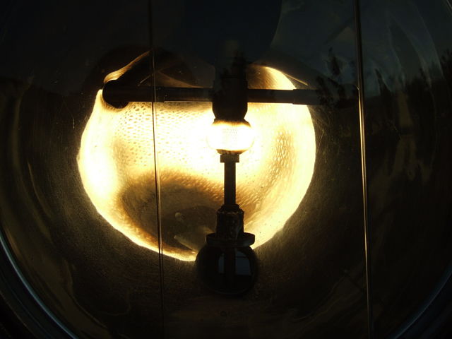

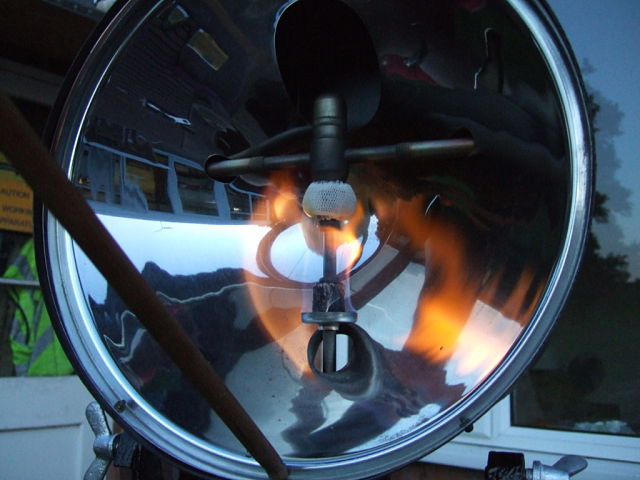

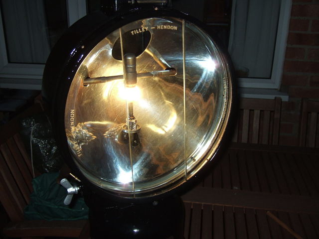

    Well it's getting dark outside so i suppose i'd better get off my bum & get this lamp lit :D :thumbup:
    Before i bought the FL it had been languishing in a workshop near Boston lincs for over 20 years :shock: :cry: :doh: where the previous owner had been meaning to restore it himself , but never got the chance due to re-building french two seater light aeroplanes :roll: :D :thumbup:
    He said the previous owner had not had it working either & he'd had it ten years :shock: :doh: , so would it light up [-o< :D :thumbup:
    The vapouriser is the original brass bottomed one that was on the lamp when i got it so here goes nothing [-o< [-o< [-o<
    Paraffin in :!: & pre burning off the mantle :thumbup: , i fitted one of my homemade Bialaddin priming cups to make life easier :D
    Good grief it works :shock: :shock: :D :thumbup: & really well too 8) :thumbup: , now thats very satisfying :D/ :D/ :D/ :thumbup:
    Look out "arty shots"
    The lamp is only 250 CP but the brightness it provides even in this summer half light is impressive 8) 8) :thumbup:
    Thanks to all who kept me company on this little adventure 8) :D :thumbup:

    Looks like it is working very well Stu. I think you need to post one of you mantle shots in my gallery of errr... mantle shots :lol: . It's crying out for a flood lamp and your one is the only one lit. Well done once again, best regards Matt.
